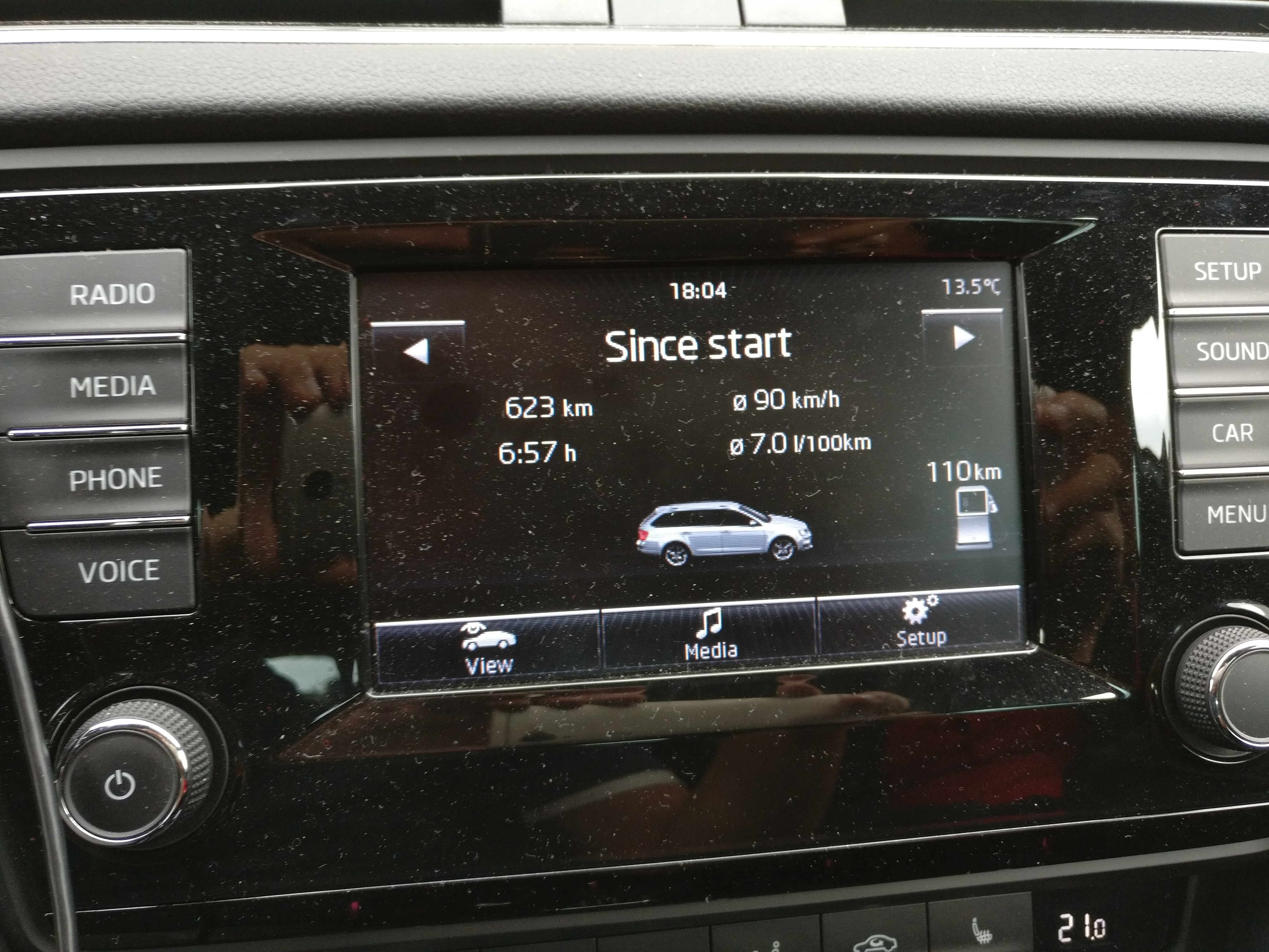

Here you can see my Bolero, which is fitted on a car manufactured in 04/2015 for the Finnish market:
