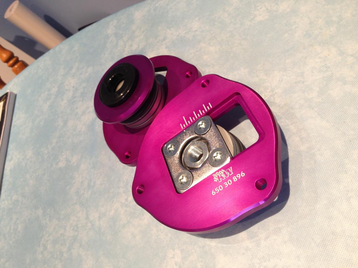

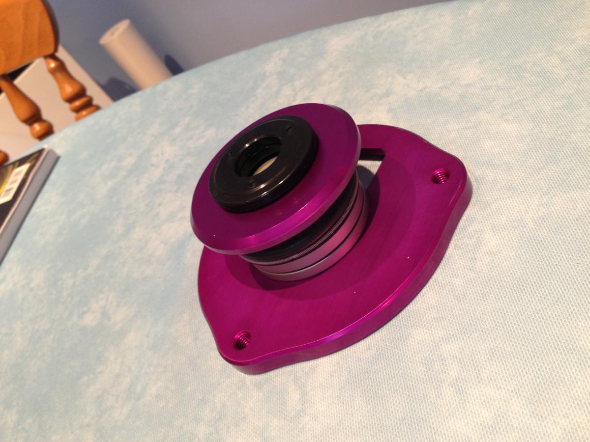

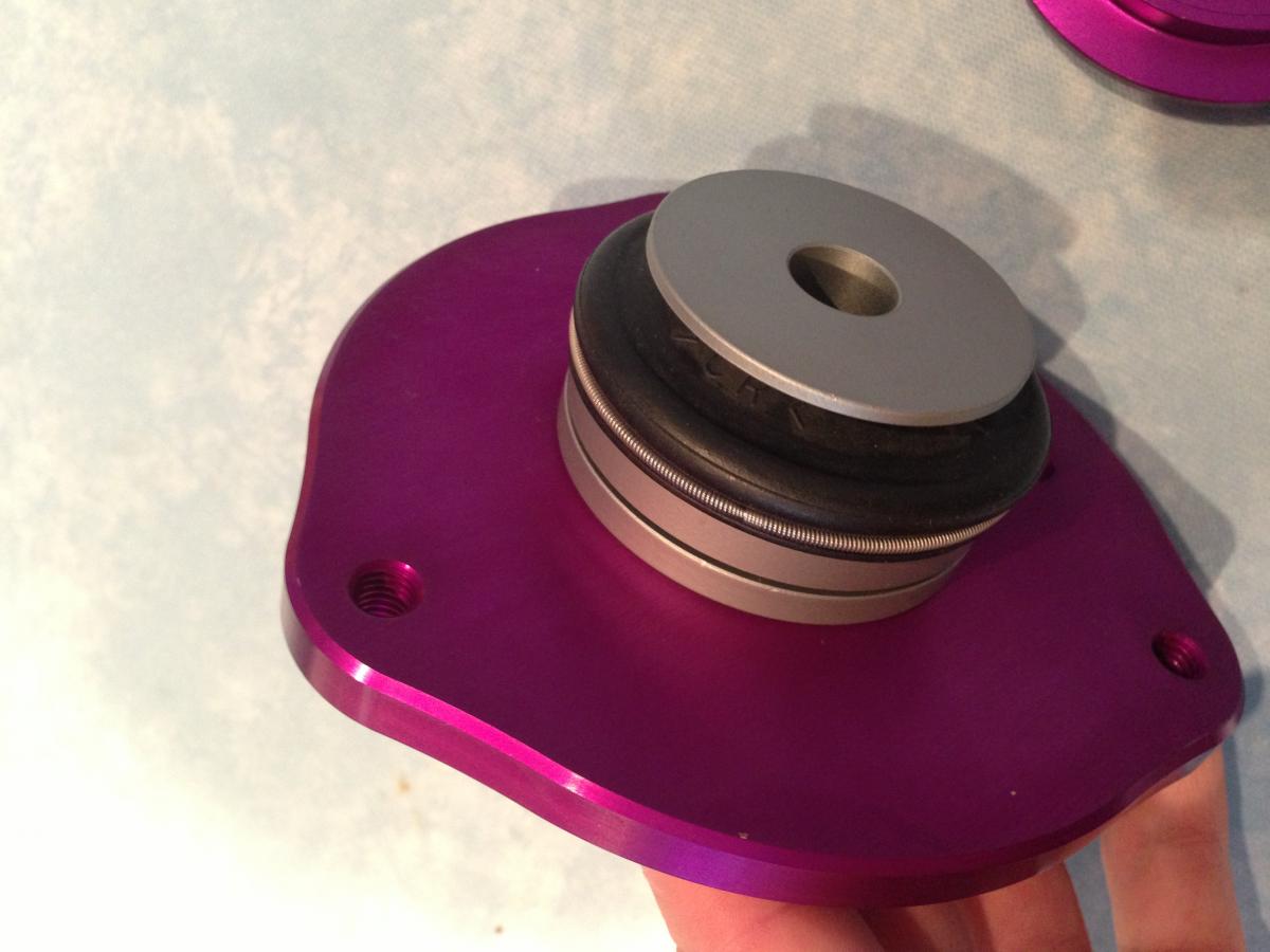

Here they are guys, they look like they'll do the trick, however they wont give me much in the sense of positive camber... :( Plus my insurers won't cover me for such a modification as it is deemed to risky to get better braking, better economy and decreased tyre wear :p
So I'll be sending them back this week as there's not much point in me voiding my insurance whilst I'm in the middle of France.

They look nice. Shame you can't use them :(
has anyone actually got these fitted then? im looking to put some positive camber back onto my wheels, just doesn't look right now its lowered, pros and cons to everything I guess.
whats the range of adjustment you get with these?
