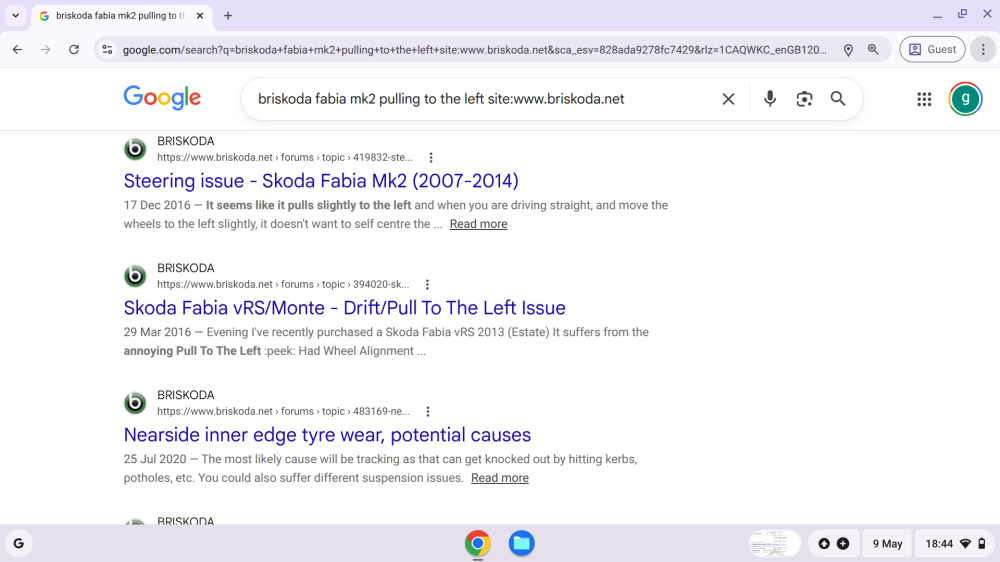

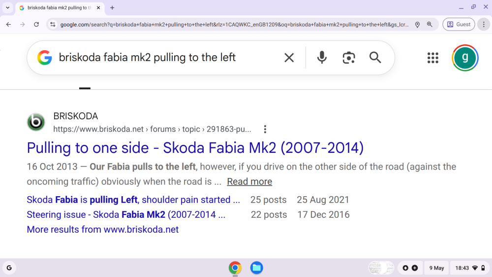

The Posts are here from 2010 on about 'Pulling to the left', that was from cars being new. If people went on long enough at Skoda and after Dealerships never fixing the issue they got the Continental or Dunlop tyres replace for Pirelli. That disguised the issue. Actually the issue was often the tyres fitted wrongly for the 'Run out stripes'. But actually in the main it was the alignment of the front from the factory of Right Hand Drive cars for the UK. There were less complaining of Left hand drive cars 'Pulling to the eight'. Sorry no help to you with a 15 year old car, but it maybe never ever did get sorted. Sent to an Audi Garage where the Techs & Fitters maybe paid more attention.
