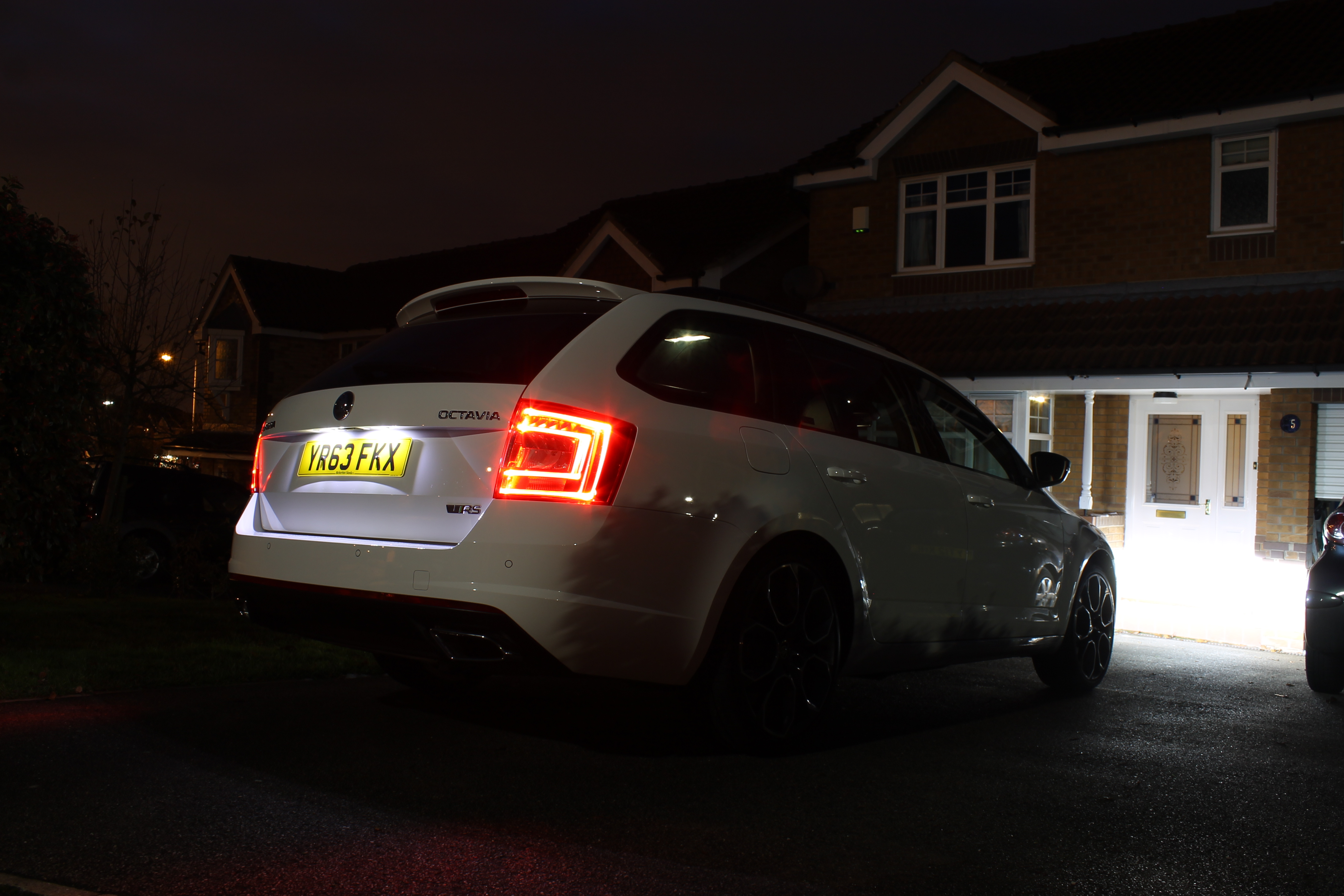

Found a photo from 4 Years ago when I fitted them
looks neat!
