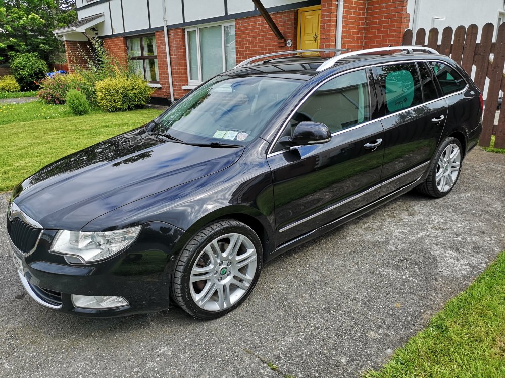

What does everyone think to these VRS Grill stripes? I haven't actually done it, these are photoshopped, but I saw a kit of vinlyl tapes on eBay for £6 and thought I might add them to brighten up the old girl (or old grill!).
I'm about 70:30 in favour of doing it at the moment.
I don't think I'll get a VRS badge.

On a Superb??????????...............Why would you?:thumbdown:Leave it in the photobooth.:movie:
I definitely wouldn't do that on A Superb. You've got a classy cruiser in a classy colour there - don't mess it up.

Ha ha, I like that, Robin. A classy cruiser! I'll keep it that way.

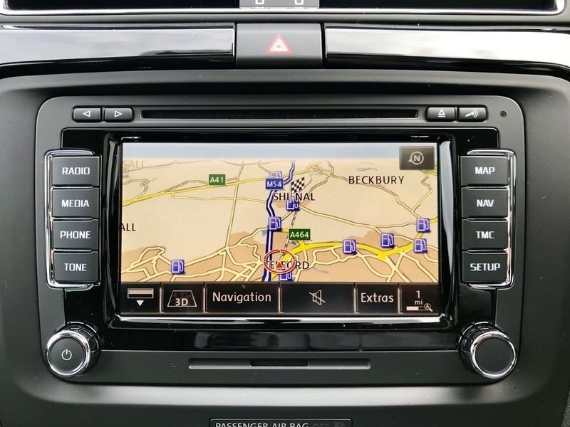

Is this Columbus infotainment system in the car?
Yeah will be in the L & K biggest screen available back then in 2013/2014 facelift.:thumbup:Think it was 6.5 inches.

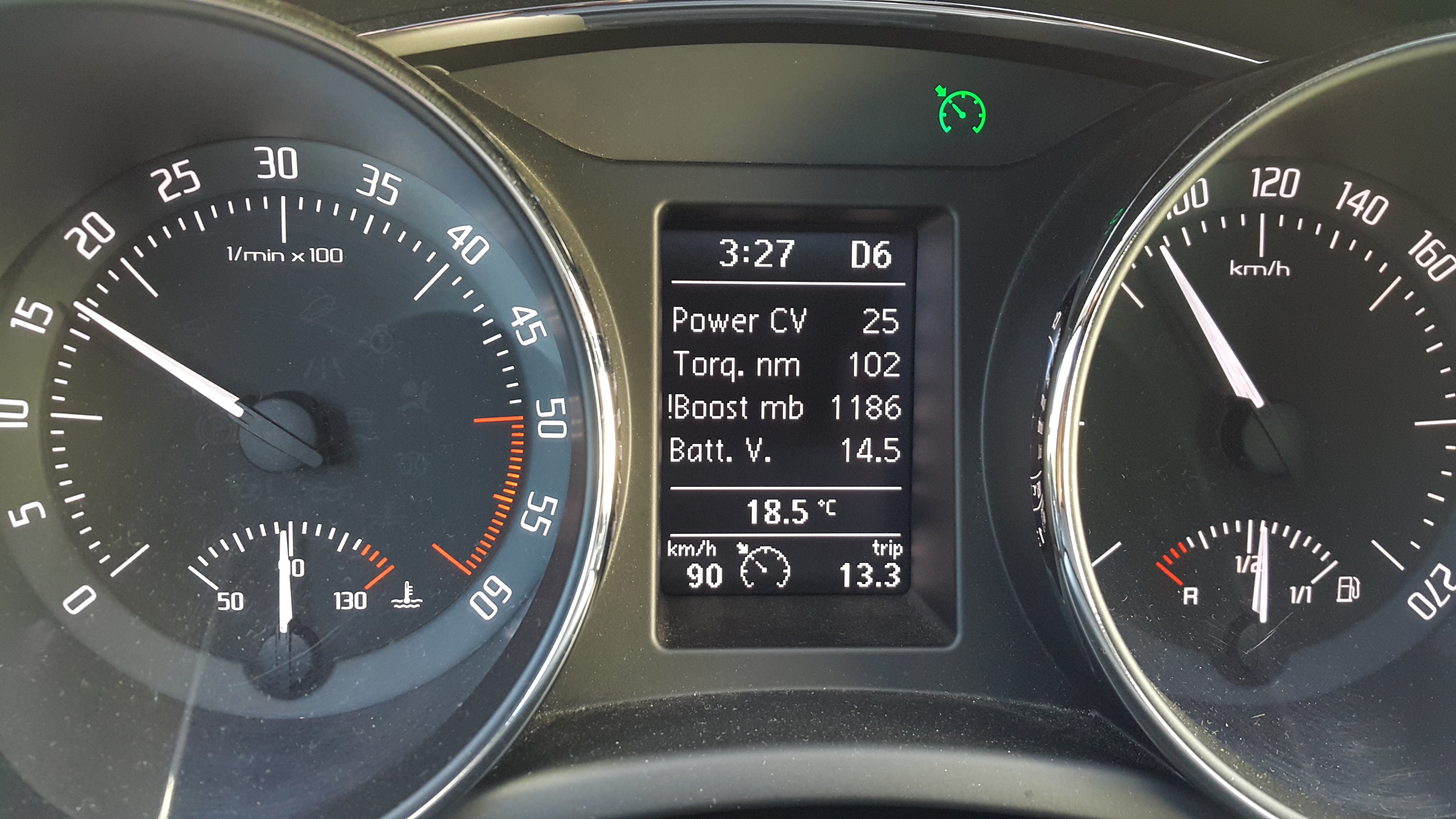

Mhhh, nice display, how do you manage to have this ?
Is it the Polar FIS+ ?
I have heard from a German colleague who owns an Octavia that he decided not to install it because he was told it would make noise / instabilities on the OBD
Any feedback ?
To " @LBLJ " - It is the "Polar FIS", Yes. I have it from about 500 Kilometers and I do not see any Problems at all.

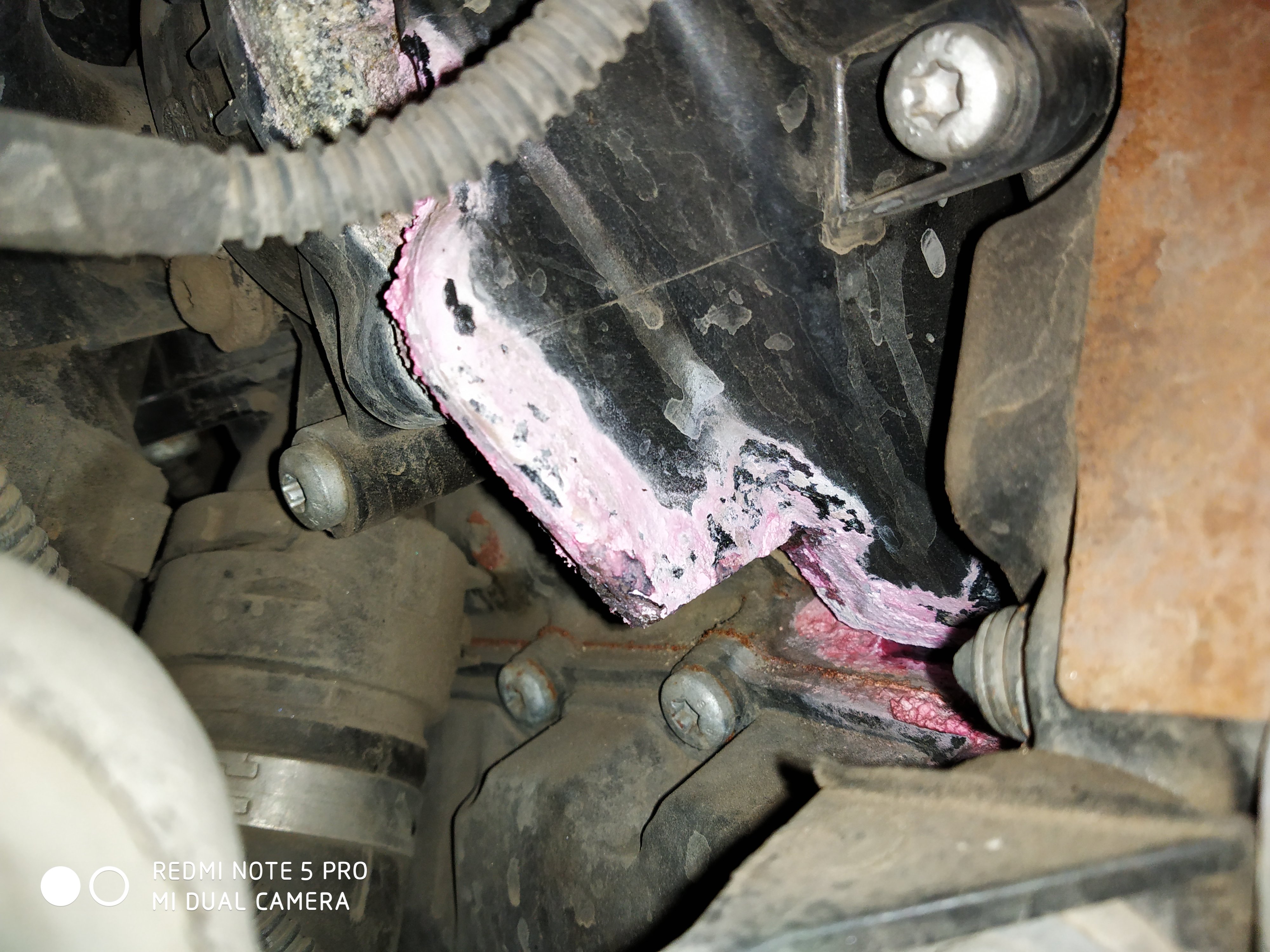

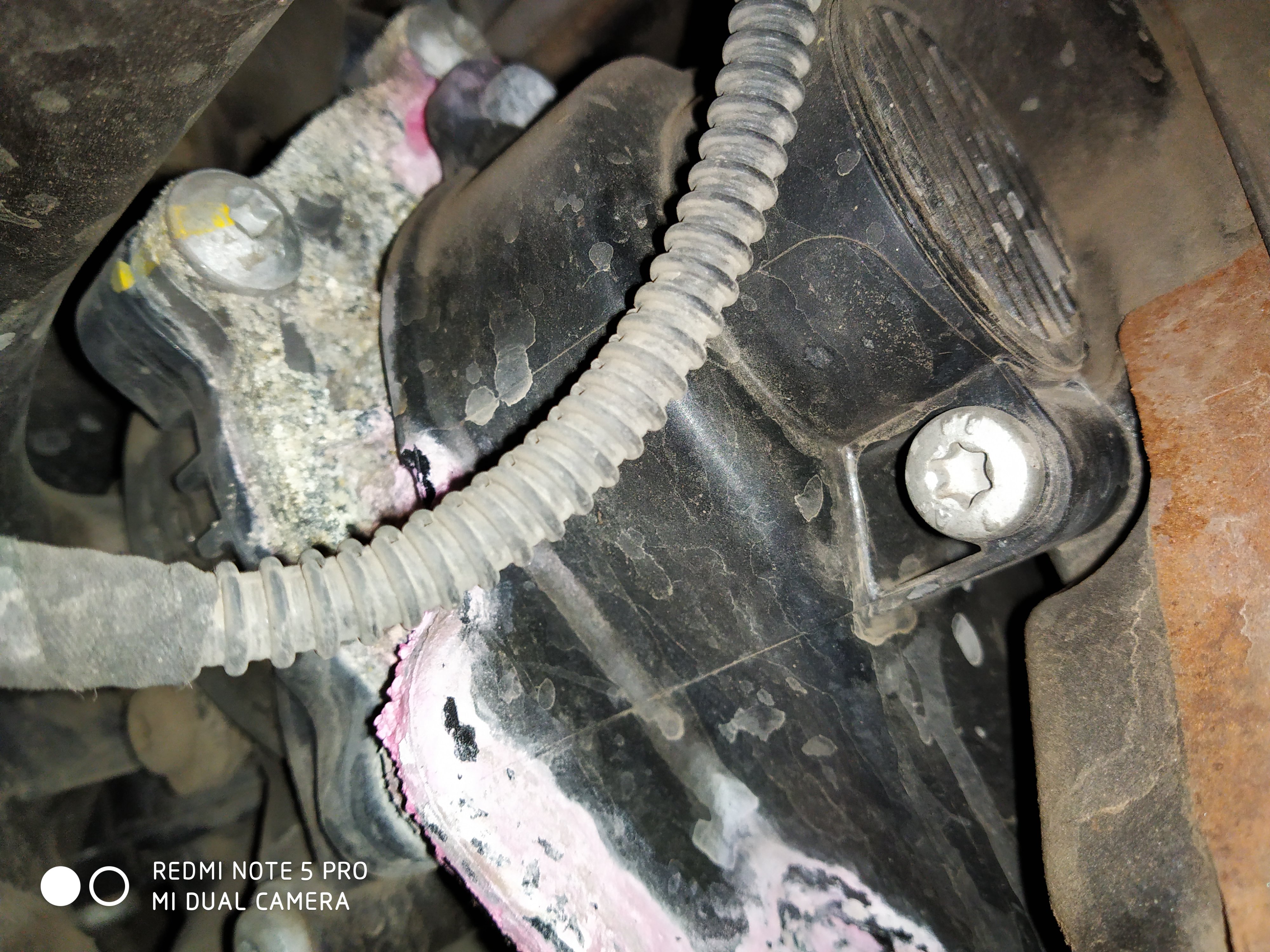

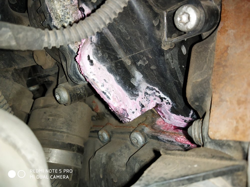

I own a 2012 Skoda Superb 1.8 TSI MT. It has done 71000kms . My coolant light was blinking on the odo so i topped up the coolant and it was gone but after a week it came on again and as i checked the water pump i saw that coolant has leaked and solidified all over the water pump and the belt cover. Is this a 100% water pump failure or some seals are broken?? Kindly help.IMG_20191125_215351.thumb.jpg.876a71093064e3f19f5a0258864a59ee.jpgIMG_20191125_215348.thumb.jpg.49ff1b74fa06cef654f1c65609f8b302.jpg

Its  a common problem on 1.8 tsi engines, water pump tends to leak at relatively low mileage. Get it replaced with a new one and also change the timing belt, and you are good for next 150kkm.

Heyy Mcturck thanks a lott for your reply..
Is it necessary to change the timing belt too??What if i don't get it replaced now as i am not facing any problem regarding it?? Will there be any problem??

Its recomended that you do, there wont be any problems if you dont, but you alredy have to remove the old belt to change the pump, and the belt isnt that expensive, so you might change that while you are at it, so you dont pay twice for the same job.
Oh and and I ment serpentine belt, your engine has a timing chain and not timing belt, sorry for mesleading you.
