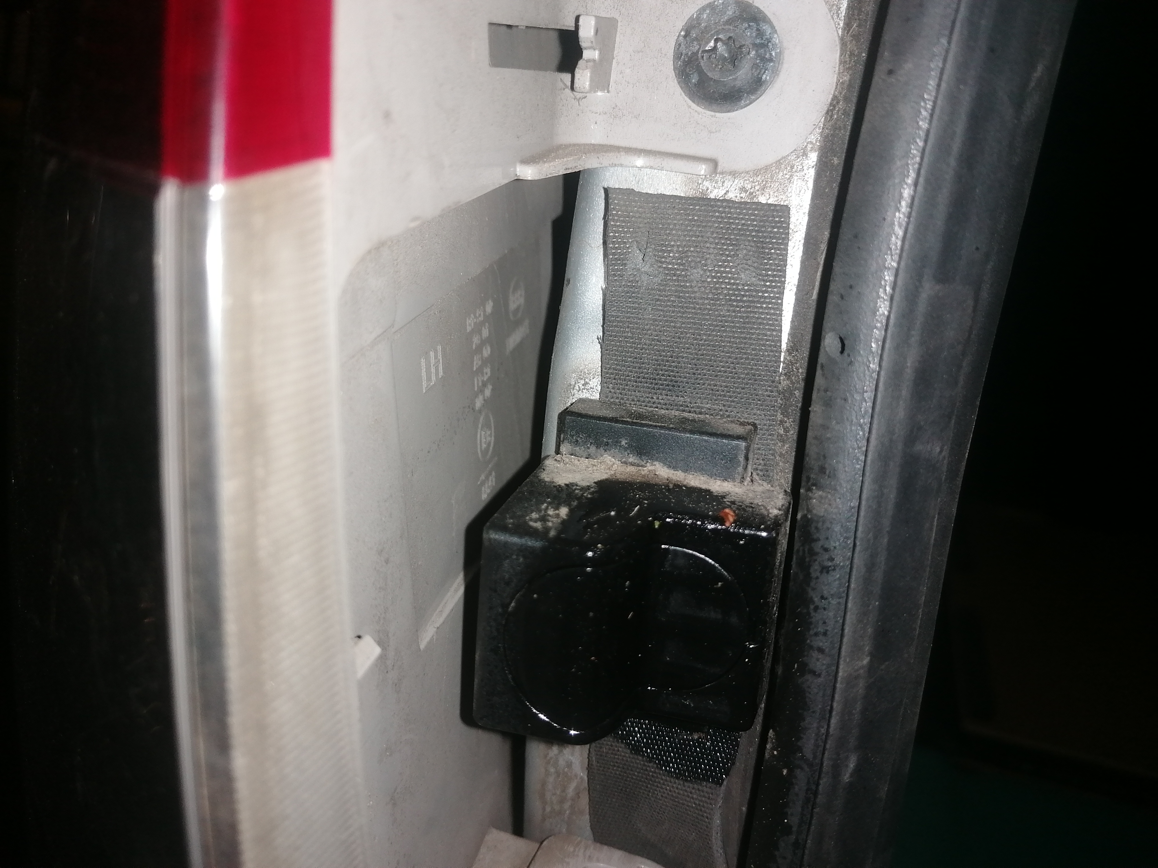

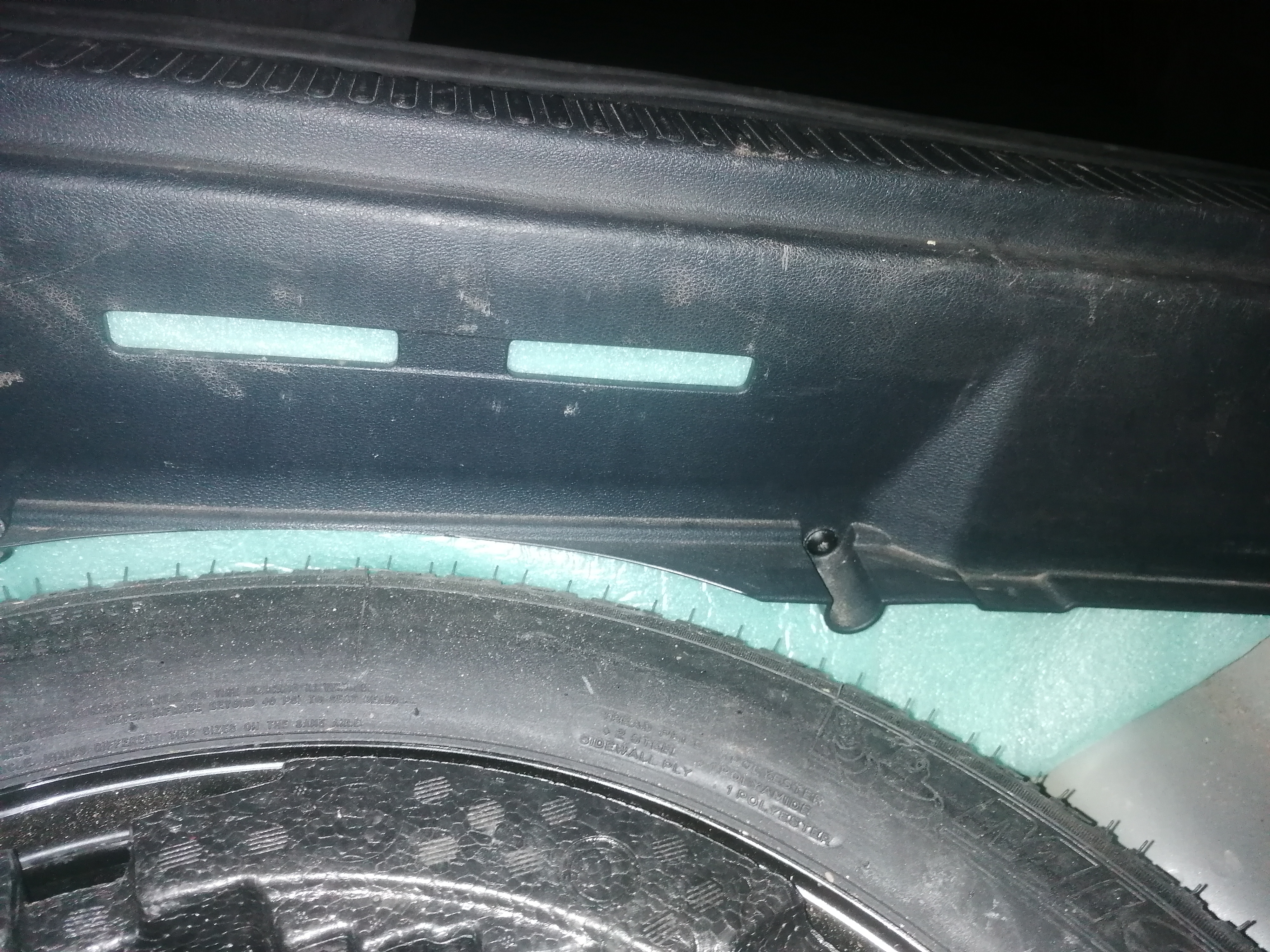

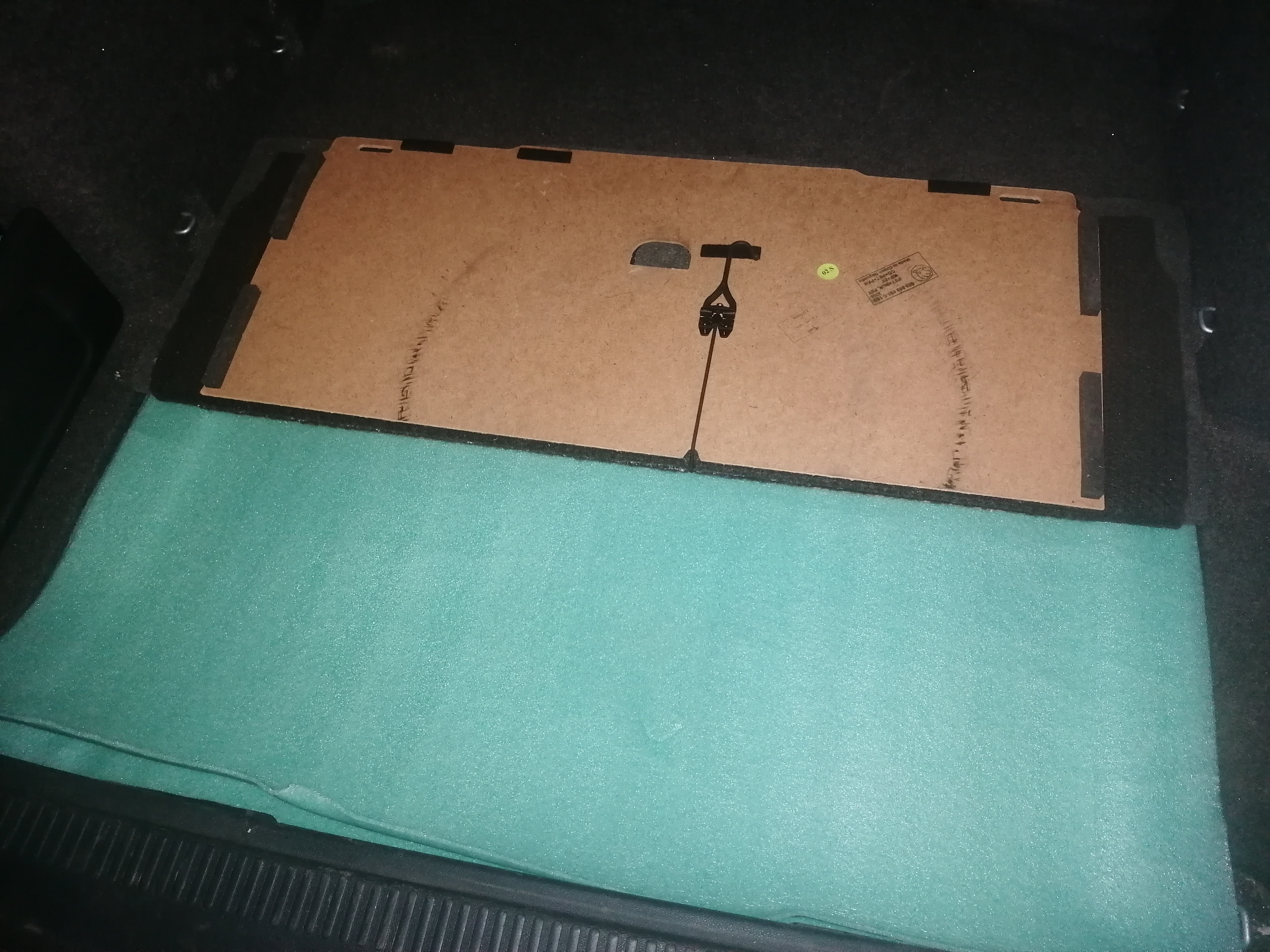

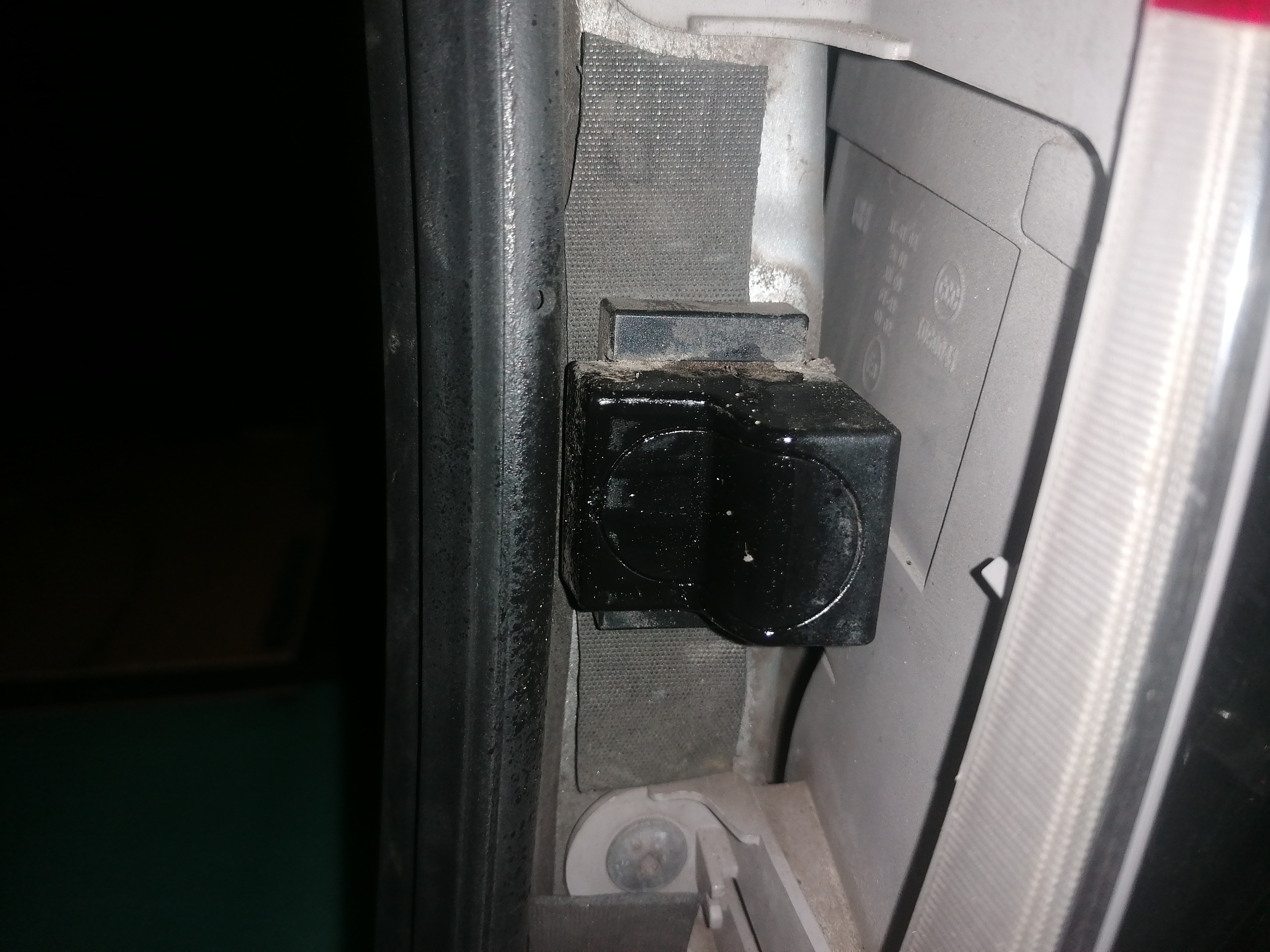

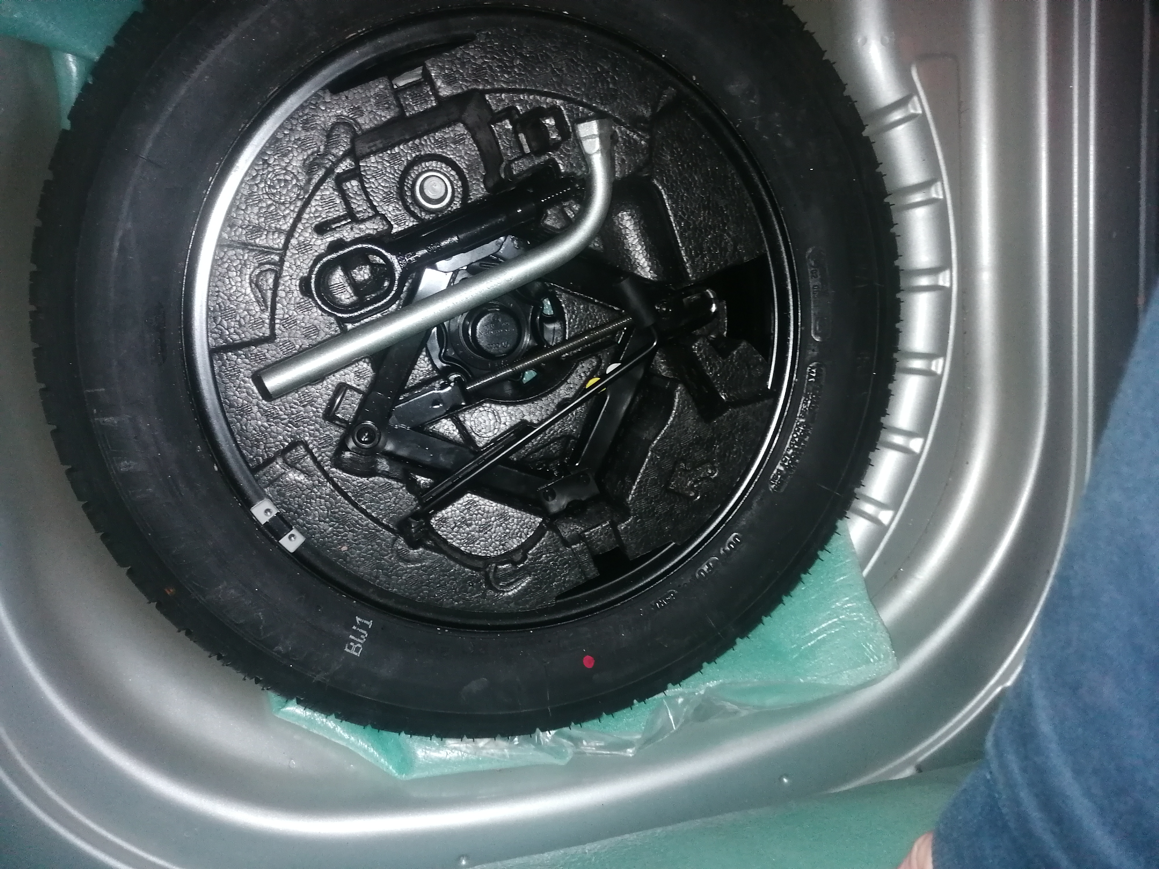

Pics as promised
So youve covered over the spare wheel i see- if i did this on my hatch the carpet cover wouldnt fit but thanks for showing us. The booming noise i had has gone doing the things i did along with most of the droning which these cars suffer from over certain rough road surfaces hence fitting the dampers on the rear beam which i did too. Have you driven your car over a rough country road yet to see if youve got rid of the droning??
Yes I took the car out on a variety of road surfaces for around half an hour. Sound was as normal at all times. Previously the booming noise was there driving above 20mph at all times. I was keen on supplying some pics as I hadn’t actually seen any fixes for the rear boot stops for the estate only the hatch.
