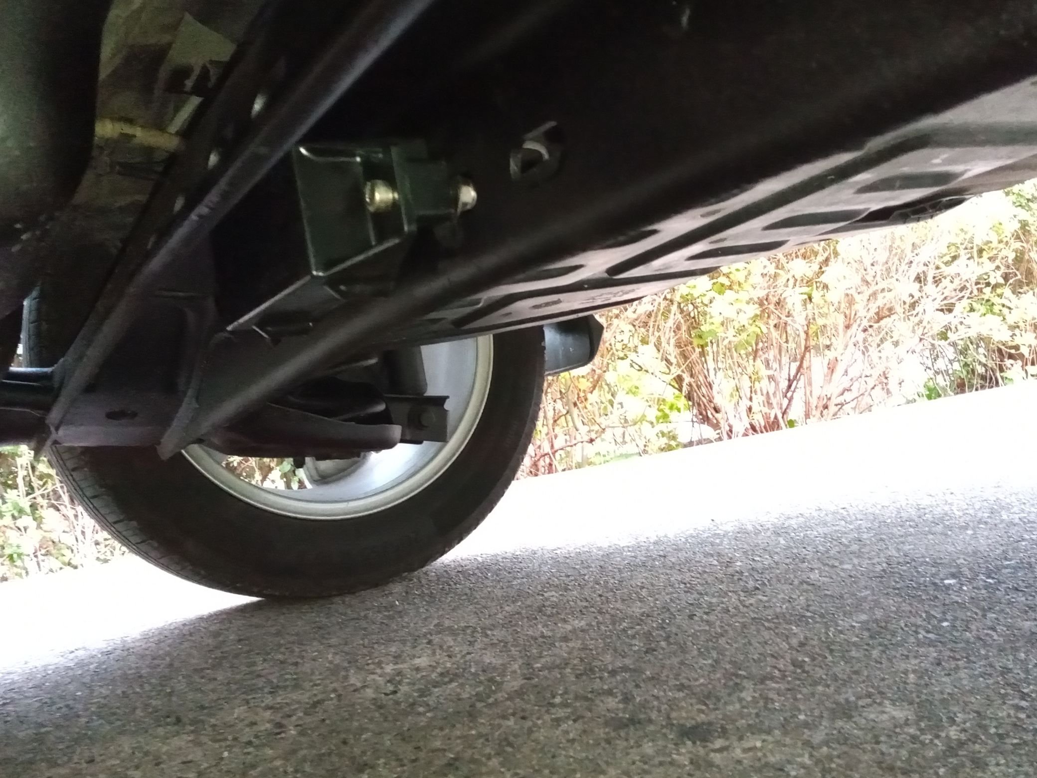

Well after fitting a Volvo harmonic damper to my axle beam, fitting silent sound deadening pads to the spare  wheel well and under the back seat, squirting some foam into the front drivers side A pillar( too cold now in UK to go further with this) also replacing the tailgate stops for the new heavily sprung stops, putting some sound proofing felt under back seat and in the foot well, fitting a spare wheel and tool kit plus a full set of the rubber Skoda mats interior and boot area, fitting the full size engine tray and the middle large undershield I can say that my car is much better than it was when I first got it a month ago. I haven't finished with these modifications as I need to change front tyres for Goodyear all season ones, order more dampers, squirt more foam next year in warm weather and add more sound insulation under the front carpets, fitting sound deadening pads to the rear wheel arches after taking out the carpet - then I will have done as much as is possible to make the car more pleasant to be in when driving- it's a lot of work but I've seen be benefits on every single upgrade - the best two so far were the foam and the Volvo damper.
Michael

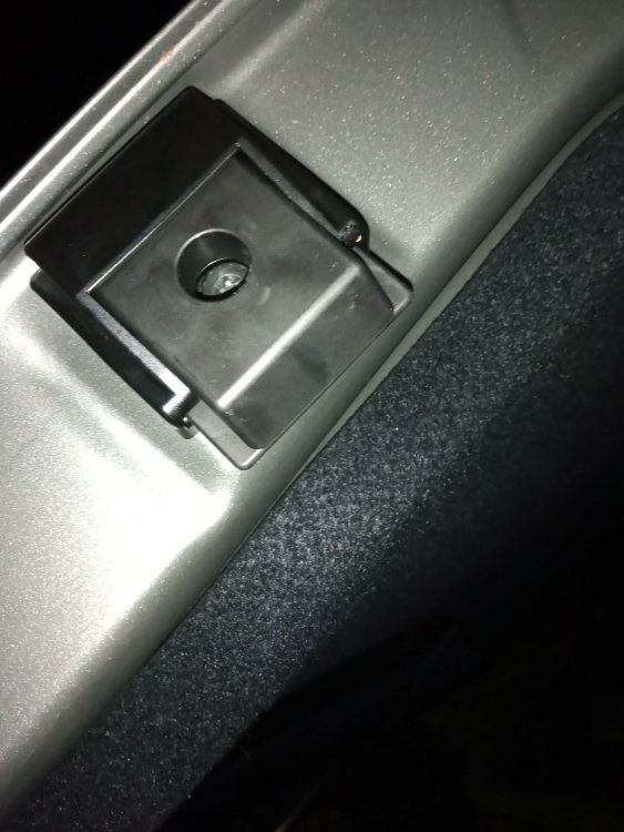

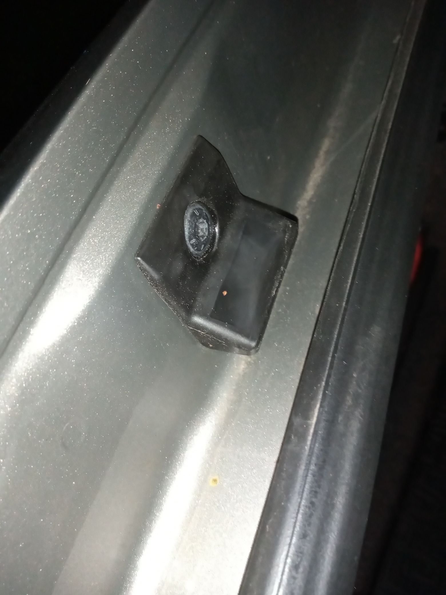

Michael
Hi Michael
I have done most of the work you have done, and it's also getting better. Could you post a picture of the Volvo dampers in situ and also the tailgate stops?
Best Regards Thomas
