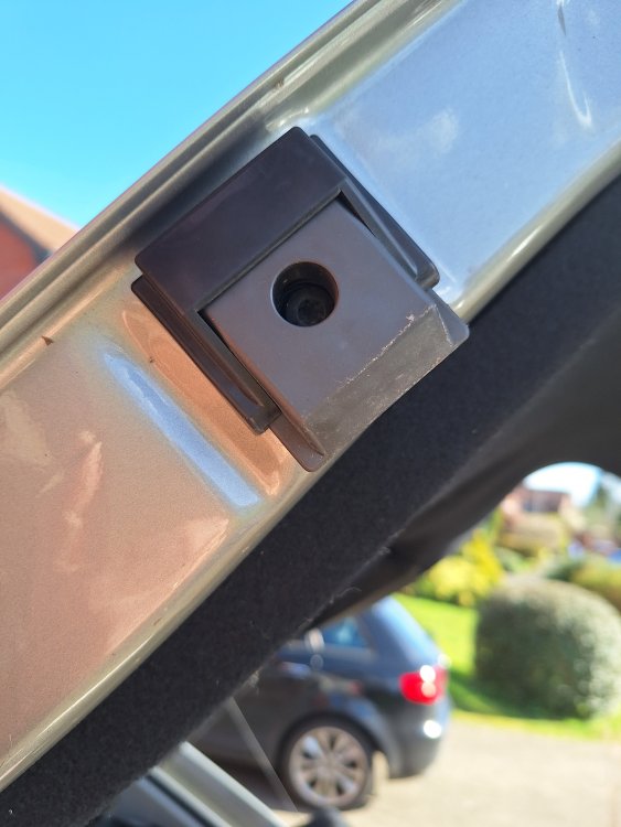

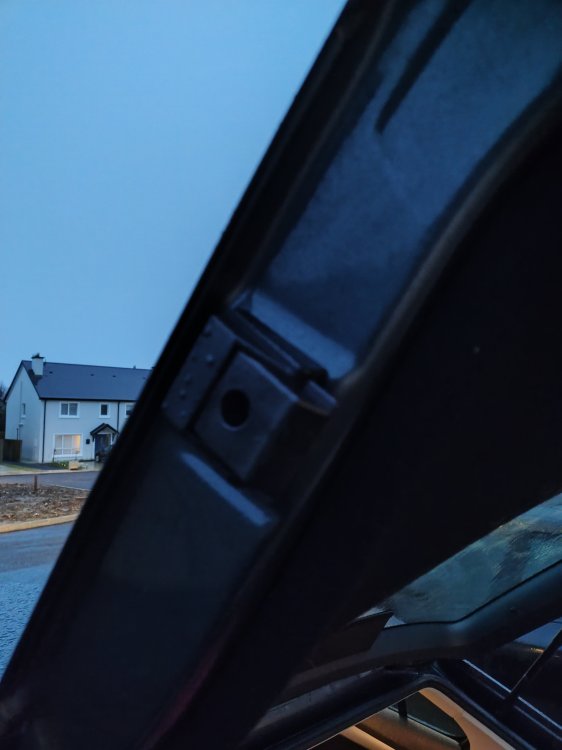

  • My VRS 230 hatch (demo 900 miles on the clock) exhibited the booming / pressure in the cabin on the pre-purchase test drive. The dealer acknowledged the issue and gave me written confirmation they wo
  • Have you tried adjusting the striker plate as well? In my case the buffer adjustments did not solve the booming issue, I had to adjust the striker plate as well. My boot lid closed too easily ie. wi

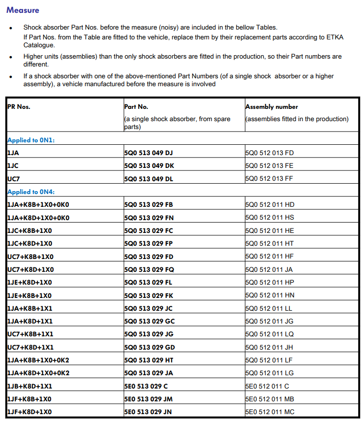

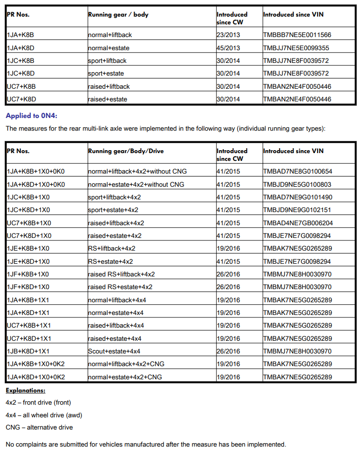

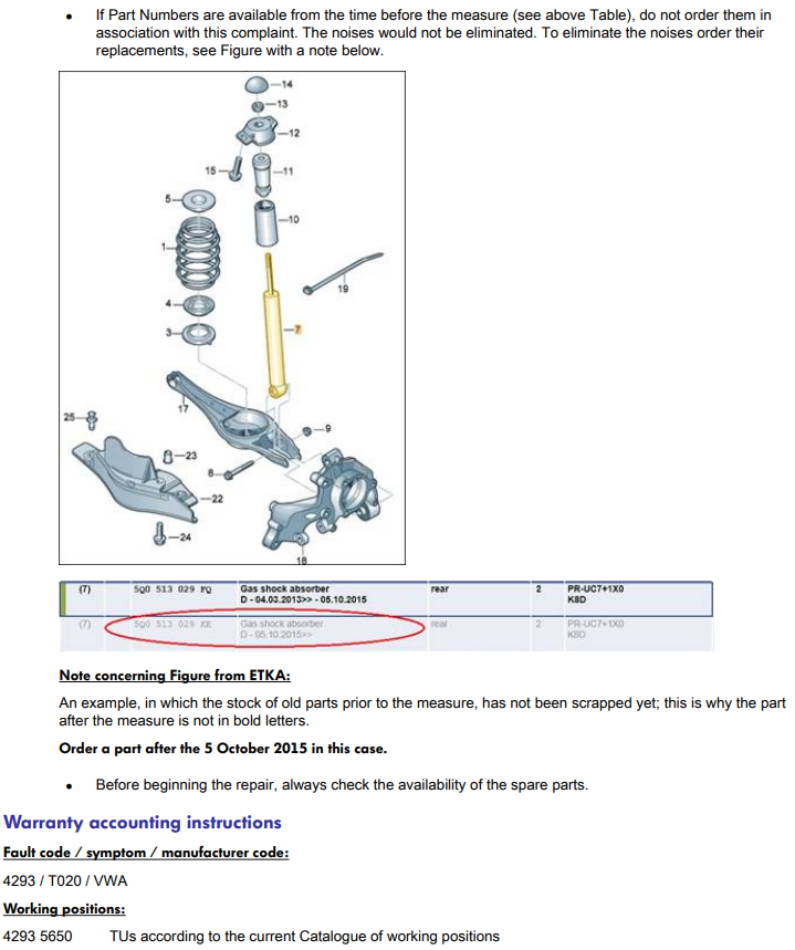

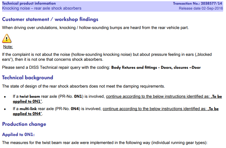

I have reduced the noise but not completely eliminated it. I have posted some time ago regarding what I have done which you will find if you do a search. My next improvement will be replacing the original Sachs oil filled shock absorbers front and rear for Bilstein gas shocks next spring- current front ones have slight weap which was advisory on mot just recently so need replacing.

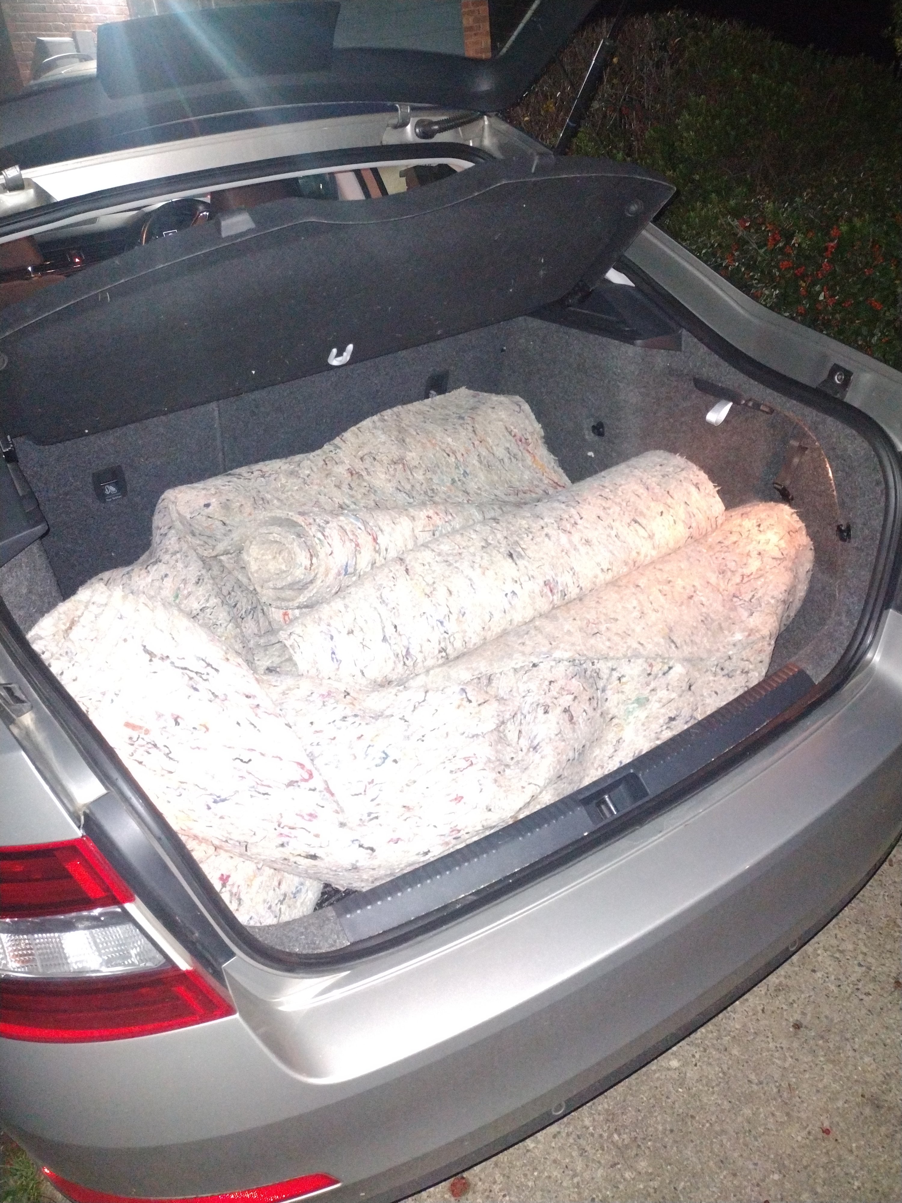

I am currently testing a new solution to the noise produced by these cars- see photo attached
What's the plan lol?
I was going to throw these rolls of jute in the tip but thought I would see if I could have a quiet drive this winter instead by leaving them in the boot lol
Did it work lol?
Nope 😂
But you cant say I didnt try!

I believe Sachs shocks are oil filled and Bilstein are gas filled - correct me if I am wrong?
OK. There is no such thing as a "gas filled damper" in terms of working fluid. What there actually are are "gas pressurised dampers" where you get a sealed volume of pressurised gas above the damper oil that is the working fluid. This design gives increased resistance to aeration of the oil working fluid, and hence to damper fade.
Thank you Ken for clearly explaining the composition of dampers.

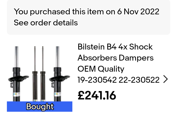

Came across this thread by chance and so glad I did! I have had my 64 plate TDI VRS hatch for just over 2 years and the boom was so bad especially at lower speeds round town that my youngest even mentioned it to me.  I had fitted the harmonic damper as previously mentioned here obviously to not much avail and had just learned to put up with the noise. So when I saw this thread I became interested in it again.  I happened to jump back to page 50 and saw the comments on the boot stoppers and possibly adjusting them so thought I would give it a try.  They were sitting sort of half way so I adjusted them last night to as high as they would go. Unbelievably it seems to have worked for me, the booming has all but stopped, one of the lucky ones. The only thing now is it makes the clanking noise coming from the rear suspension a bit more noticeable. 🙈 That's next on the fix list!
Di Greenio thats great news. I replaced my boot stoppers with the modified Skoda replacement ones which made a difference to the sound of the boot closing- sounded much more solid but I didnt notice any other difference. Im looking forward to having the Bilstein shocks fitted front and back next spring which from what I have read will make a big difference- fingers crossed lol.
@Michaeldavis39 I couldn't believe it but now I might regret not buying B4's over the last weekend.  Which ones did you opt for?
B4

I'll happily go into more detail if anyone has questions (If there's interest I could even make a project thread with photos?). Oh, I also adjusted the rubber 'spring' type stoppers on the bottom of the boot lid (there was a gap of about 5mm, I unscrewed them so that they just grip a piece of paper when boot is closed (there's a video somewhere in this thread).

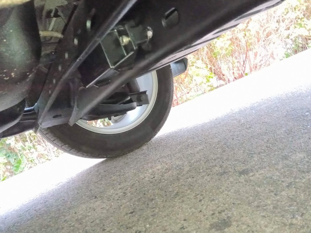

Just to give @fabdavrav some feedback on his experiment, I fitted the harmonic damper to the rear subframe of my Octavia and instantly noticed a quieter vehicle on my usual commute. It certainly reduces rattling from the rear suspension and reduces other noise transmitted through that into the cabin. A definite improvement IMO.
I can't say that I've noticed the drumming/logs tumbling sound that others have heard but that might be drowned out in my car by the sawblade worn tyres causing a worn wheel bearing type drone in mine?? Next for me will be wheel alignment and some new tyres when they wear out.
