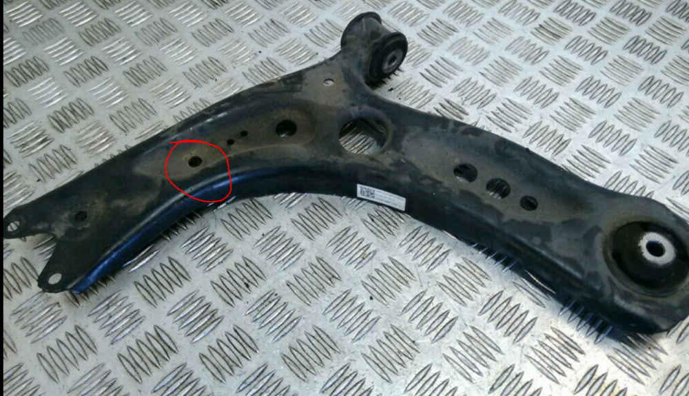

here is another blog: https://www.drive2.ru/l/481661135708226019/

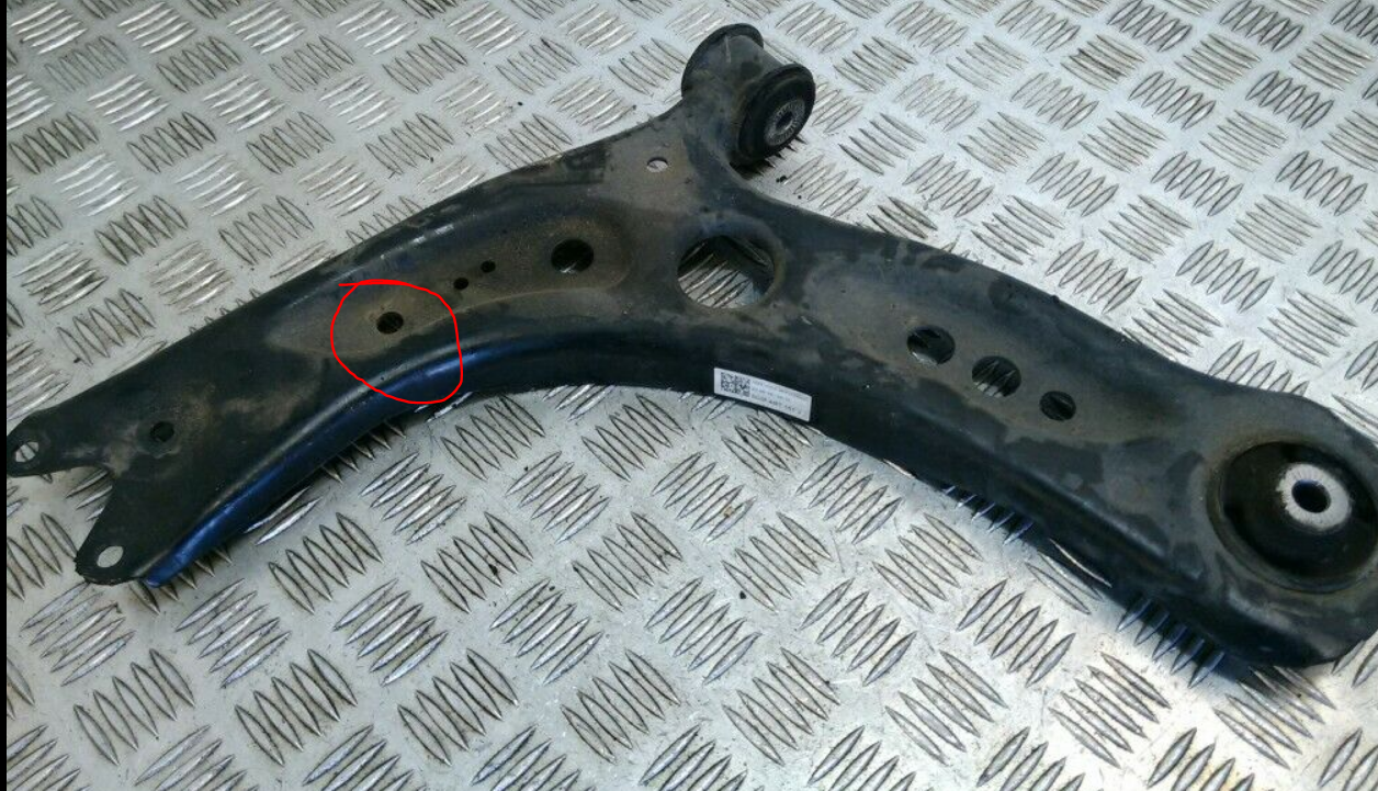

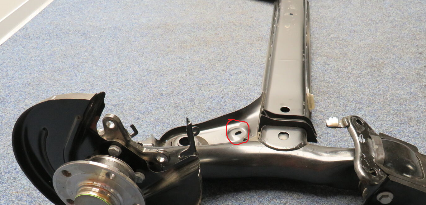

The problen is the trailing arm (dont´t know if it is the correct translation).
Maybe changing them can solve the problem or just put some. Or put some vibration dampers on them?
From looking again at the Russian blogs, it appears that the Hyundai dampers are used to absorb energy from the vibrations in the trailing arms that are excited by the tyres before they reach the car body.
Bolting on dampers might work, but those may not be sized or positioned  optimally and there is always the risk that it may move the problem to another set of conditions (speed, road surface) that cause problems.
It would be interesting to try it. The trailing arms would probably need to be be removed to drill the mounting holes.

I'm searching the equivalent of the hyundai/kia parts, but then made by the volkswagen group. I'm sure a brand like Audi has these?
I've been looking through various Russian pages and, if you have decent drill bits and can get some weight behind it, some of these could be fitted from under the car.
Adding dampers to the front and rear arms has to be worth a try.
I'm struggling to find the Hyundai/Kia parts in the UK. Yes, there must be other manufacturers that do them.

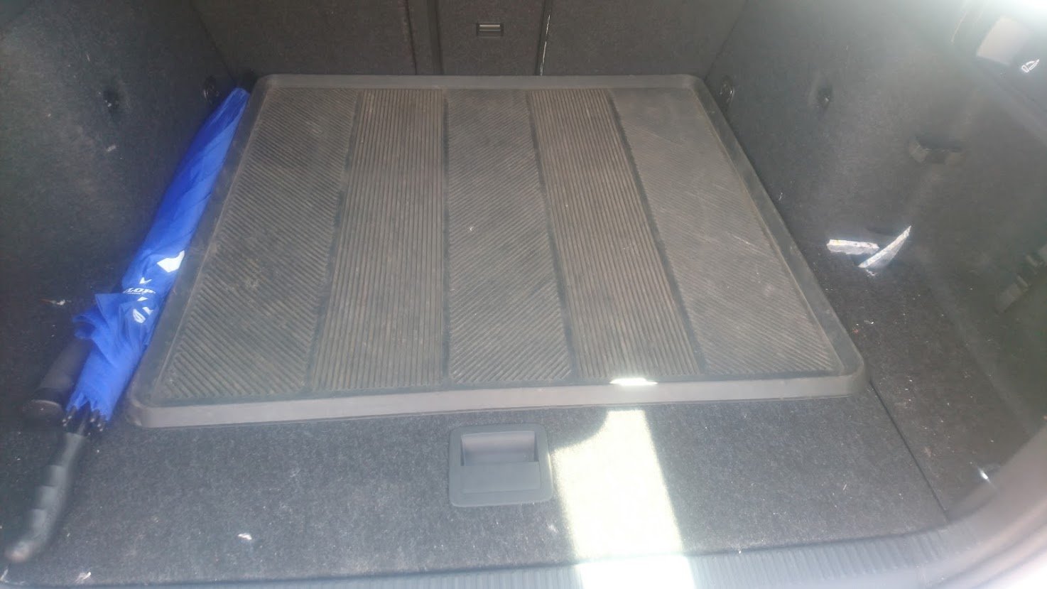

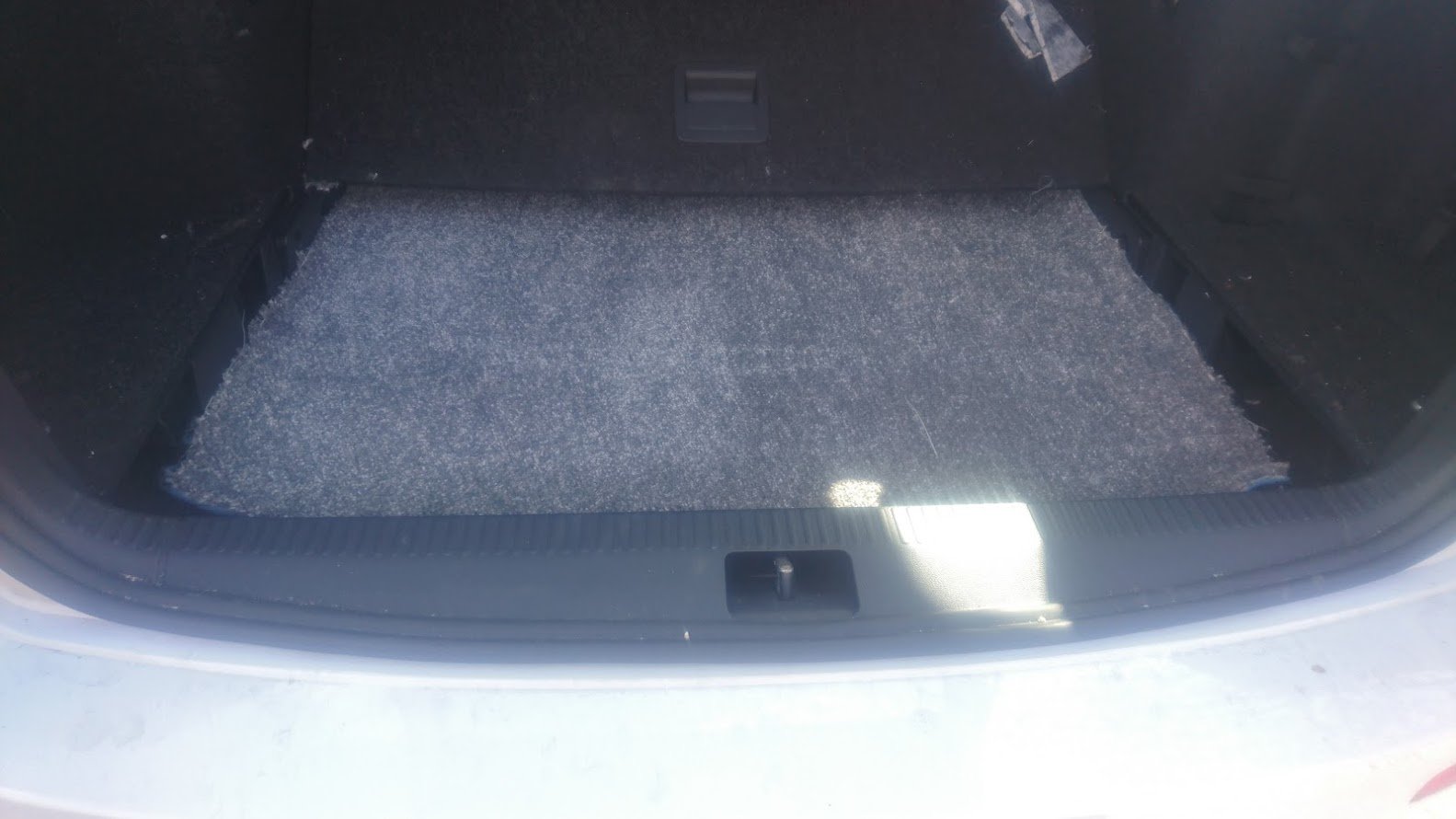

Can you post some pictures of the trunk and carpets ?
I've got an appointment this monday with the dealer.

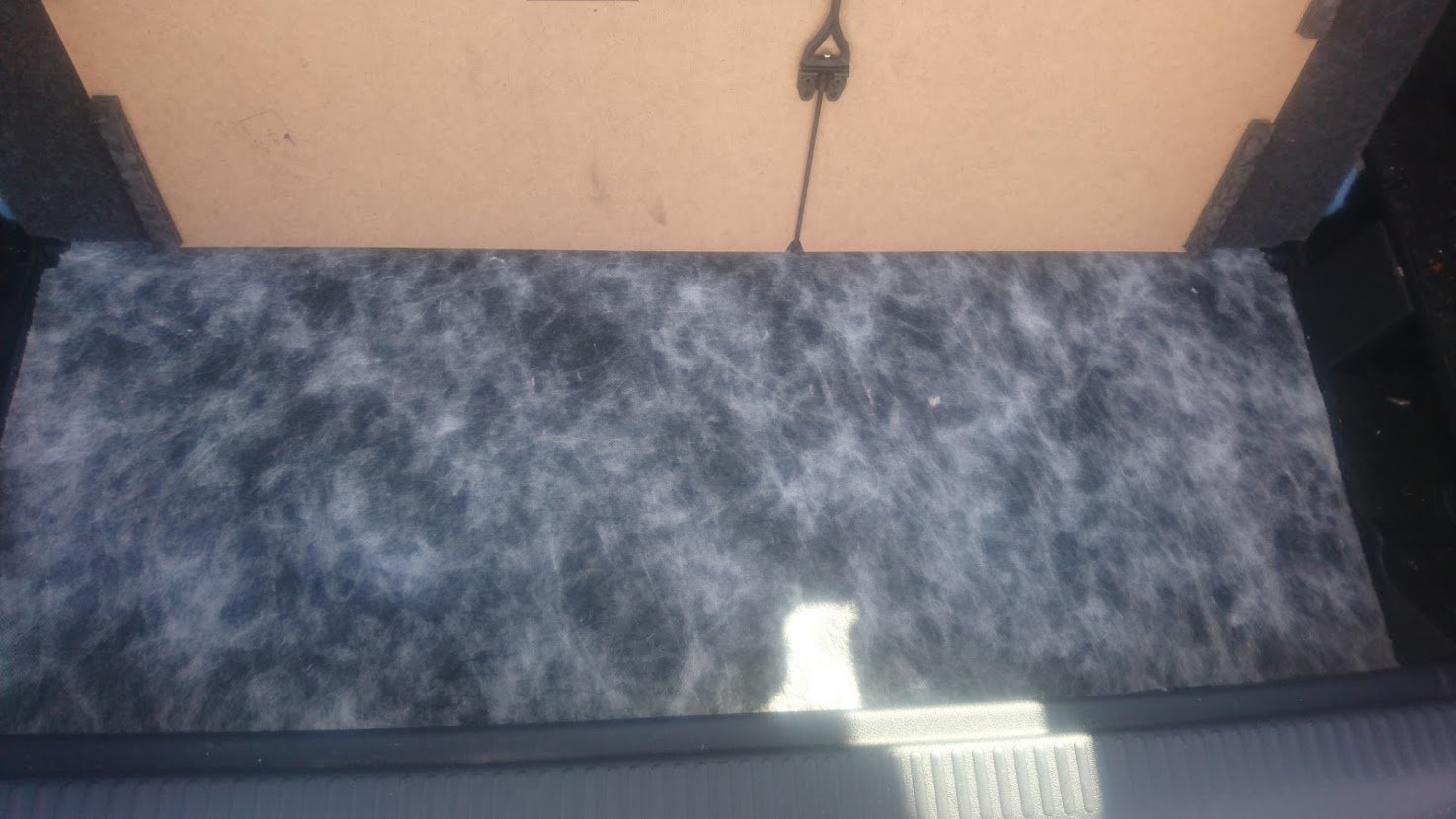

It's nothing very exciting, but here is what I now have in the boot.
The underlay is 10mm(?) platinum foam. It looks like this: https://www.amazon.co.uk/Platinum-Underlay-10mm-Thick-Carpet/dp/B00KJI1AQG
The spare wheel is resting on  pieces of underlay, but I've not fully lined the wheel well yet.
I'm not sure how much benefit the carpet is adding, but I thought it was worth trying as it adds some weight and maybe some sound reduction.
The carpet dealer?

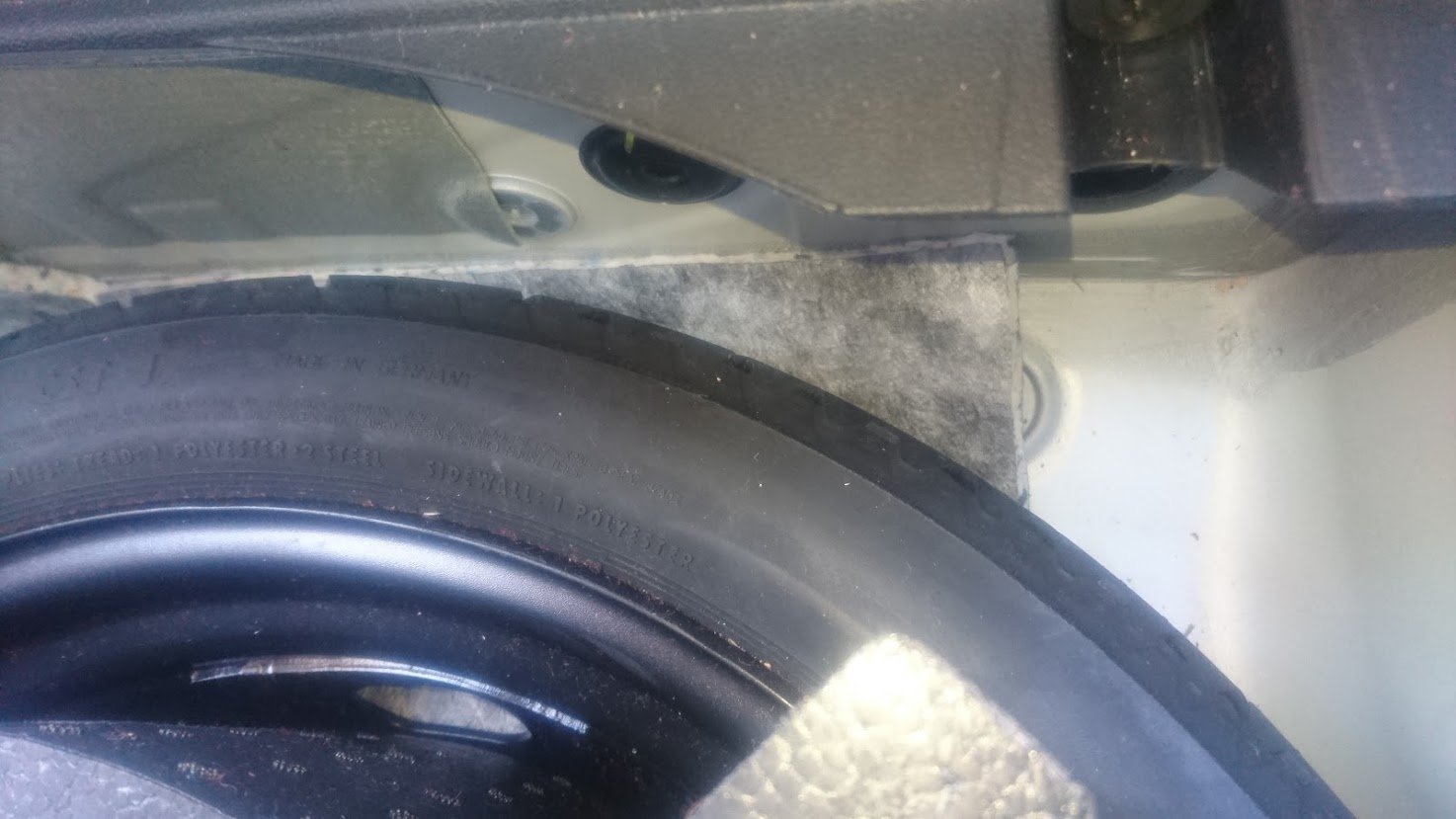

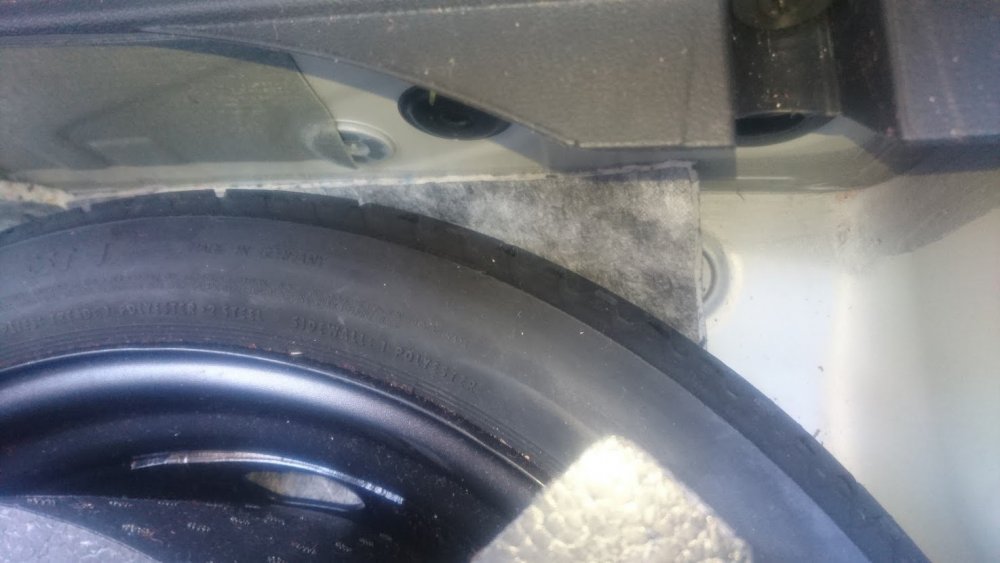

Having driven the car on a long ish journey on a variety of roads, I feel that there is almost certainly a pressure issue as well as a remaining vibration boom issue. My ears felt pressurised at various times and my 9 yo daughter mentioned, unprompted, having a headache at the same times as I felt the pressure -my wife said she hadn't noticed anything and my son didn't mention it.
I decided to look at the pressure relief valve and do more sound proofing earlier.
I could reach under the bumper to what felt like the relief louvre, but could do little else.
I discovered that there is a very thin, vertical panel at the rear of the wheel well below the boot latch -lt had a small piece of sound-deadening(?) material (the same as the pieces in the bottom of the wheel well) slapped on it at a jaunty angle. Tapping it produced a loud, hollow noise. As did tapping the jack/tools holder.
I stuck some thin, flexible plastic backed mat to the panel with strong double sided tape and then stuck some of the carpet underlay to the mat. The sound was deadened considerably when the panel was tapped. I did similar under the spare wheel and put underlay under the tool holder.
On three laps of my local pothole and ripple test area, the booming noise appeared to have been further reduced and the car seemed quiter.

Rear axle was so that BMW ones bolted next to wheel and spring and the kia/hyundai ones went just to the middle of beam where the oval holes are. They need bigger washers than normal. I installed 2 pcs one on each side of U shape. One would be enough I suspect But I got over exited while ordering parts.
BMW ones just needed long bolt, washers and nyloc nut. Washers stacked so that the heavy damper outer shell can vibrate independently and wont touch up with beam.
Red circle of mounting hole I mounted it on, on the picture. And it fits very well above the beam not under so no clearance issues.
At the front the problem with BMW one was that I could not mount it on top of the wishbone but underneath so you can imagine that when driving down from the sidewalk on small angle it might scrape the curb. However here was the hole I mounted it. I did not test it on top because it got really close to sway bar and I was unable to test if it would clear everything on both extreme suspension positions.
That's why I ended up with dampers as in the seat link. Would have preferred BMW ones in front also because in my opinion they worked bit better as they were closer to wheel.
