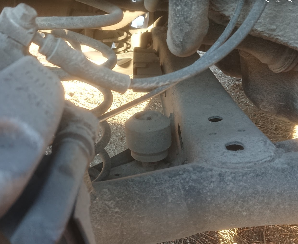

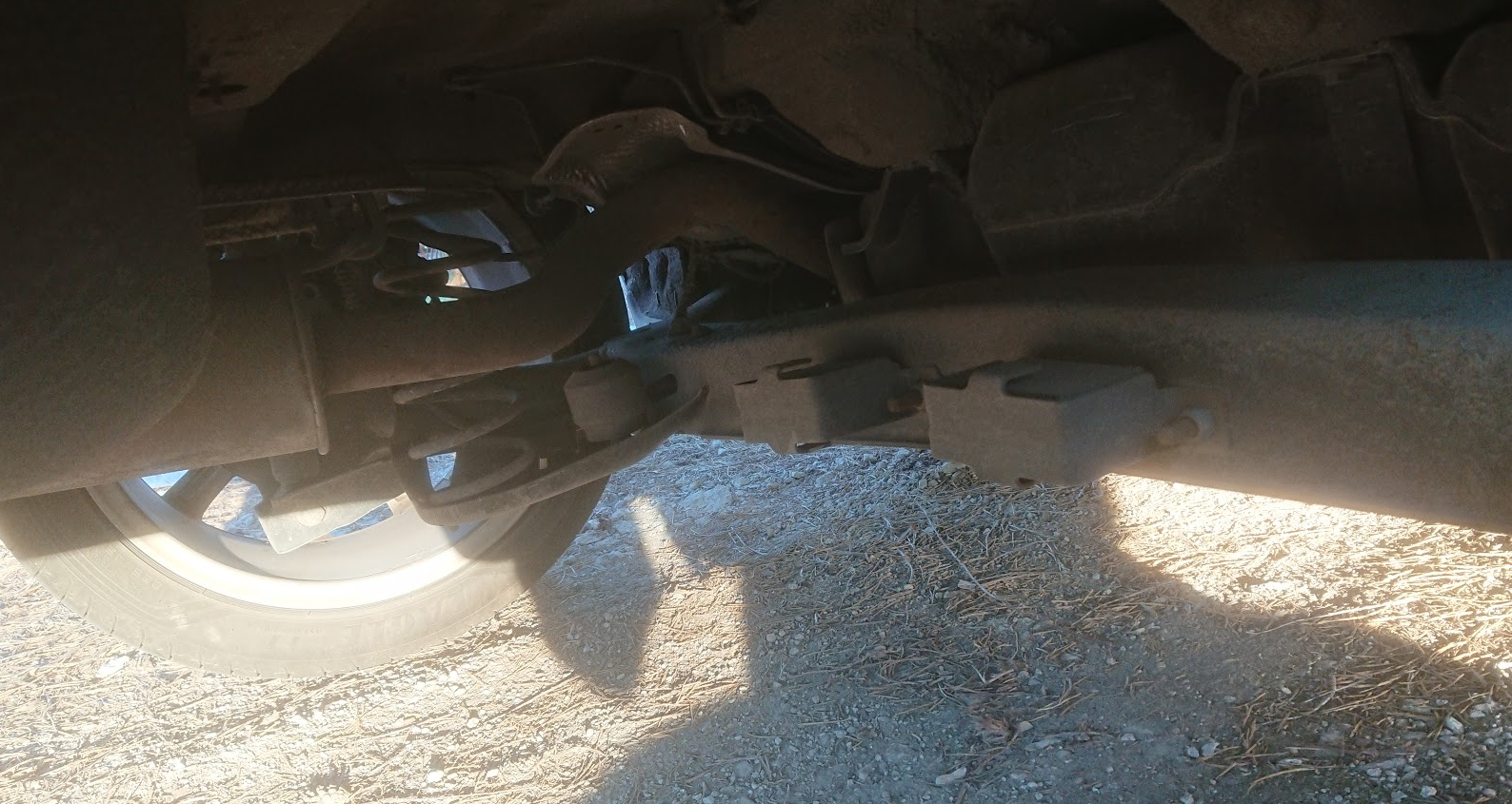

The Octavia (and seemingly other VAG cars of the same generation) has an undamped resonance that is in the audible range at various places in the body.
Rear static dampers were just bolt on. No drilling needed.

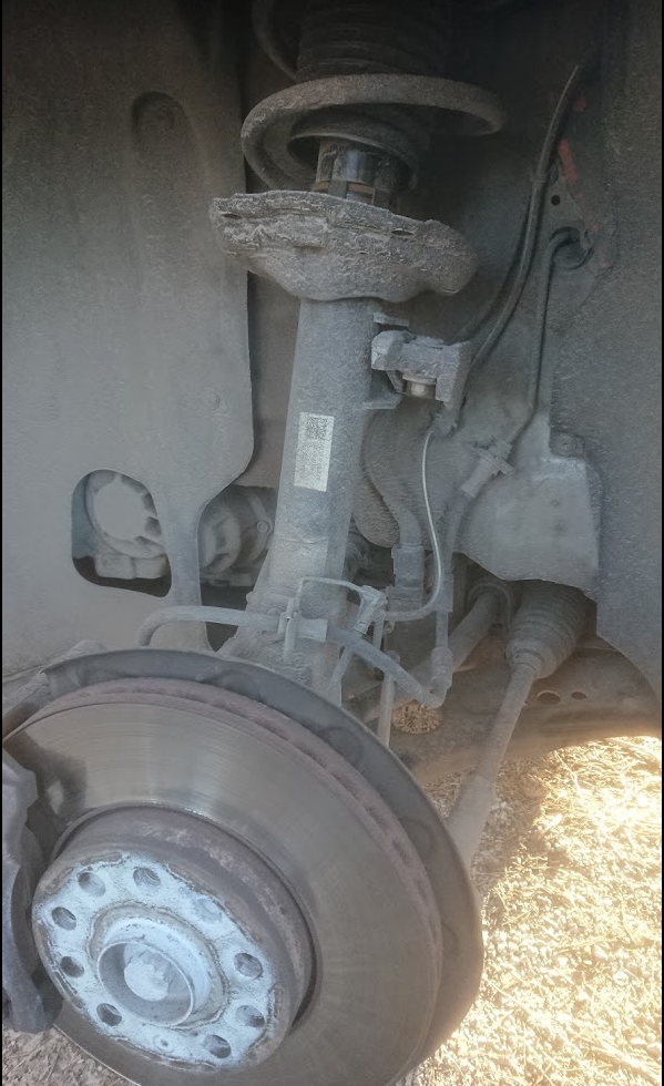

On front- ford damper that is on the strut - no car modifications needed. Modified the damper itself and used a thick washer underneath.

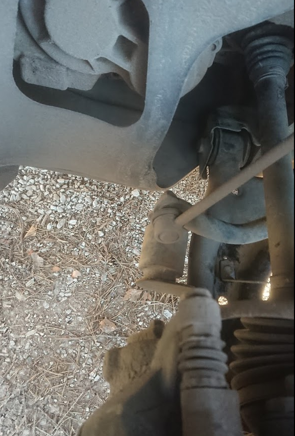

On front swingarm - needed to drill 2 holes per side to the swingarm. Need to be careful and make sure that wheel will not touch the damper when on full lock.

Update:
Fitted the BMW 'blob' dampers this morning with 4 washers (6-8mm) underneath. Needed that many as the body of the 'blob' was catching on the torsion beam. Quick spin round the block suggests they really do make a difference. I'll give it a chance for the suspension to settle as I had it up at both ends and various points of the install.
Talking of the front end, I got a couple of the ford dampers that mount on the drop link tab on the front shocks. Modified them by lopping off the extra tab so they will sit flush. Good bit is you can get at the mounting point without removing the wheel. Just jack it up with the steering on full lock and you can get to it. Good idea to jack both sides at the same time to save putting stress on the bolt. Failure time was when I found my stock of washers had nothing big enough. At least M12 required maybe even 14. So I couldn't fit them this time round. I'll borrow some washers from work or something and have another go on my next day off.
