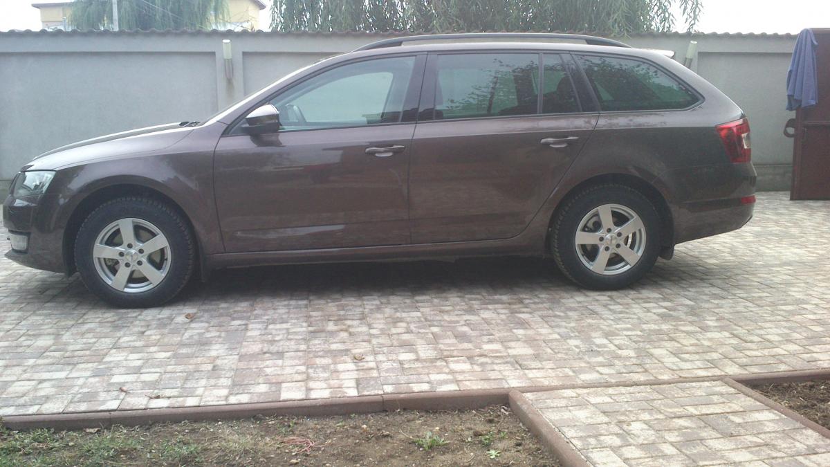

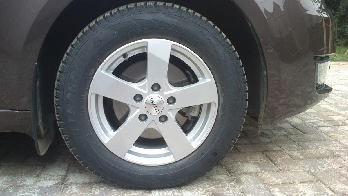

DEZENT TD 6.00 x 15 ET 43
Goodyear ULTRA-GRIP-8 195/65 R15 91T
post-110632-0-18308100-1413107759_thumb.jpg post-110632-0-64162200-1413108058_thumb.jpg

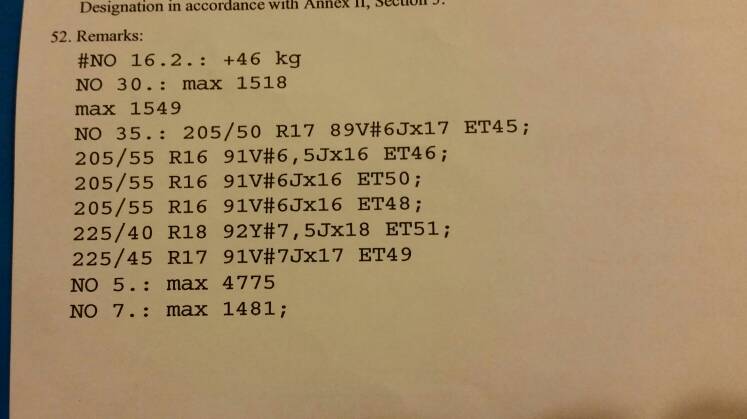

Guys...it seems that I bought some second hand rims that are not recommended for Octavia 3. They are 7jx16 et 45 with 66.6 bore. In the technical book I have 6.5j x 16 et 46 with an 57.1 bore as recommended rims. The bore will be fixed with some rings, but in terms of wheel allignment this means that the new rim will be 5mm closer to the suspension and will poke out 7 mm. Comparing them with the actual 17 inch rims, they will be 4mm further away from the suspension and will poke out 4mm. Is it safe to put this new rims on my car? Are they going to affect my suspension or the bearings? What about geometry? Thanks
Edited by barqqsanu
Any answer? Here is what I have in the tehnical bookpost-122451-1413278645364_thumb.jpg
They'll be fine. The center of the wheels (width-wise) will be very close to OEM due to the small difference in ET, so no worries about geometry and bearings. Since the inner side will be further from the suspension than the 17" rims, there's no issue there, and on the outside 4mm is much less than the spacers some people are putting on their cars to improve the looks. I think you're good to go.
