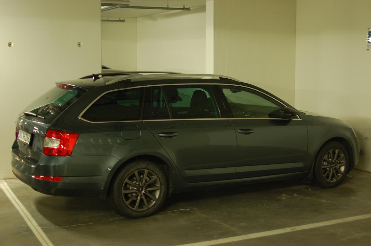

Small rims, but they'll work no matter what in winter conditions for my missus and our daughter. :x

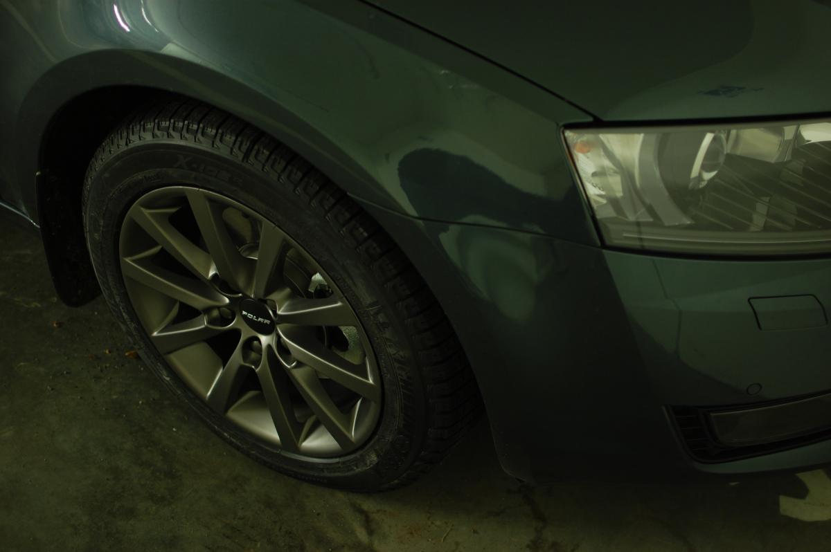

It'll work just fine, just look at my images in this thread. The Polar wheels are 7x16 ET45 with 205/55-16 tires.

Nice looking wheels by the way, I found a lot of fussy looking aftermarket alloys, but these have a very clean design.

Would be optically much better in 17", but I am really pleased with the comfort and low noise level of these 16" 205/55 Michelin Ice XI3 compared to Vredestein's tractor fitment on my Polo 6N... :yawn:

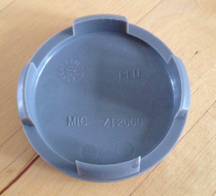

Yeah, mine came with Dezent centre caps. They've got ZT2000 written on the back and they're just slightly bigger than the Skoda centre caps off my Teron wheels. Haven't measured them but might guess that the Skoda ones are 55mm and the Dezent are 60mm?

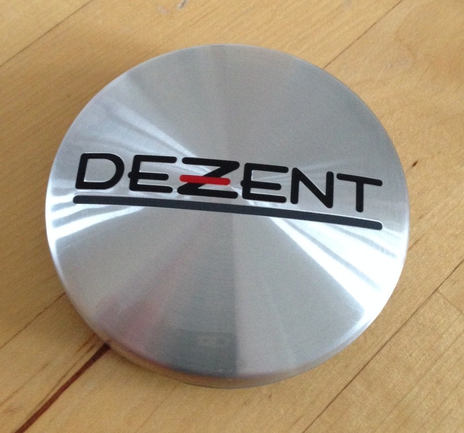

Here's what they look like. As I say, I'd prefer Skoda ones, but I'd be interested to know of anybody elses experience (good or bad) with cheap centre caps or stickers.
