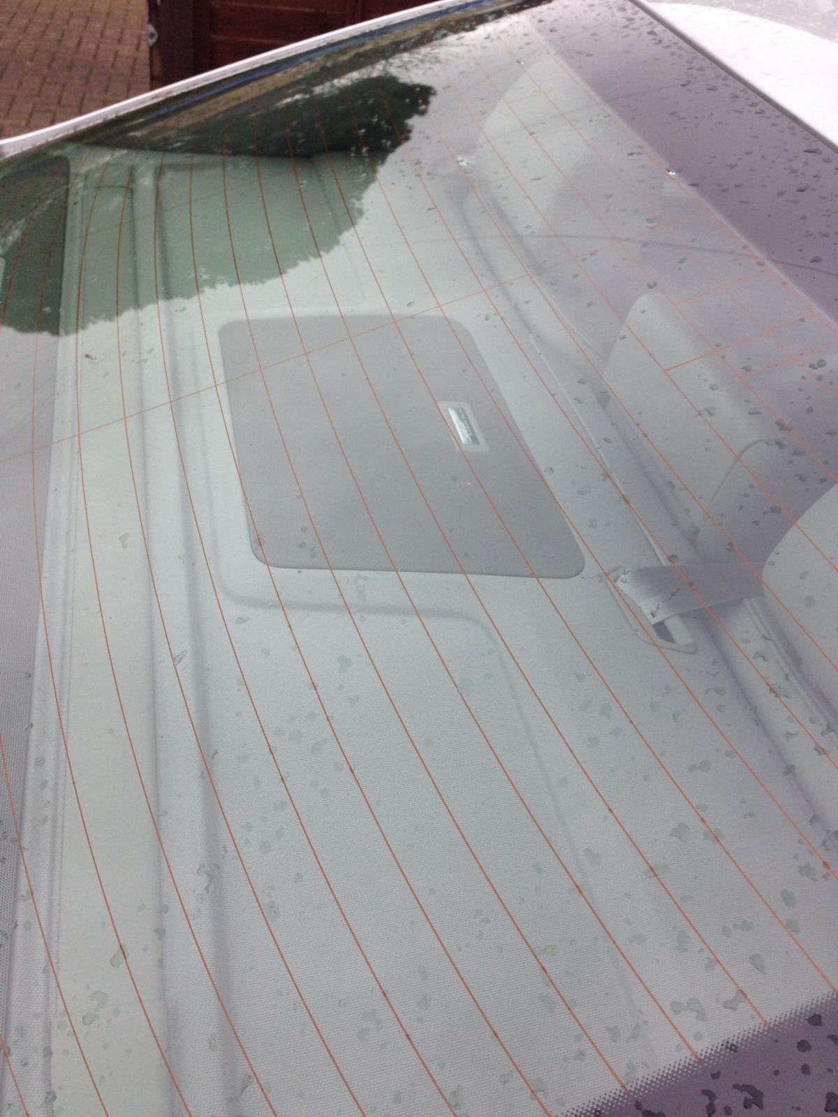

Solar Sunroof

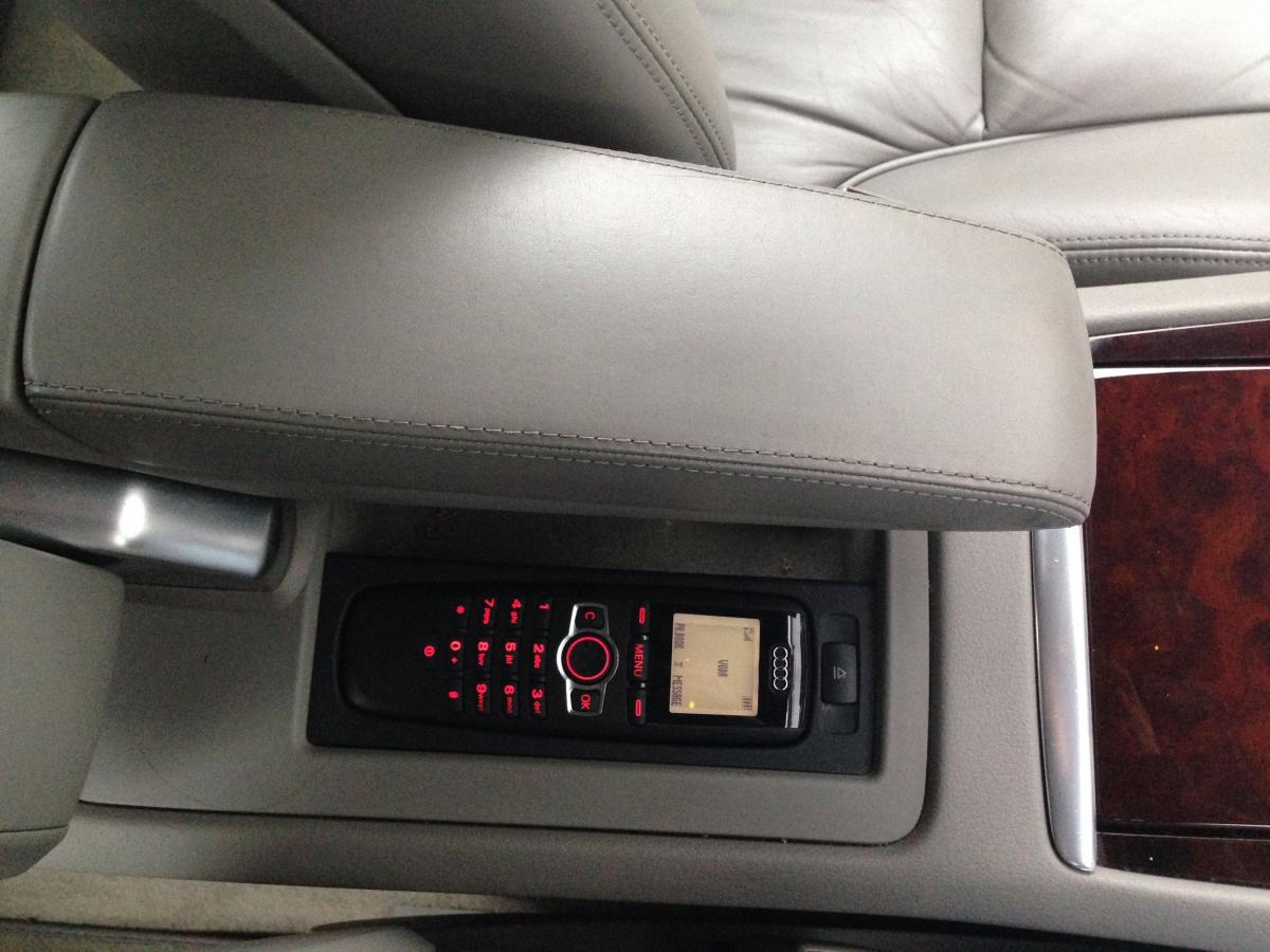

Audi phone in armrest, with sim card slot

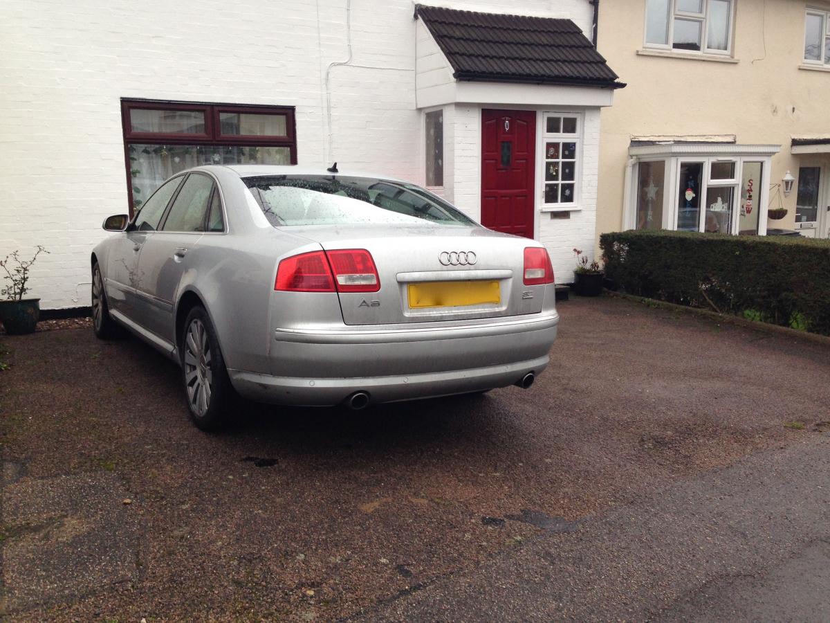

Sorry its taken a while, but here are some pictures. I'll do some better ones when the weather is better, these give you an idea.
Today I have been underneath the car, and have seen where the exhaust is leaking from, basically it needs the flexi joint cutout and a repair part installed. The rest of the underside is in good order with no issues.

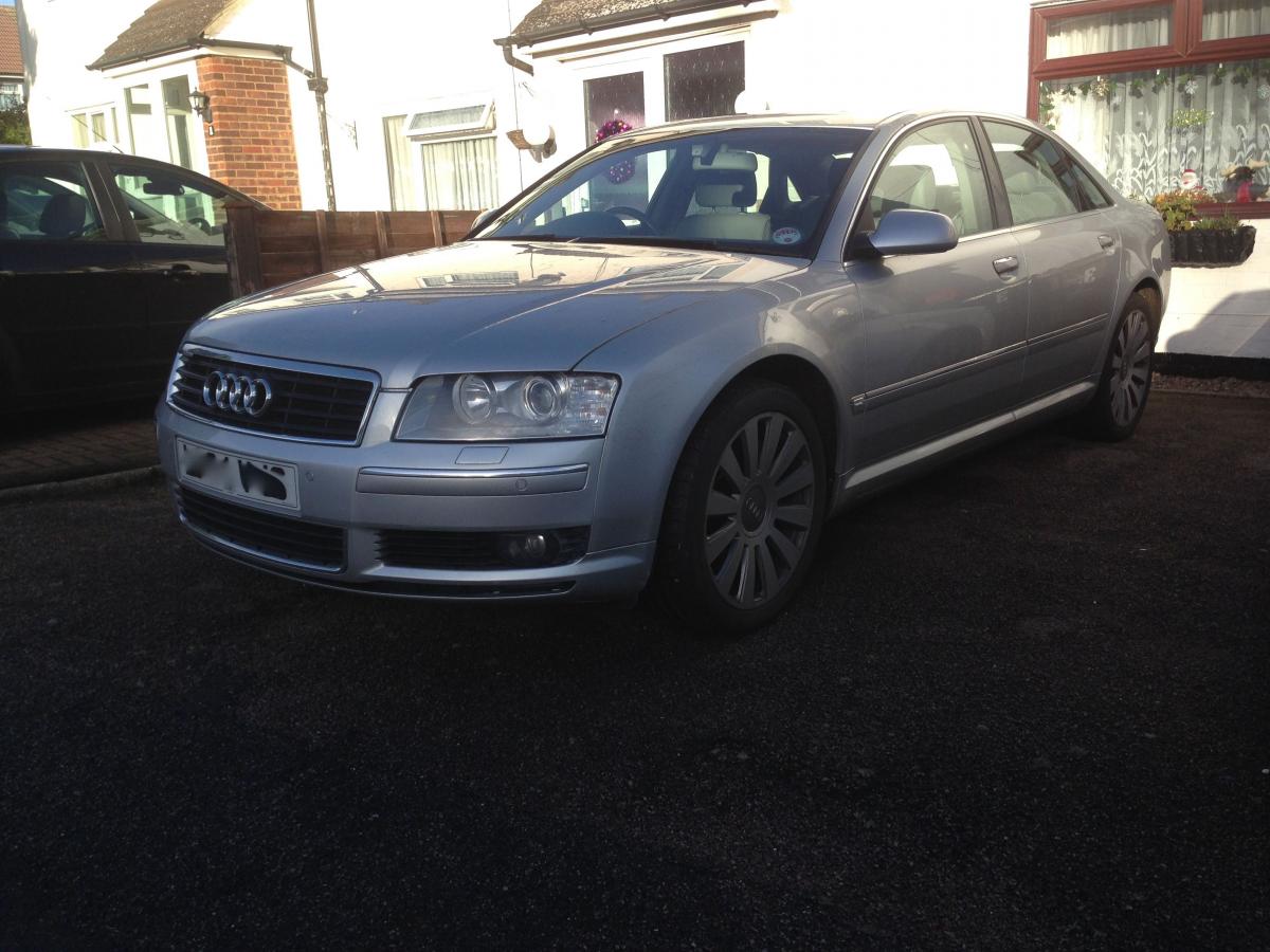

Here a couple of the front end.
