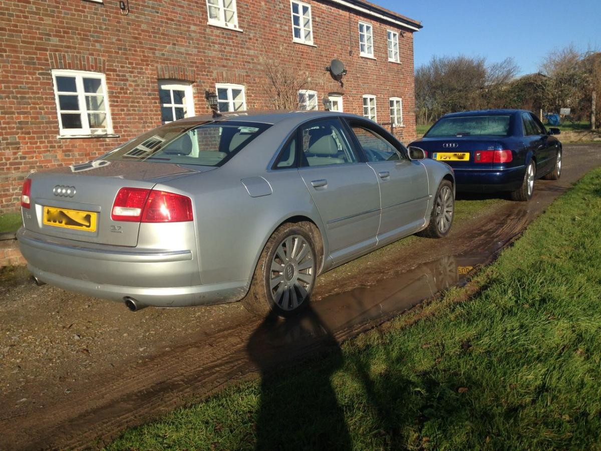

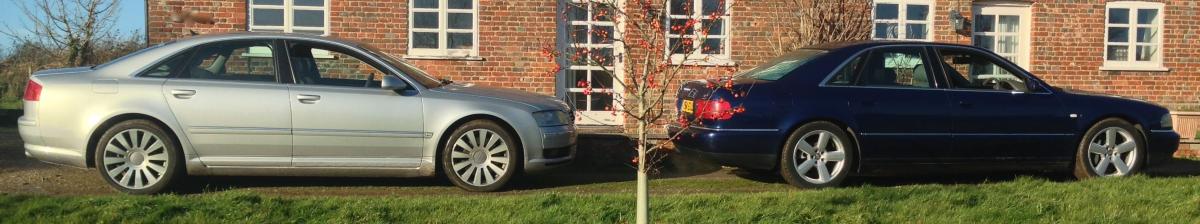

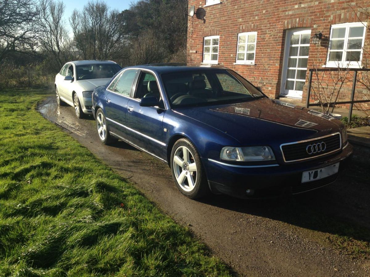

Adding some pictures taken today of both my old D2 and this D3, the difference in sizing is quiet apparent, with the D3 being tallest of the two.
Edited by mannyo
The original A8 is a 'big' car.
Can't imagine the size of the newer one!
Looking at those pics, with the cars side by side, I think I still prefer the older one.  Seems to have better proportions somehow. No doubt the newer one has more up to date kit but just personal preference.
D3 is easier to drive due to the variable rate power steering, which the D2 lacks.

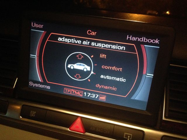

The suspension has a number of different modes and the car height varies, I'll explain briefly, see image below for MMI screen.
Lift - increases the height of the car above normal to allow you to drive over rough terrain at low speed.
Comfort - Normal ride height, designed for gentle cruising and is the softest setting.
Automatic - Normal ride height, once 75MPH is reached for more than 30 seconds the car drops 25mm and stiffens up slightly to allow a more positive feel on the motorway. Slow down to 40mph for more than 90 seconds and the car will resume the normal ride height and increase 25mm.
Dynamic - Car drops 20mm and stiffens the ride, at 75mph for more than 30 seconds the car will drop another 5mm and stiffen further for a more sporty feel. Slow down to 40mph for more than 90 seconds and the car will raise 5mm to the dynamic height.
I leave mine in Automatic most of the time, however Dynamic is great fun and the car handles noticablely different.
