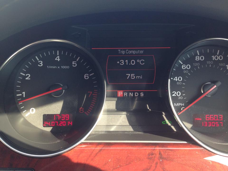

it was a little warm yesterday and the dash temperature display reached the highest I've ever seen it, this was after driving it as well so the parked in the sun heat had been lost.
And today the Audi has let me down, she is misfiring on Cylinder 4 with the engine light flashing on/off.

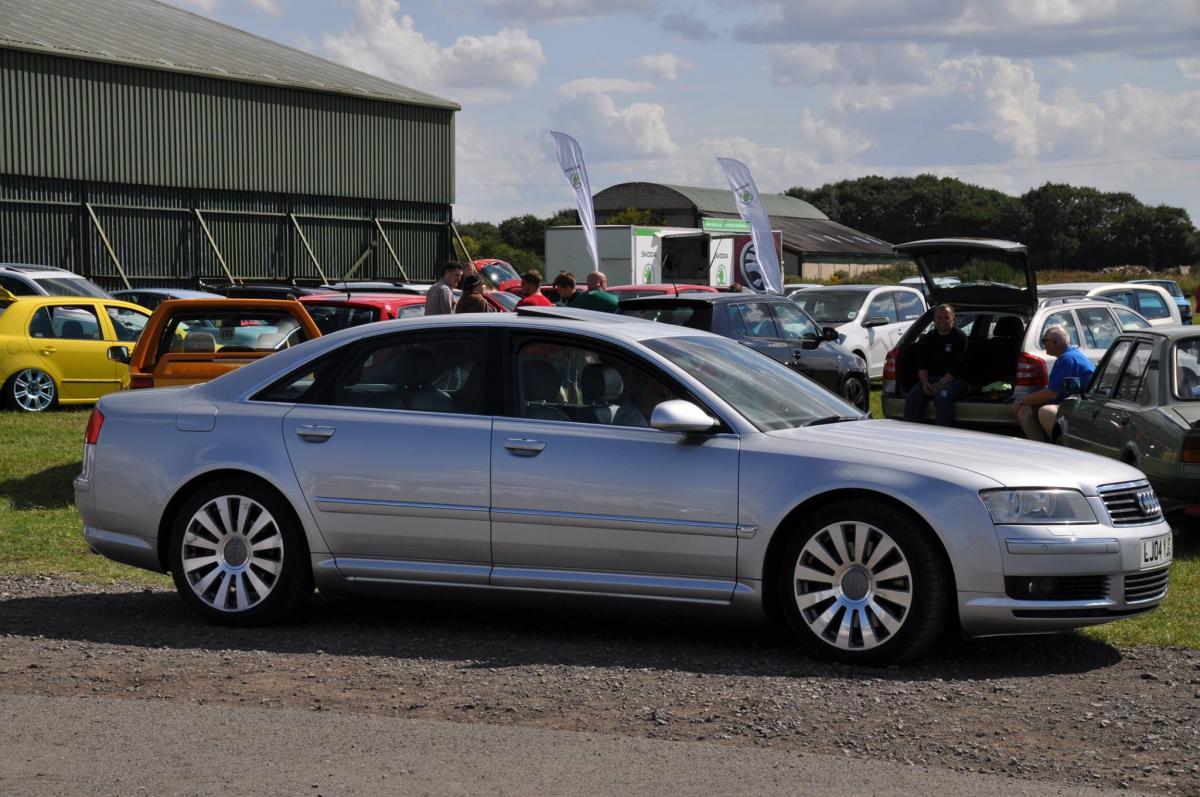

That car did look lovely at Blyton today.
Thanks, and here is a picture taken by Brimma as I was getting ready to leave.
I really like this car, yes it still has some niggly issues but it runs well. Just need to fix the headlight washers and a suspect rear wheel bearing, the bearings been whining for several K now but not getting worse so king of living with it.
400 miles covered in just a couple of days, and on less than 1 tank of fuel.
Very nice  :clap:  :envy:
I just realised, mine was one of two A8s at Blyton, not sure if you mistook mine for the white S8 badged TDi that was out on track during the afternoon.
Err, no! I liked the white one, too, but yours was the one that did it for me. :)  (Why would you put fake S8 badges on a TDi?)

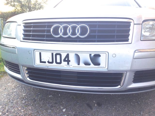

I managed to source a new lower front centre grill to replace the one currently installed that was incorrect. My car has adaptive cruise control (ACC) so should have had a different grill which allows the radar to pass through unhindered. Anyway this week I swapped the grills, and after clearing the fault codes from the radar module. I ran the basic settings in VCDS and for the first time in a long while the adaptive cruise works. Press set and the car will maintain a set gap from the car in front and will speed up/slow down and apply the brakes if needed without intervention. Not bad for a car that is 11 years old, this is technology ahead of its time back then.
Prior to the replacement the Radar could not see through the grill, so recorded a misalignment fault and disabled cruise control, it did not work at all.
Picture below is of the car fitted with the replacement grill, you can see the square panel in the centre. Behind that panel is the radar emitter/receiver.
I've also reset the alignment of the sunroof, so it now opens and closes properly instead of sometimes getting stuck.
Well done, glad it's sorted, didn't realise ACC had been fitted for so long.
Must have been a rare option back then, it took me nigh on 9 months to find a grill and this one cropped up via a PM on another forum. Quiet pleased as it did not cost me anything because its not in perfect condition, and the Audi RRP for a new one was astronomical.
Good job getting it fixed. It's nice when you get a job like this done. You can chill on the motorway a bit now!
