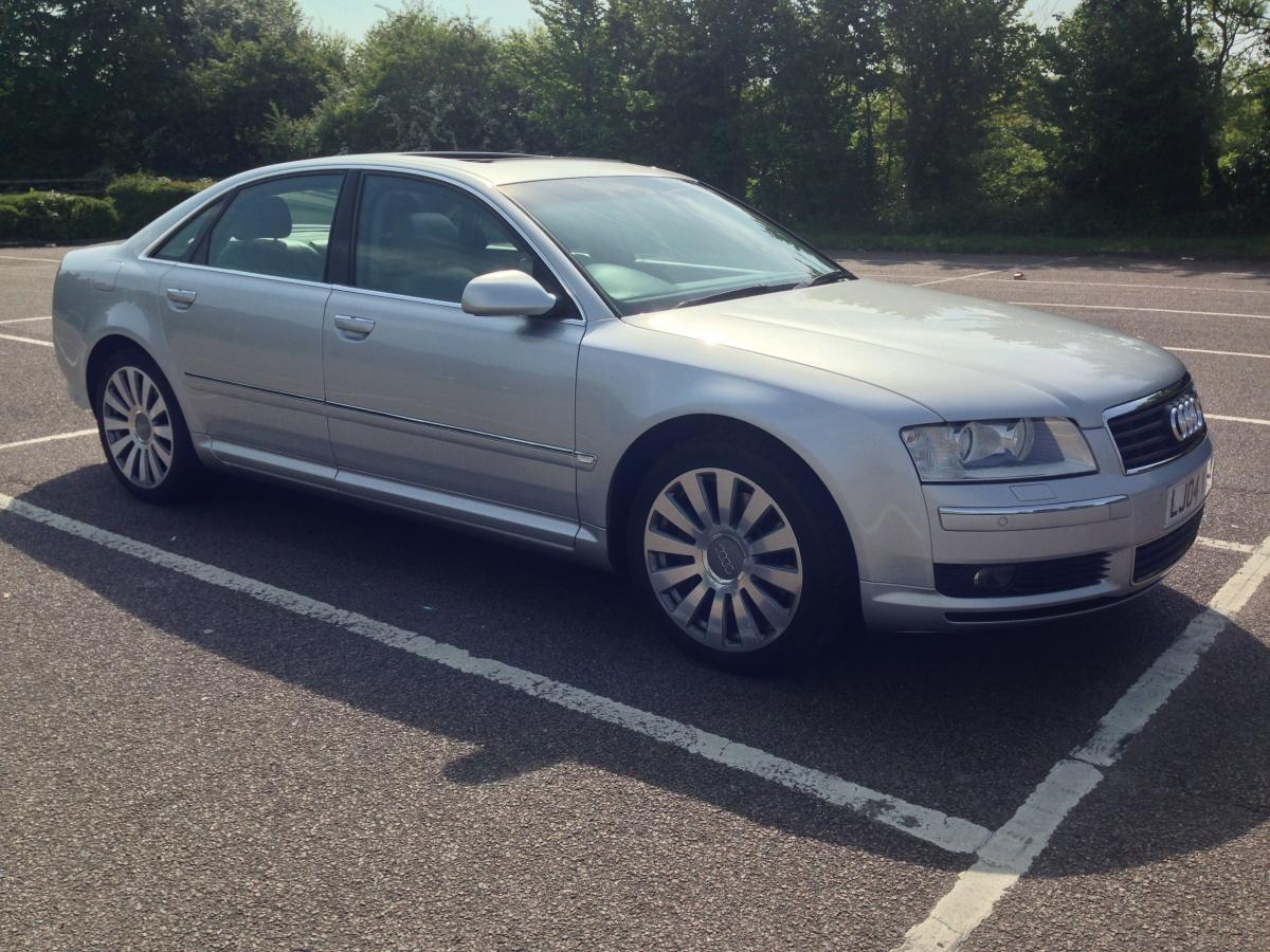

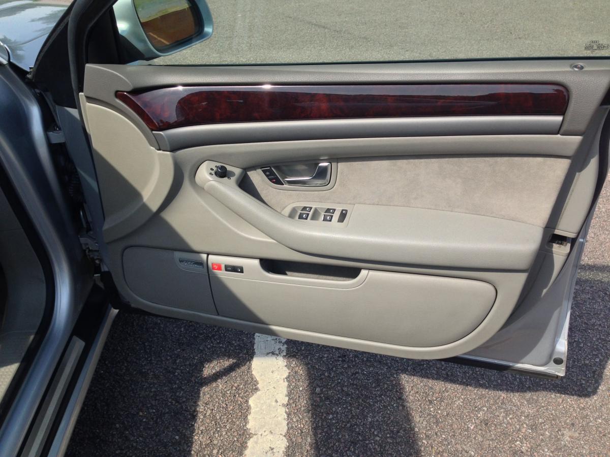

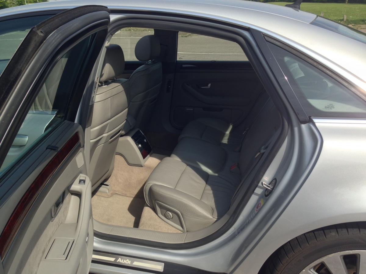

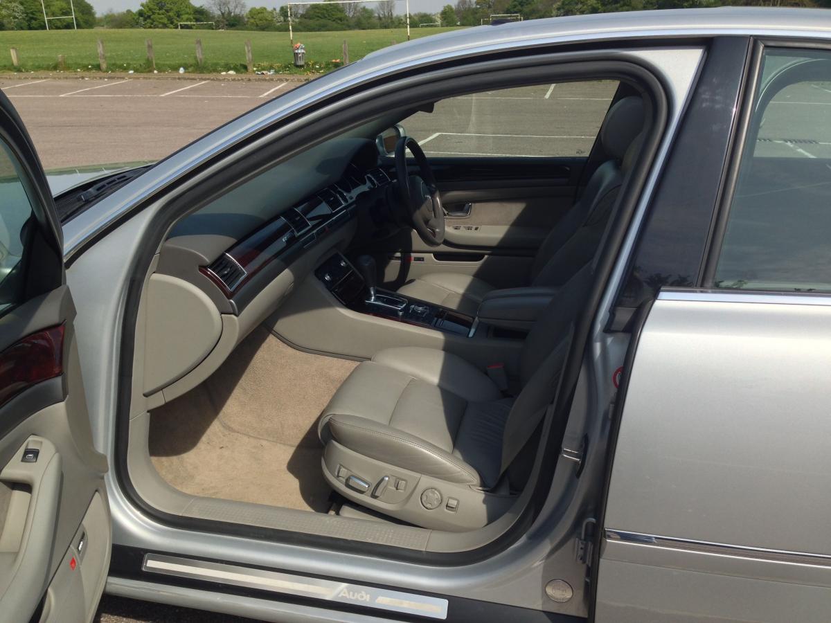

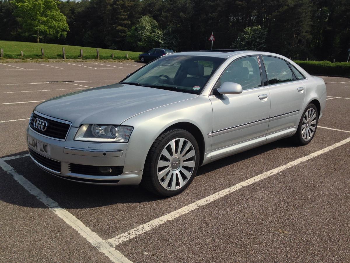

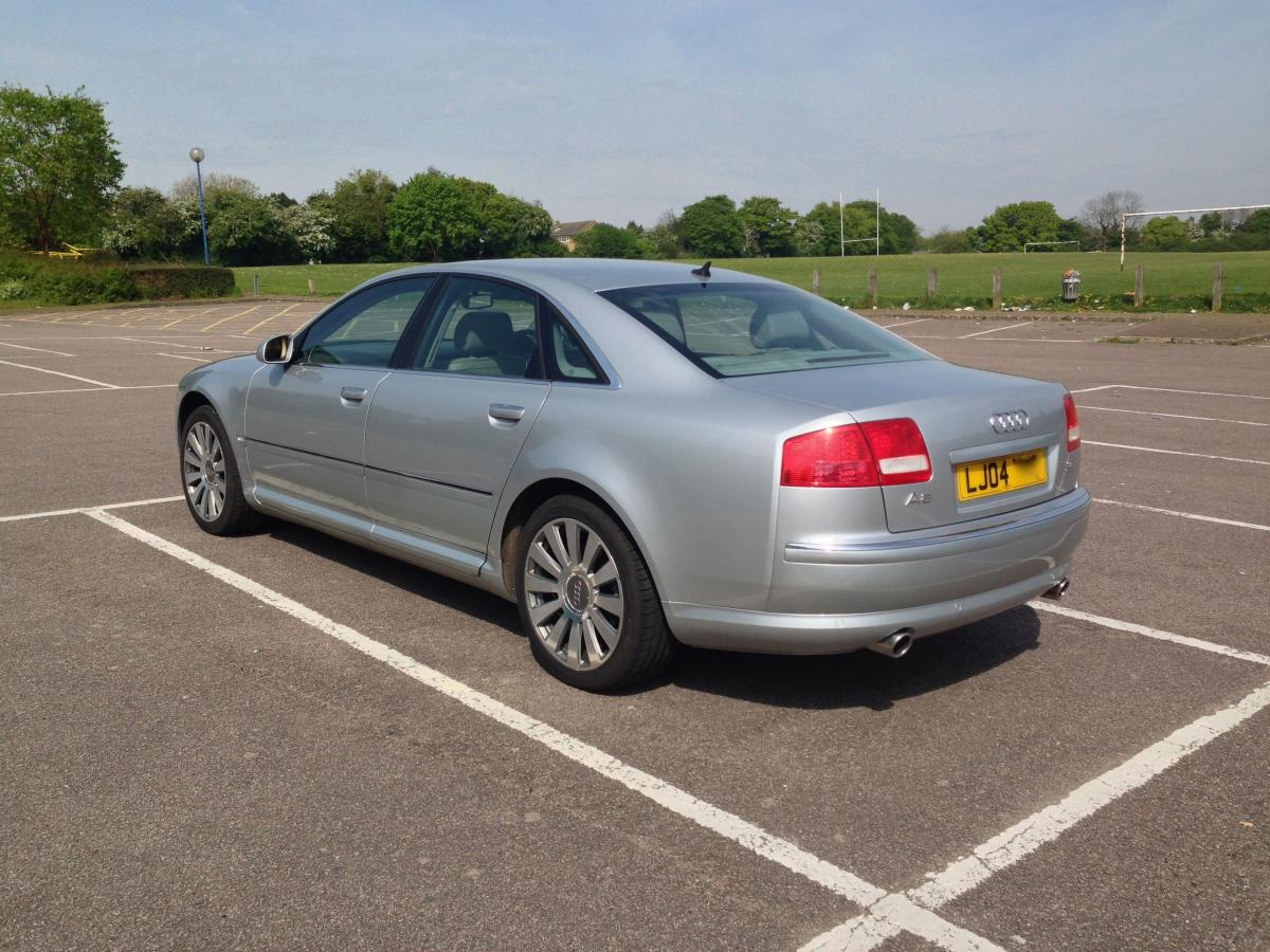

  • New updated picture   Just took these after I had the car cleaned on Saturday, in the spring sunshine the car looks really good and its such a shame that one of the rear wheels is suffering from lac
  • Sorry for not updating this, but I have bigger issues to worry about (not with the car)   Monday just gone the A8 passed it's MOT for another year, so it now expires on 1st August 2019, this
  • Sorry its taken a while, but here are some pictures. I'll do some better ones when the weather is better, these give you an idea.   Today I have been underneath the car, and have seen where

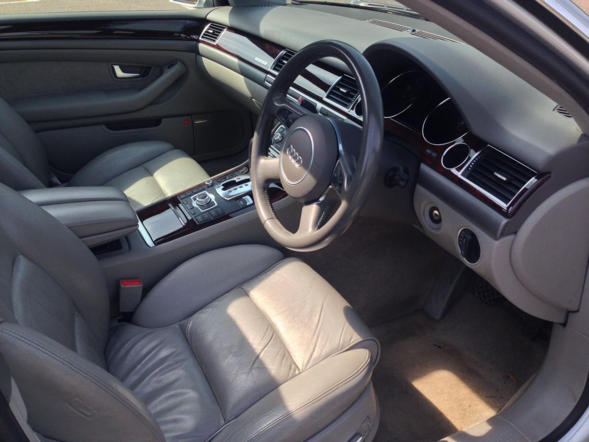

No key needed, the fingerprint recognition is more for remembering the seat positions, and all the other settings. For example, I get in and start the car. The seat position, external mirrors, climate control temperature, suspension settings and steering wheel all move to my preferences. in addition the radio presets, volume, navigation destinations and phone book entries are all set to mine.
Along with the fingerprint you get full keyless entry and keyless go. So I simply walk up to the car, as I lift the handle the key in my pocket is read by the car and it unlocks. Jump in and hit the start button, the key does not need to go into anything and remains in my pocket. When you leave the car, simply get out and press the external locking button on the door or the lock button on the key.
The car can remember 4 drivers, and its easily reprogrammed as long as a key valid key is present inside the car.
Should there be a problem with the system, you can of course put the key in the dash and use that, and also use the unlock and lock buttons on the key.

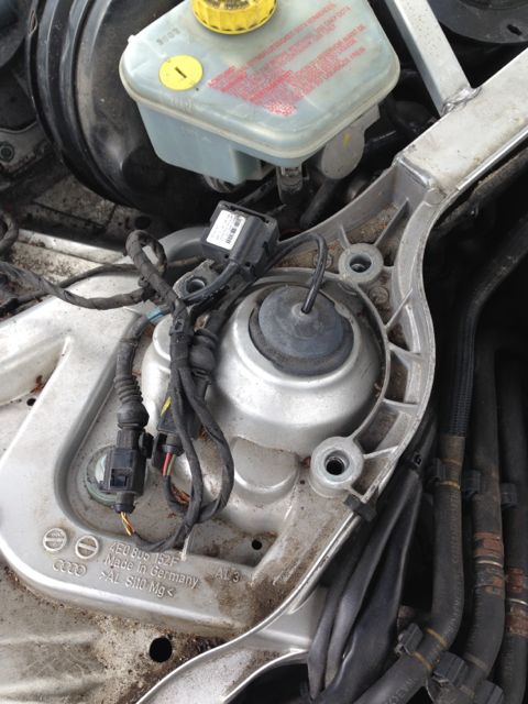

11) Fix parking sensors, replaced nearside front sensor - Completed 01/03/2014

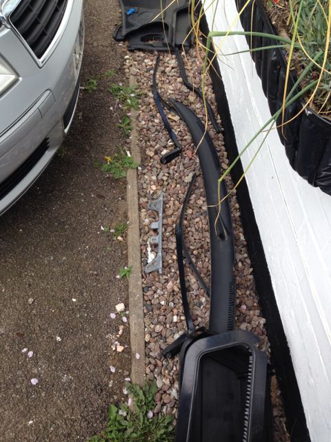

Discovered last night that the wiper linkage was playing up, the passenger wiper was juddering a lot. Quick investigation last night showed a lot of play in the passenger side bush where the arm attaches. Confirmed that this morning by removing the wiper arm and doing some basic tests, so have ordered a replacement from a breakers yard who have one from a 20K mile car. Hopefully that will have less play in the bushings and I'll be judder free again.
Still got the whining diff to sort, apparently the most likely cause is the pinion bearing preload coming loose due to wear, I'm waiting for a local transmission specialist to get back to me on that one.
I've also been in touch with the MOT testing station regarding the MOT's on the car that they carried out and they are going to check back to see if they have the invoices for the 2007 MOT that was passed to the customer and check the mileage for me. I have given them the relevant info, and they are digging around for me. (see second paragraph, post 69)

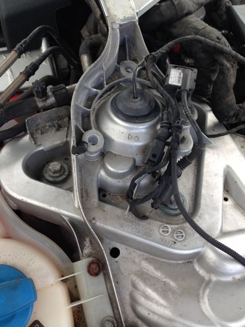

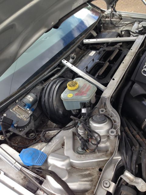

Replaced the entire wiper linkage this morning, what looked like a simple job ended up taking 3 hours due to the amount of disassembly required.
A few pictures below of taken part way through the reassembly stage.
Now all back together and working perfectly, the replacement second hand linkage was from a 2008 car which had just 20K on the clock when it was scrapped.
