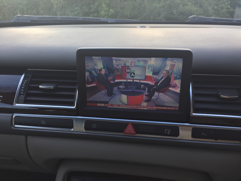

Soon to be retrofitted is a DVB-T freeview tuner, this will be swapped with the current analogue one which has not worked for some years due to obsolescence.

Retrofitted the DVB-T this evening, and it works perfectly even with the dodgy reception in Dorset.
