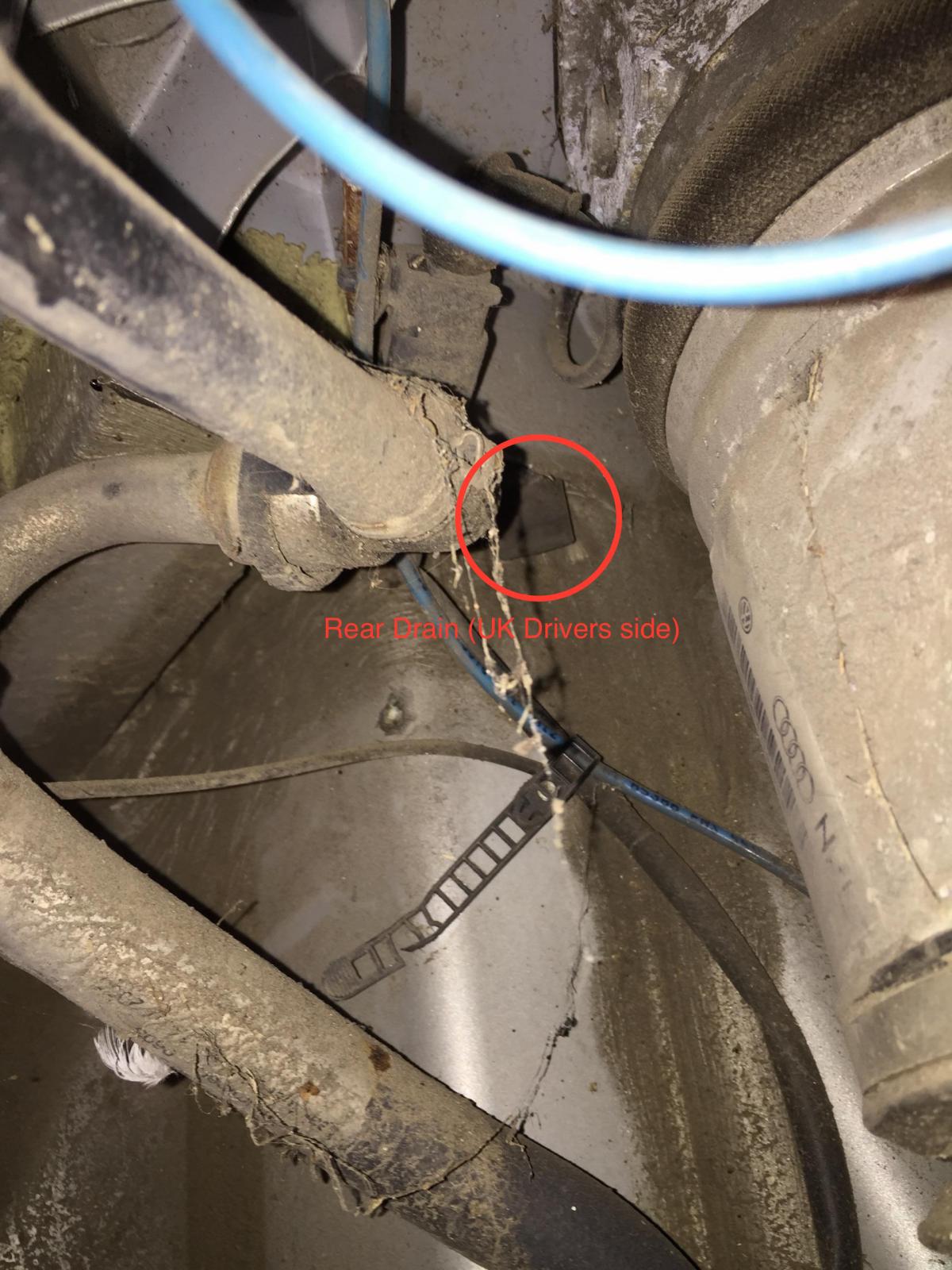

Discovered the other day after rain that at least one sunroof drain is blocked. When I pulled away there was a sloshing sound of water and the back seat got decidedly wet.
So today I set about clearing the rear drains one side at a time. The rear drains are located behind the wheel arch liners, so each wheel had to be removed and various nuts and screws removed to get behind the arch liner. The drains were hard to locate at first because I did not really know what I was looking for and only had an Audi diagram to work from.
After locating and clearing the first one, got the arch liners sorted but the wheel would not go back on. Turns out the disk had rotated slightly on the hub, so the bolt holes no longer lined up with those in the disc. The rear discs do not have the locating screws, so chocked the wheels and released the handbrake, rotated the disc in relation to the hub and refitted the wheel.
Repeat on the other side, then have the same issue with the brake disc and hub.
The attached picture shows the sunroof drain, with the air suspension strut to the side.
Still got the front drains to do, but these can be done from the roof itself by sending compressed air down the drain tube and blowing the rubbish out the end.

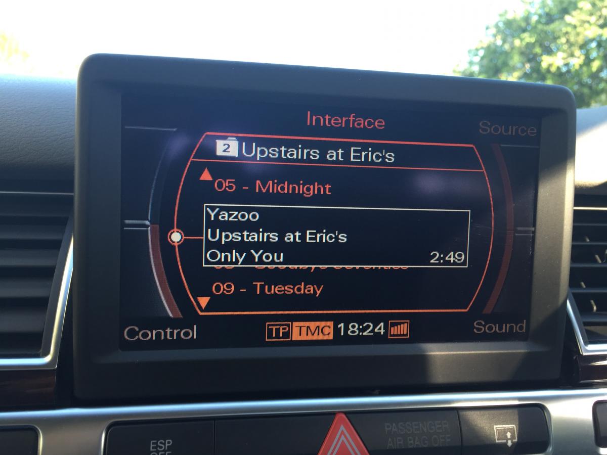

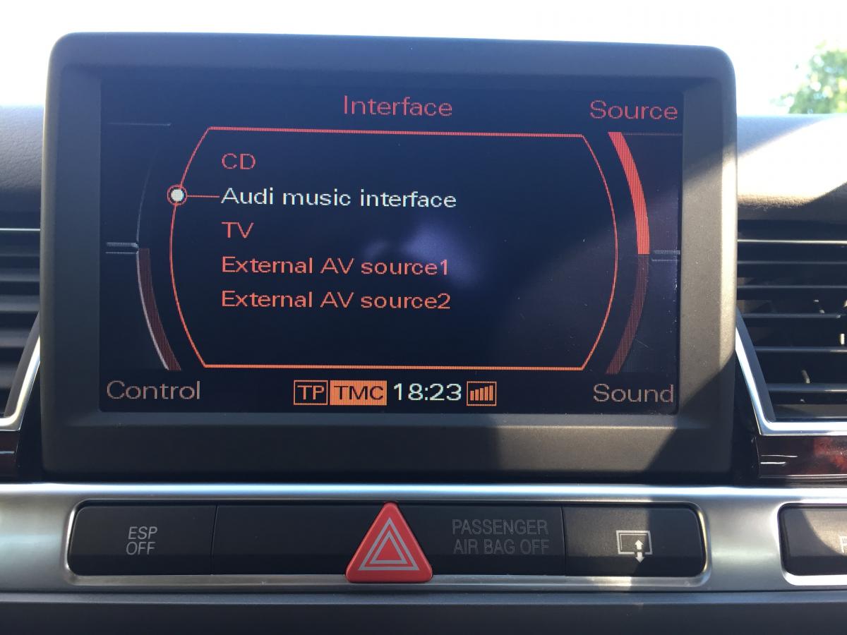

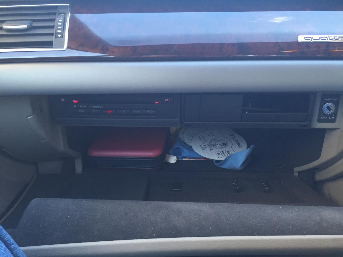

Been busy this evening completing a retrofit of the Audi AMI system which is the Audi equivalent of the Skoda MDI system. The difference with the A8 is that its all fibre optics, so you need to install a power splitter and also modify the existing fibre cable to daisy chain the MDI after the CD Changer.
Couple of pictures below showing the unit installed, along with how it functions.

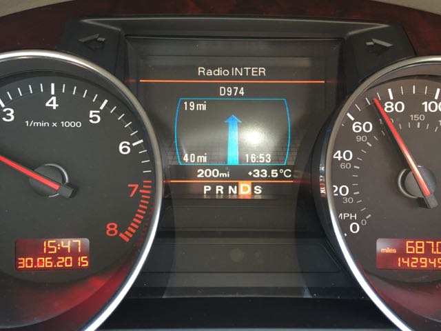

Pictures below are from the trip to France, one shows the highest temperature I've yet to see on the dashboard display, whilst driving between Cherborg and St. Lo.
