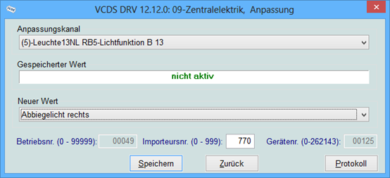

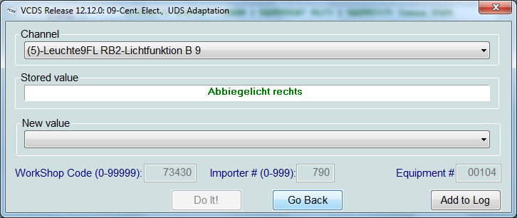

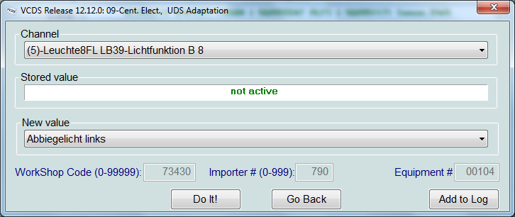

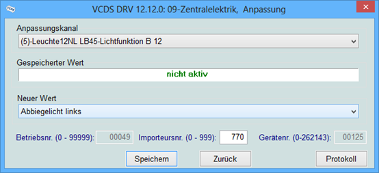

The vRS has 2 bulbs per side, so needs some additional adaptation. The full sequence for a vRS is (tried and tested)
Controller 09 - Central Electronics
16 - Security Access - enter 31347
10 - Adaptations
Change the 4 channels listed below - scroll to just over halfway down the long list of adaptation channels to find them. Do them one after the other, and do not come out of the adaptations until you have finished. If you do, you will have to close the controller and go back in and enter the security access code again.
For a non-vRS, only the first two need doing as you only have one bulb each side
