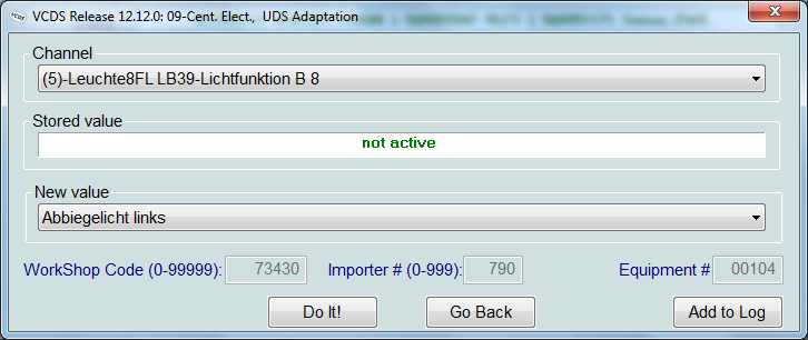

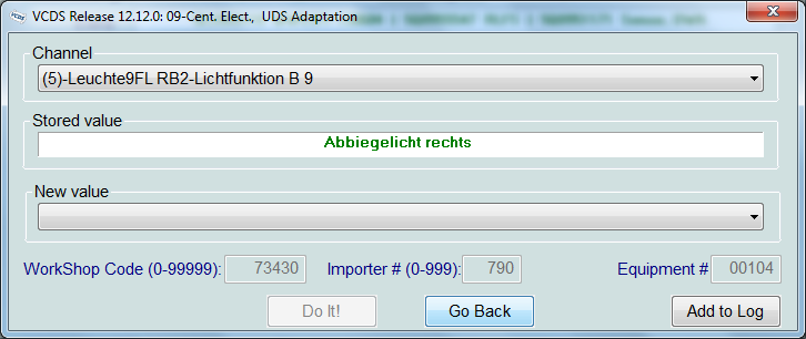

Sorted it - there are another 2 adaptation channels for the vRS for the additional bulbs - I'll update the first post, but the additional 2 are below. Tested with CharleyB today and works (as long as I don't set his foglights to be dimmed headlights LOL and then wonder why they don't go off !!!)
Thanks for your time today Andyvee, very interesting afternoon. Very impressed with your knowledge of German (minus the dimming light episode). Cornering fogs enabled, tilting passenger mirror activated when selecting reverse, auto close on the windows when it rains, and the last drops wipe function activated for the front and rear wipers. Very happy, thanks again.
