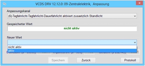

Rear lights on with DRL:
Select STG 09
Login -> Function 16
logincode 31347
STG aanpassing -> functie 10
Kanal (6) - Tagfahrlicht - Dauerfahrlicht aktiviert zusaetzlich Standlicht auswählen
Active klikken
Edited by Antera
The rear lights with DRL annoyed me as the dash illuminated as well, basically it is parking lights enabled with DRL.

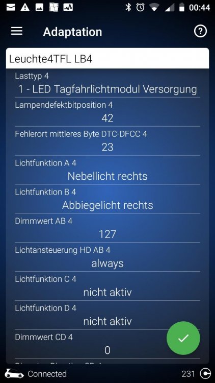

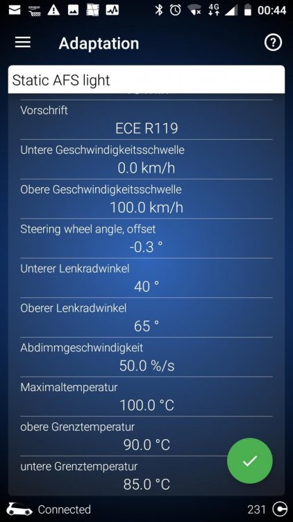

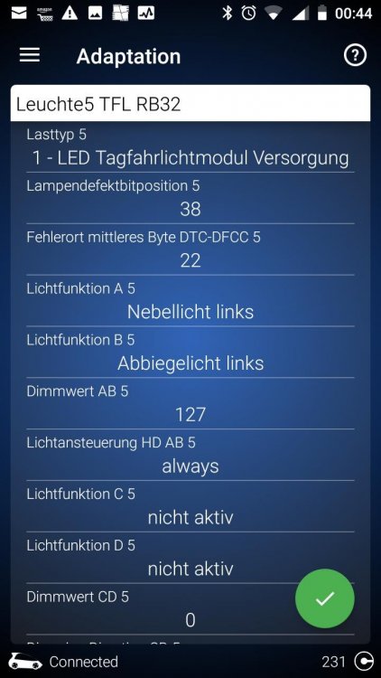

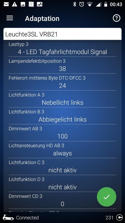

couple of pics for the guides to show both cornering fogs working on an O3 VRS, can confirm the turning head light function also remains with cornering fogs
