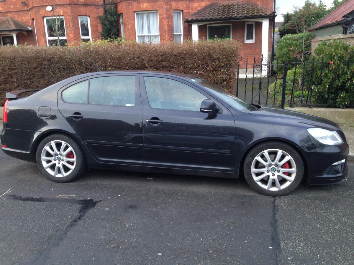

Heres a pic of mine on H&R springs (50mm drop) the wheels are 17's with 225/45 tyres.

I have no issues at all with clearance :)
kit

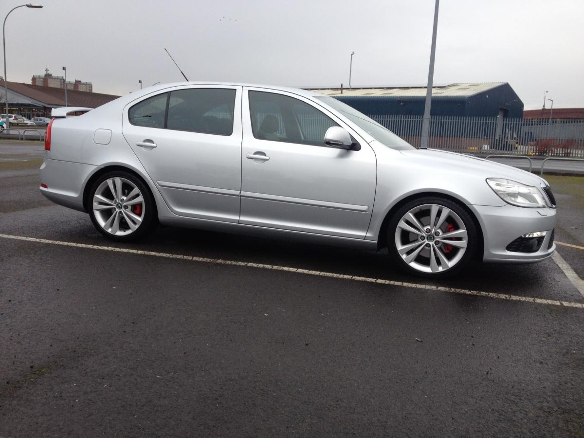

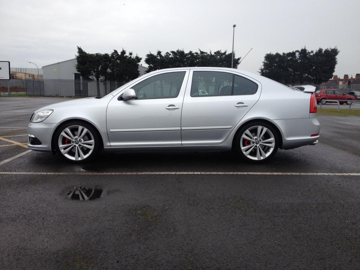

Got some pictures after a rushed salt wash off springs need to settle the ride is as standard you just feel it firm up when you start cornering. Had the alignment done and xenon adaption all is good.
These are the H&R low version 45-50mm. Taking into account the VRS factory drop of 15mm. There is a subtle 30-35mm drop just appears that little bit more than the Eibach version.
Happy with the results and great service from Awesome.

That does look good. Any grounding or wheel rubbing probs?
No problems at all .
