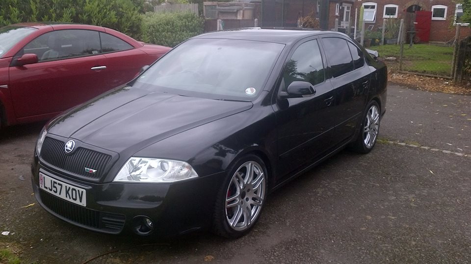

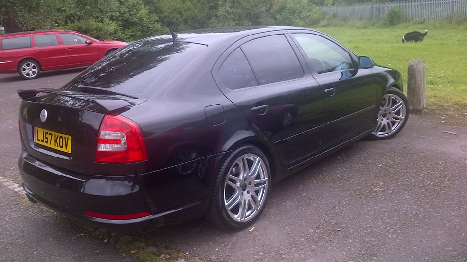

On my FL it went from this
Uploaded with ImageShack.us
to this
Edited by alberg
