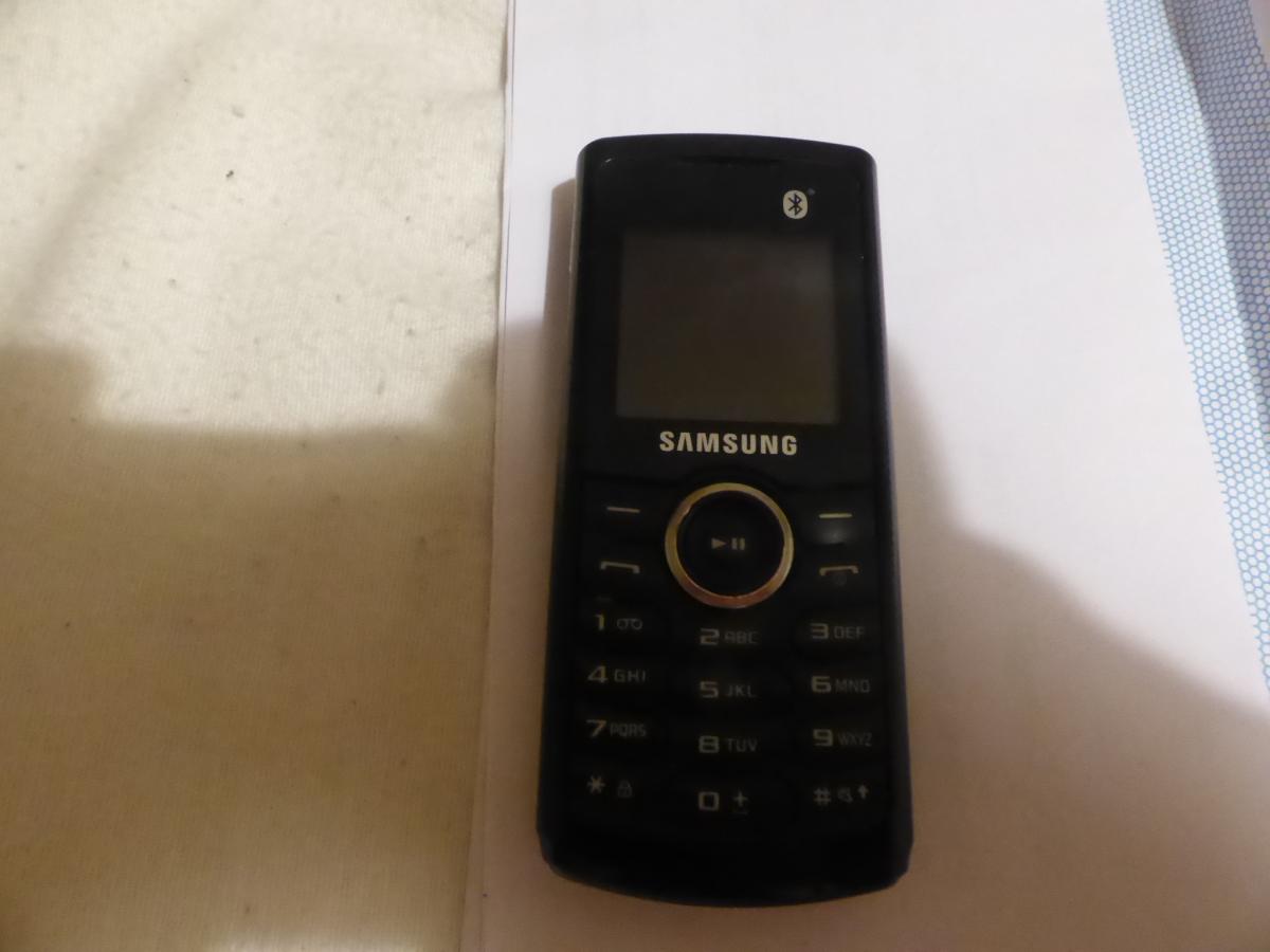

This is the mobile. If it makes a difference. Im guessing the car doesnt like something about this mobile.
Holy **** it's got buttons! :D
its the phone, it only has limited bluetooth ability which is designed to connect to headset. You need a more feature rich phone that supports the required bluetooth protocols.
Yep. What Mannyo said.

Nokia tend to support all Bluetooth functions, even on their basic phones (including RSAP). Samsung are one for cost cutting and limit the functionality on their basic phones.
