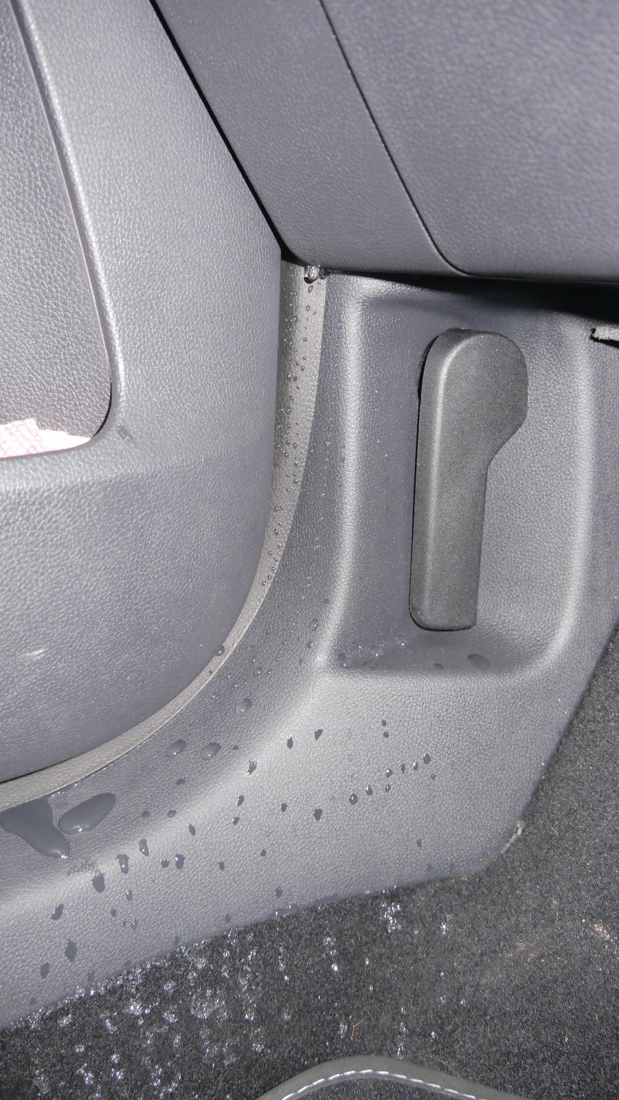

I too discovered a water leak, but on the passenger side and come to think of it just before Christmas I had condensation on the windscreen which I do not normally have.
Mine goes into Lookers Stockport this Monday to resolve. I've attached a photo which actually shows a drip if you look closely. I did have the sunroof 're-set' this Autumn as it was found not to have been installed correctly, wonder if this is related! I will let you know the outcome.

Same as mine. Dealers have failed once to sort it already. Might give them another go. I think it's the connection to the drain as per the topic about leaking rooves pinned in this section.
I wouldn't have another with the sunroof.

We have just had a soaked passenger footwell in an 8 month old sunroof Yeti. The local dealer found that the sunroof drain tube was badly kinked (this must have been done during assembly) towards the bottom where there is a reinforcing tape on the tube. Replacement tube fitted. Hopefully this has sorted it.

Just to update you on my recent water leak, Lookers in Stockport said they were aware of this as a known issue (as others have posted) which was due to the drainage blockage from the sunroof and was quickly fixed within the day. Just have the floor mat to dry out now.
