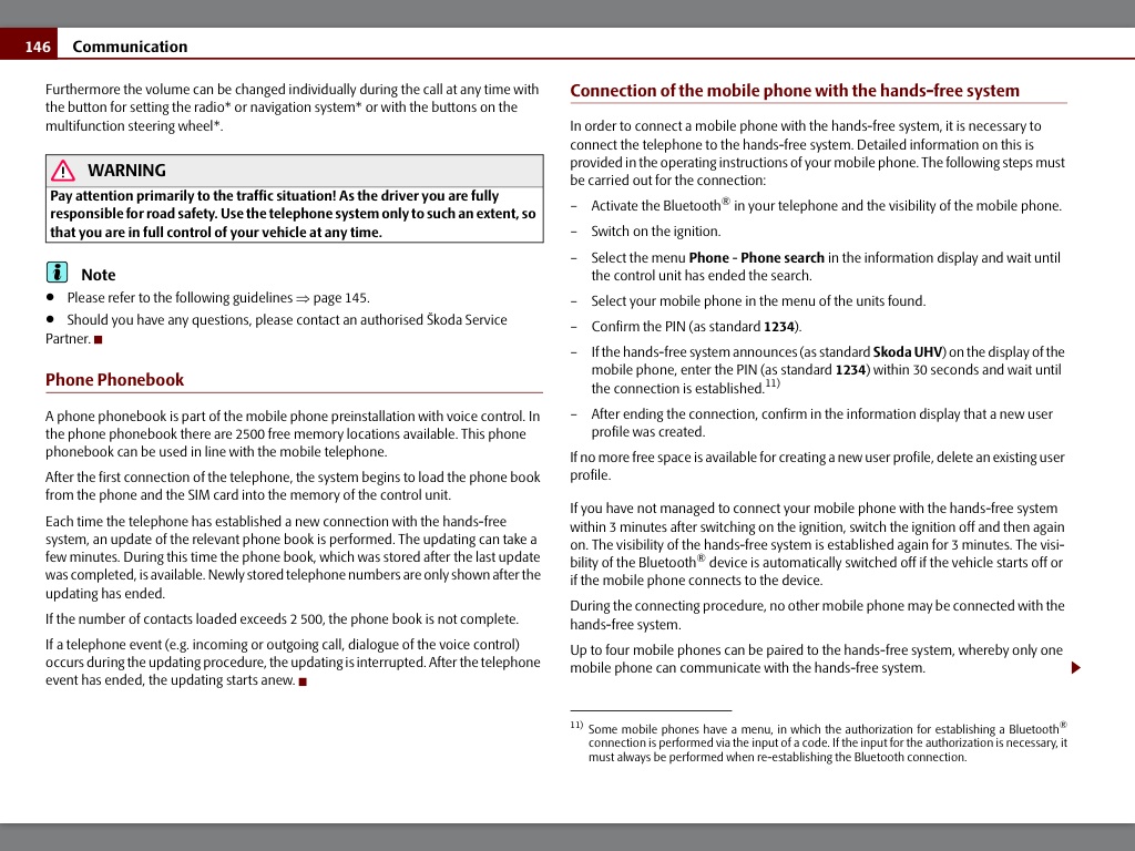

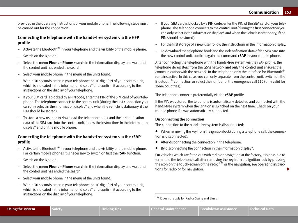

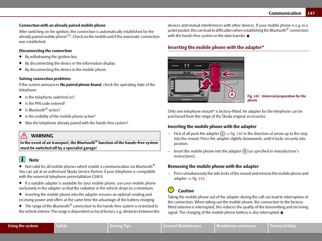

To add a phone see manual...see below attachments.

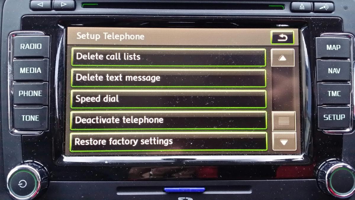

Having had a play with the unit today it is:
setup > telephone > scroll down to factory restore factory settings.
See below screen shots ...

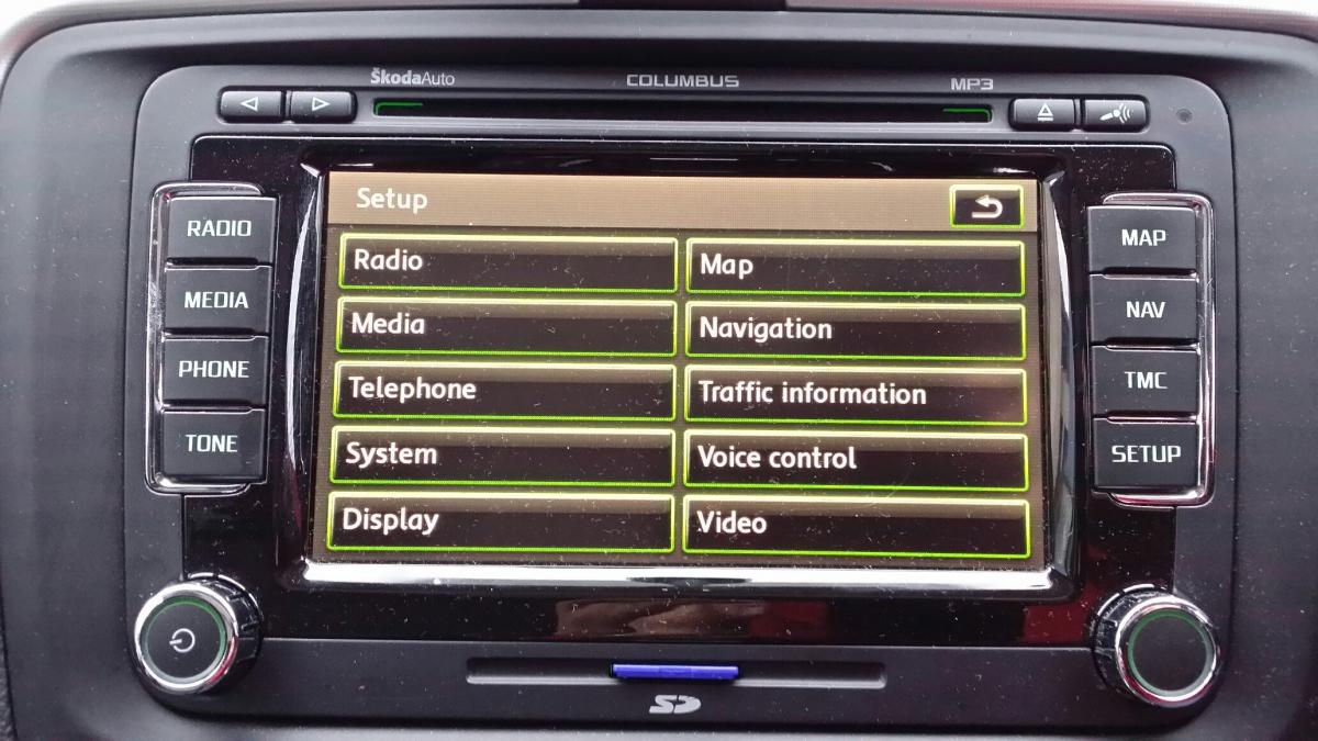

Slight difference on my Columbus in third button down on right is marked "Traffic" rather the "TMC".  I wonder if this means a different head unit?
Gone into setup and telephone but only have three choices: update phone book, delete call lists and speed dial.  The other two are not there at all (not even greyed out).

I'm not too familiar with Samsung's but can you unpair the phone from the car (on both the car and phone), disable rSAP in the phone's Bluetooth connections menu and then try connecting it using HFP?
You can unpair any phone, but I think it needs to be connected before the option to unpair is available, unless you reset to factory settings. Although the latter option does not appear to be available on your unit from what you have said.
I don't know if it is possible to disable rsap and connect via hfp - beyond my knowledge if it is possible.
I'm on my second Samsung and I can't find any option or section for RSAP in settings. When it connects to the car Bluetooth it just connects automatically via RSAP and a message appears in the drop down phone menu that I have connected via RSAP.
