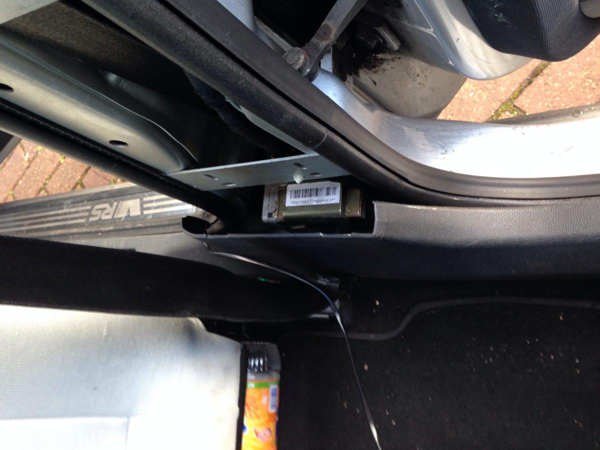

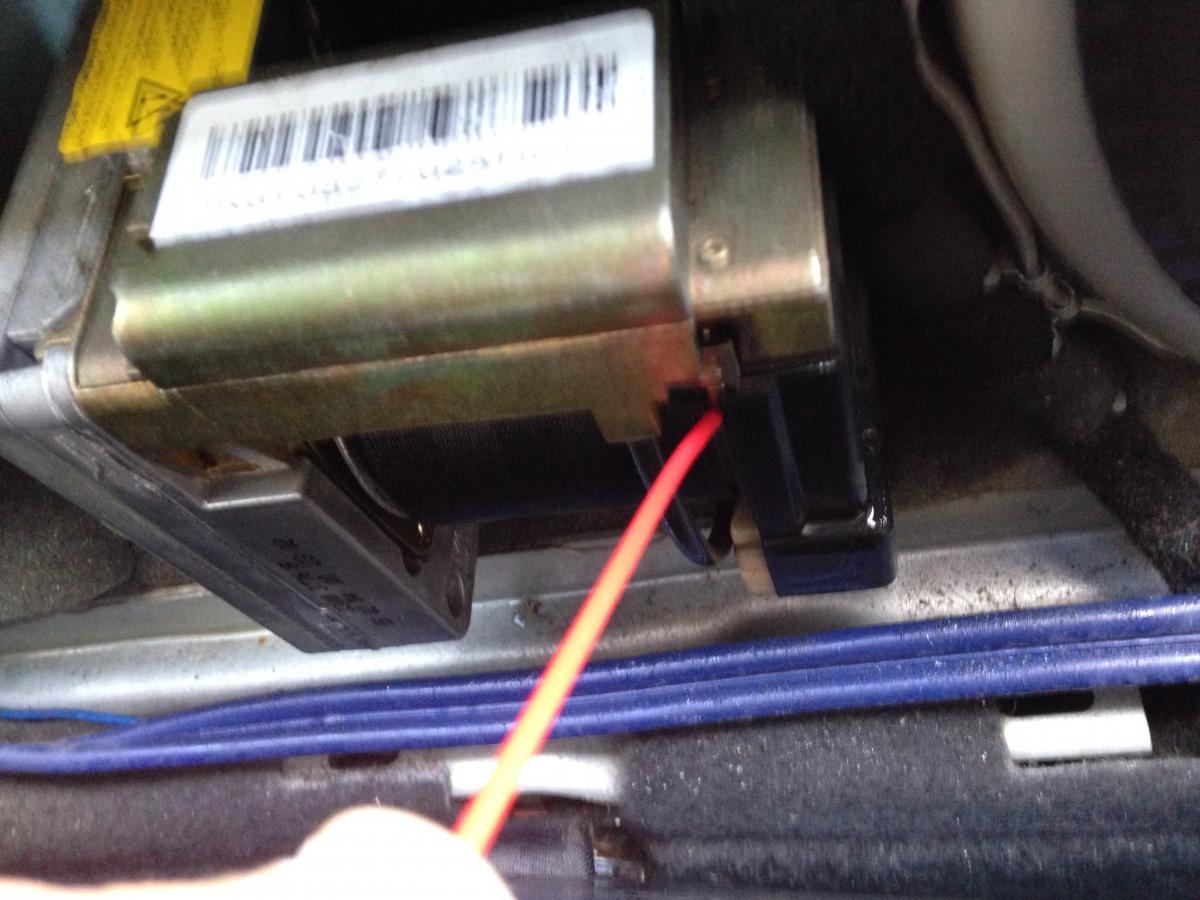

Right, after 2 hours I've fixed it this afternoon. The roller mechanism needed lubricating.
1. Loosen top panel, remove middle panel, loosen bottom panel. Top and bottom panels don't need completely removing IMO as you can access the required area.
2. The seatbelt mechanism will now be exposed. Spray WD40 to the side parts of the roller.
3. Pull seat belt in and out, spray more wd40. I repeated doing this 3 times
4. Replace all panels (can be a pain, just keep at it) fix bottom part, then middle, then top, be careful of the fixings as they interlock/overlay)
Difficulty 3/10
Satisfaction factor 10/10 :-D
Feels like new again now

Brilliant, thanks for this, you've spurred me on to do mine. They have never retracted properly ever since I've had the car.
You're welcome :-)
I thoroughly cleaned the belt, got the old hair dryer out (to dry up potential damp), nothing worked. Had me head scratching for a while. Then the penny dropped and out came the wd40 haha
Yeah it retracts viciously now! Love it!
Cheers for this!
My passenger front belt has been getting worse and worse recently to the point that it was now just not retracting any of the belt at all.
Gave this a go yesterday and it now works perfectly! Thank you!

Thanks for posting...I'm trying it right now! Any issues at all afterwards? After the quick lube job, will the belt be as safe as before it was playing up?

Hi mate, mines still running like new, no issues at all! : )
Quick update: Just finished. No chance of correctly getting the trim panels back properly tonight (will try again with more light after work tomorrow)...but, the belt appears to be much better! I did the old silicon polish trick and lubed the belt as shown in the pics above. I "simulated" a very quick stop by lurching forward and it did work. One important factor of course is the seat back angle...too far forward and the belt engages on the next available "notch", so tilting it back to a more relaxed postion seems to reduce your forward travel in the event of a sudden stop. Hope I can get that darn middle panel back tomorrow ;)
