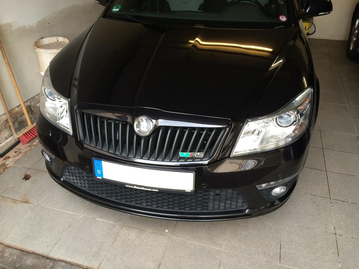

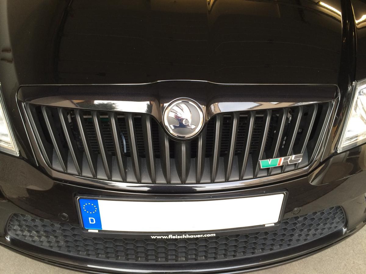

I can of plasti-dip in a rattle can sorted mine.  I prefer the matt black finish to the chrome but it's easy to peel off if I ever need to revert back.  Also changed all my badges to the latest chrome on black and I think they look better than the originals (though the photo doesn't do it justice). :hi:

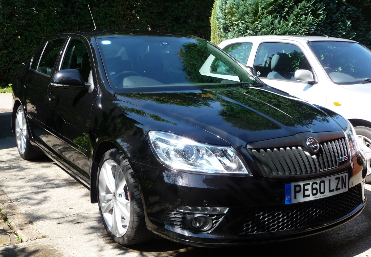

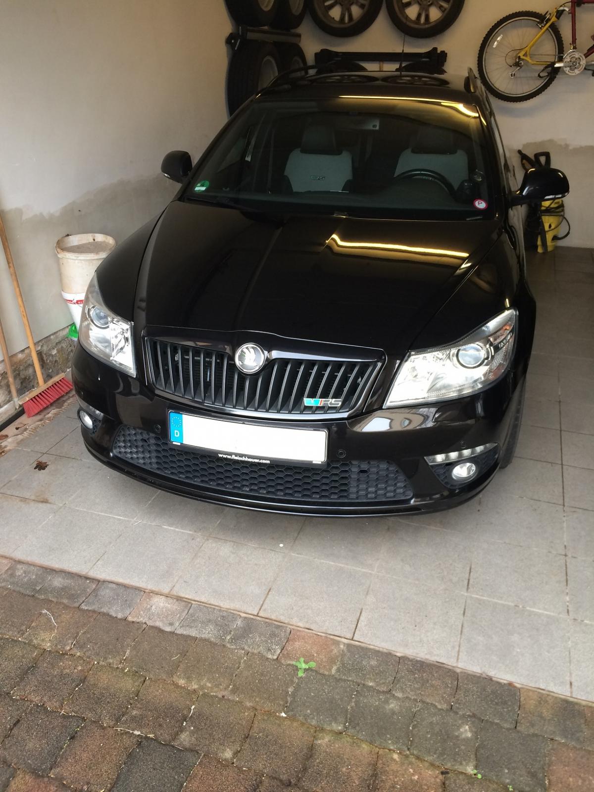

Ok job all done and I must say very happy with the result. Thanks to everyone who replied to help me out.
Some pictures below :rofl:. It does look like the grill is a different shade but it must me the light as it looks fine in person.

Looks a lot better than chrome very nice job there.
