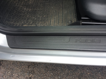

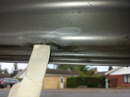

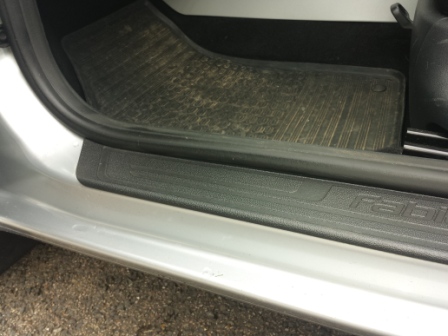

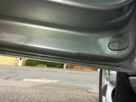

It rained hard last night so I conducted a little experiment and took some pictures.
SWMBO’s Fabia2 was parked on the flat. Water poured out of the drain holes located at the front both passengers and drivers doors when the doors were opened.   The following was noted:
(1) All three drain holes at the bottom of each door were clear.
(2) There is no rubber seal located at the bottom of the doors themselves. I think the attached photos illustrates this.  (The piece of paper stuck in the door drain nearest the hinge is just there to show where the drain hole is located).
(3) The angle of the doors to the horizontal plane (ie the door was level) means that the water probably had not collected at the foot of the door. Otherwise I would have expected to see water coming out of all three drains.
I then had a look at the Octy which had been parked facing downhill. As you will be aware the Octy has a completely different door seal arrangement to that of the Fabia, and there is a seal actually located at the bottom of the door which covers the drain holes.
Opening the passenger door resulted in water pouring out of the drain hole located nearest to the door hinge. Gentle finger pressure on the door seal (as if the door were shut) stopped the water flow completely. The drivers door was the same.
Finally the rear doors were opened on both the Octy and Fabia.  No water was seen.
So what conclusions did I draw from this unscientific exercise?
(1) The door seal on the Octy may be exacerbating the situation, but is probably not the primary issue. Cutting holes in the seal is therefore unlikely to resolve the issue.
(2) The fact that the water only appears to ever come from the front drain holes (irrespective of the angle of parking) is suggestive that water may be reservoiring higher up the door toward the window aperture, is disturbed by the door opening, and then channels down the inside of the door toward the front drain hole.
(3) The fact that some vehicles do it and others do not, could be attributed to the window/door seals being better fitted in some cars and not others. Water will always enter all cars at this point as the seal can never be 100% effective. But those with poorer seals at this point will experience a more rapid increase in reservoiring.
I mentioned issues with the Fabia1.  The problem was constant electrical niggles which were eventually traced to the card in the driver’s door. The cause was the build-up of water that area of the inside of the door, and I believe this was a very common problem with the Fabia1.
Sorry about the length of my ramble but hope this may help. This has been a very long standing issue which I think might only be resolved by somebody removing their interior door panel, hosing water on the window/door seal area and then observing what is actually happening inside the door.

Sorry - missed a picture.
I would also add (if its not obvious from the pictures) that the drain holes on the Fabia are always uncovered and free to drain - there is no door seal covering them.
