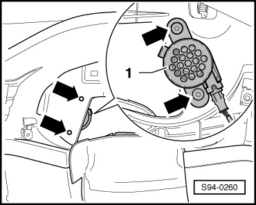

Thanks again. I'm wondering if maybe it's a different model variant? Rivet holes are there but definitely no buzzer. See attached.
Superb Mk II Behind instrument panel
Is it possible someone has replaced in the past?
It's a little awkward to secure the sounder back in place, maybe they have pushed it into a different location?.... limited by the wiring.
.... Take the steering column covers off to locate?

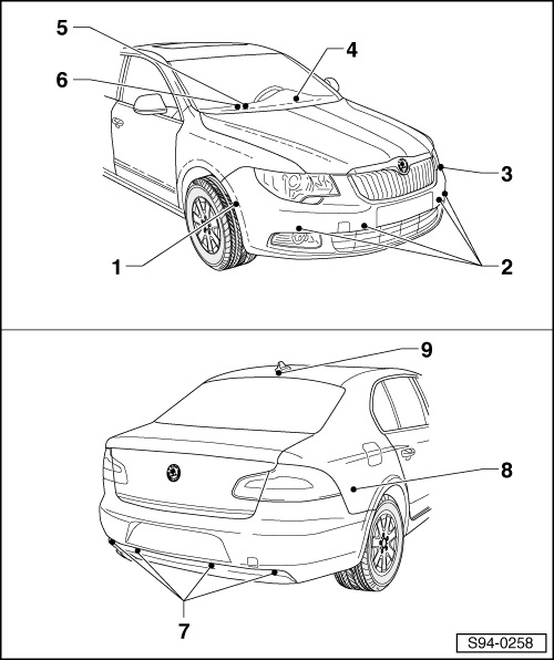

Just checked up... There are two locations noted...
One for the H22 version and one for the H15 version... no idea why there is a difference...
H15 Version...
"Remove rear moulded headliner → Body Work; Rep. gr.70 and carefully unhook a little towards the bottom.
– Slacken and remove button rivets -arrows-.
– Disconnect plug -1- and remove warning buzzer"
Hopefully this helps

Location resolved !......
4 - The warning buzzer for the front parking aid -H22-
q behind the dash panel insert
9 - The warning buzzer for the rear parking aid -H15-
q at the rear in the centre under the moulded headliner
Thanks for that - much appreciated. I have not taken the headliner off yet but was able to get sufficient access to the buzzer socket terminal from the back. Put a large 50Ohm resistor across the contacts and parking sensor was back again. Will buy part and replace. Many thanks again.
