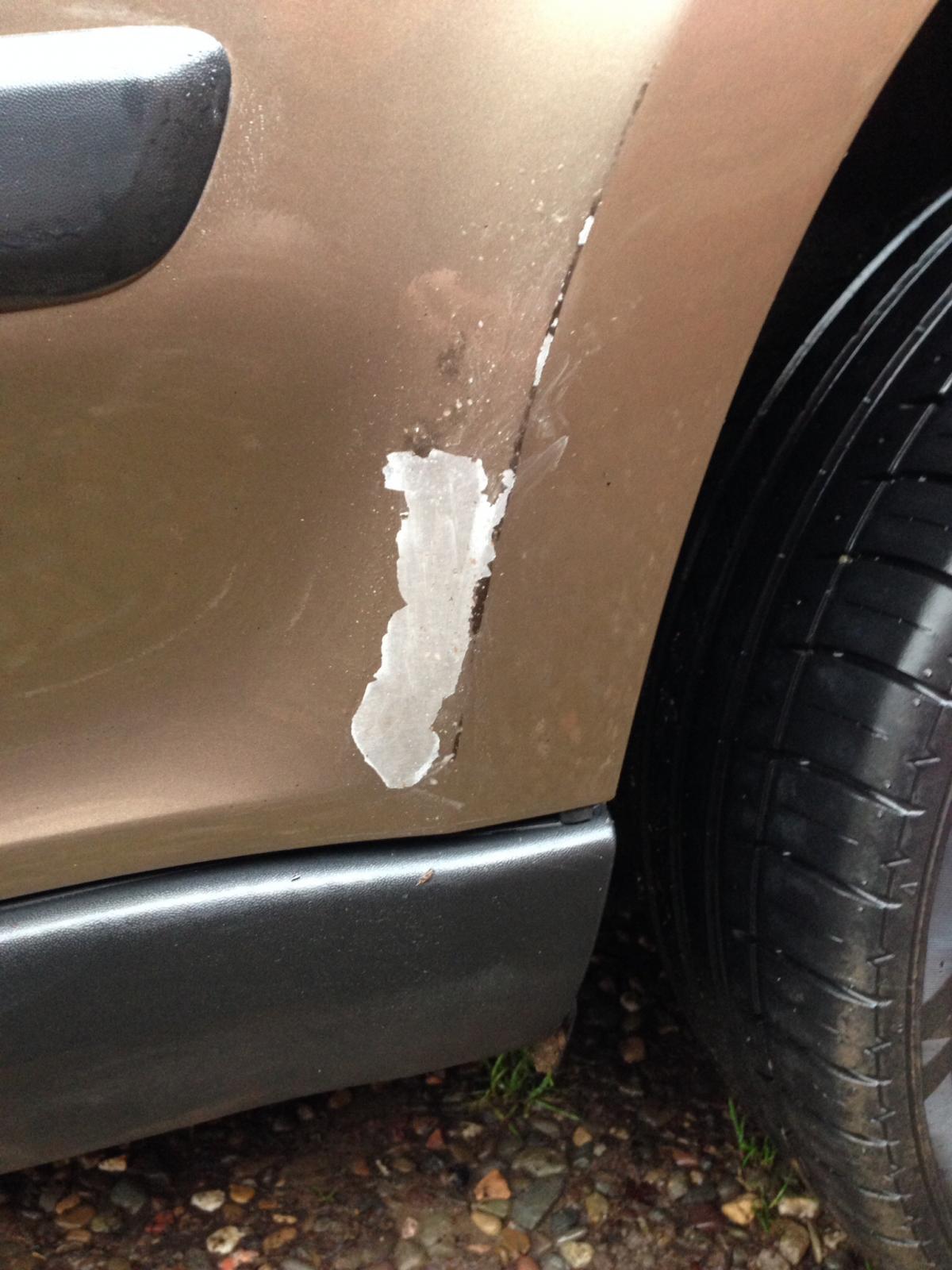

My 2010 corrida red Yeti was delivered 15th February 2011 - it was built in December 2010. In the summer 2013 I discovered dozens of tiny blistes on all four doors - all but one or two under the protection rims.
The scratches in the middle was made after discovering the blister. It is interesting to note the smaller child blister at the lower rim of the big one.
The diameter of the chipping is some 0,3 mm!
Again another example. The diameter of the blisters are 10 to 12 mm.
