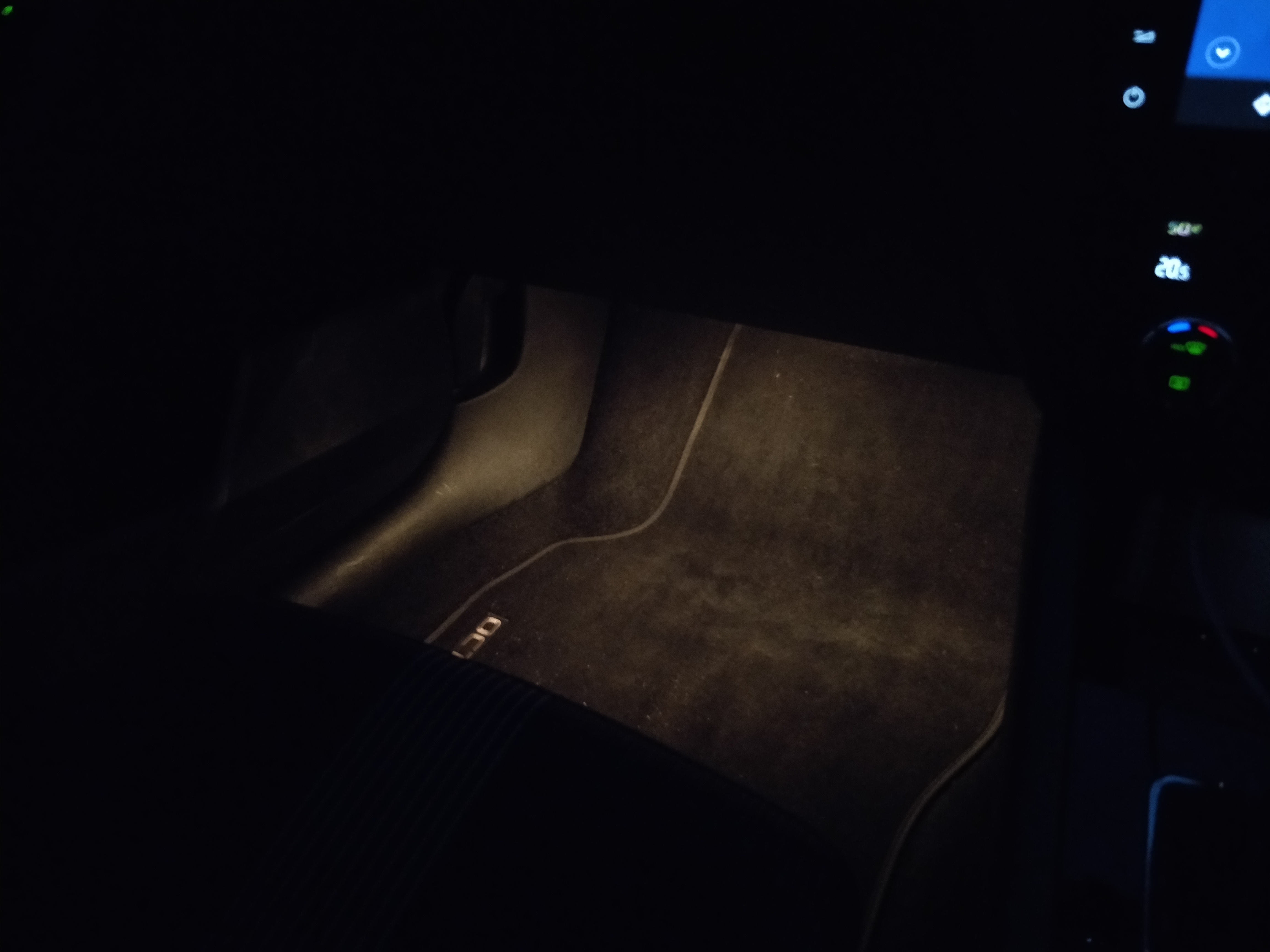

Thanks, apart from colour would you say they are brighter than the halogens?
I didn't try it with the halogens. I uploaded a couple of pics in my post last night and that was with them dimmed to about 20%. At 100% they were incredibly bright.
I also grabbed a daytime pic of the unit with the Osram bulb in to show what I meant about the light not filling the unit fully. Won't let me upload unless under 0.11mb though :blink:

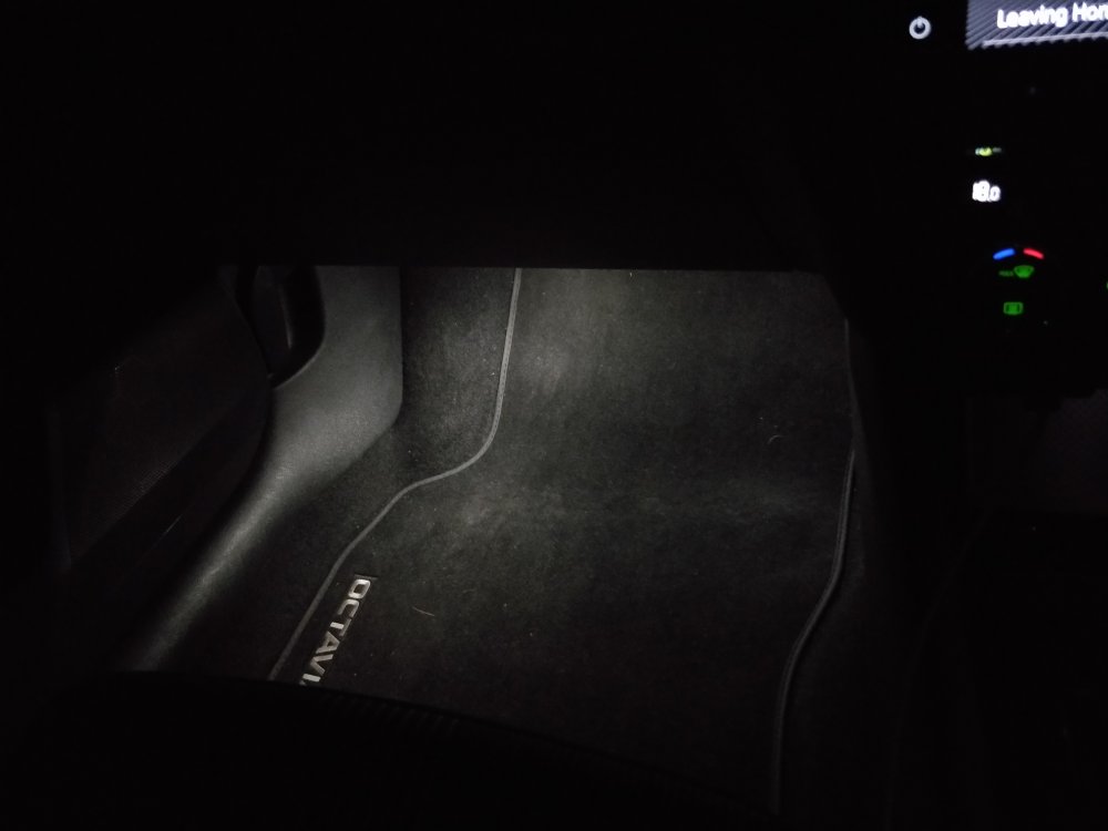

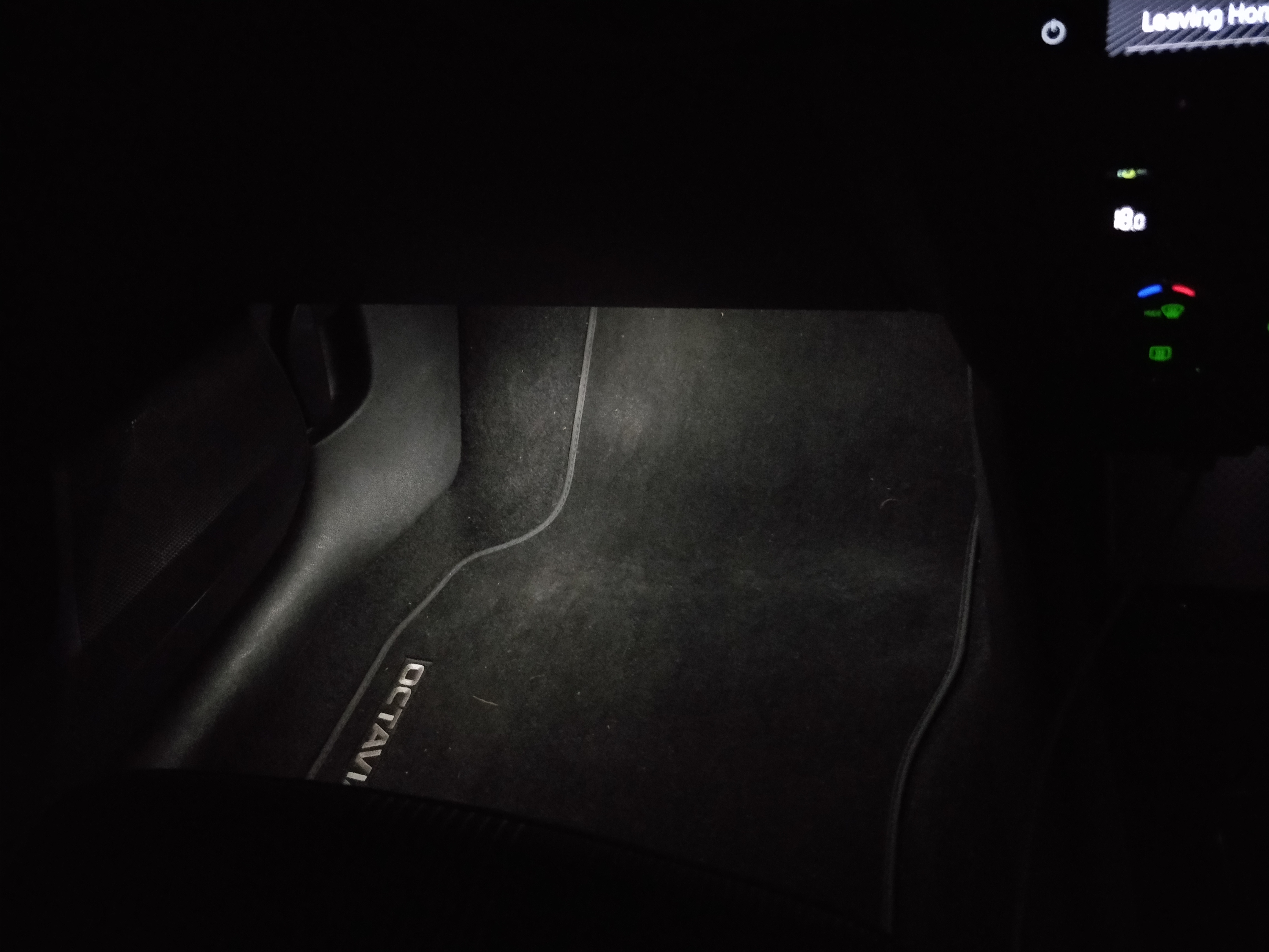

Bulbs arrived today. Just fitted. Were a bit fiddly. Had to realign the housings a bit so the new bulbs would make proper contact. Front left was hassle as didn't leave enough slack when fitting to disconnect. Looking forward to dark to see difference.
Not quite dark yet but nearly there. Much happier with the brightness. The other big plus is that the led bulbs don't run nearly has hot as the halogens they replaced. I was surprised how hot the housing and plastic got with the old bulb. Will take a few pictures when I get a chance
Thanks,
Mick
Thanks,
Mick
Top picture is led bottom halogen
