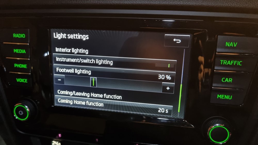

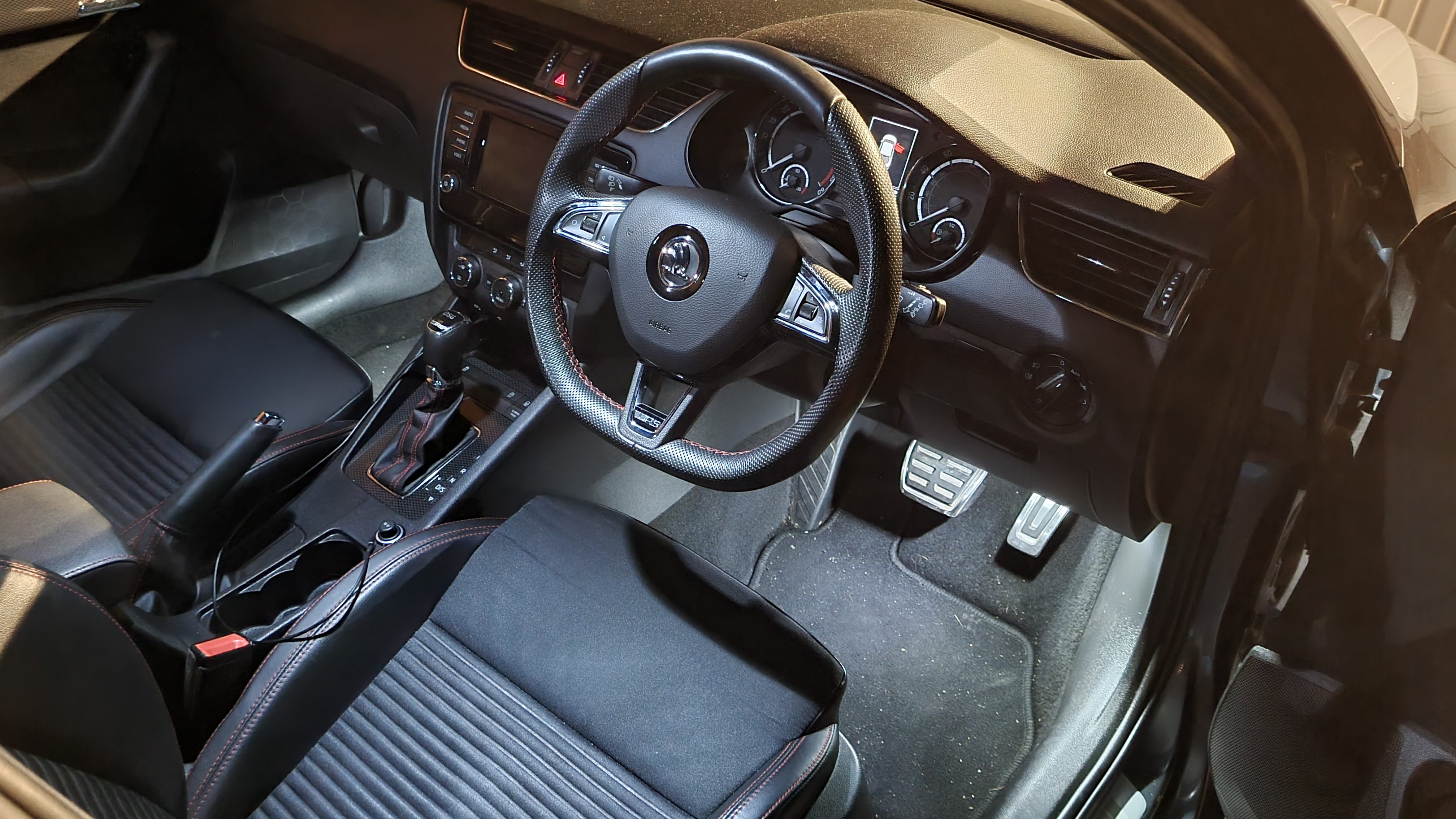

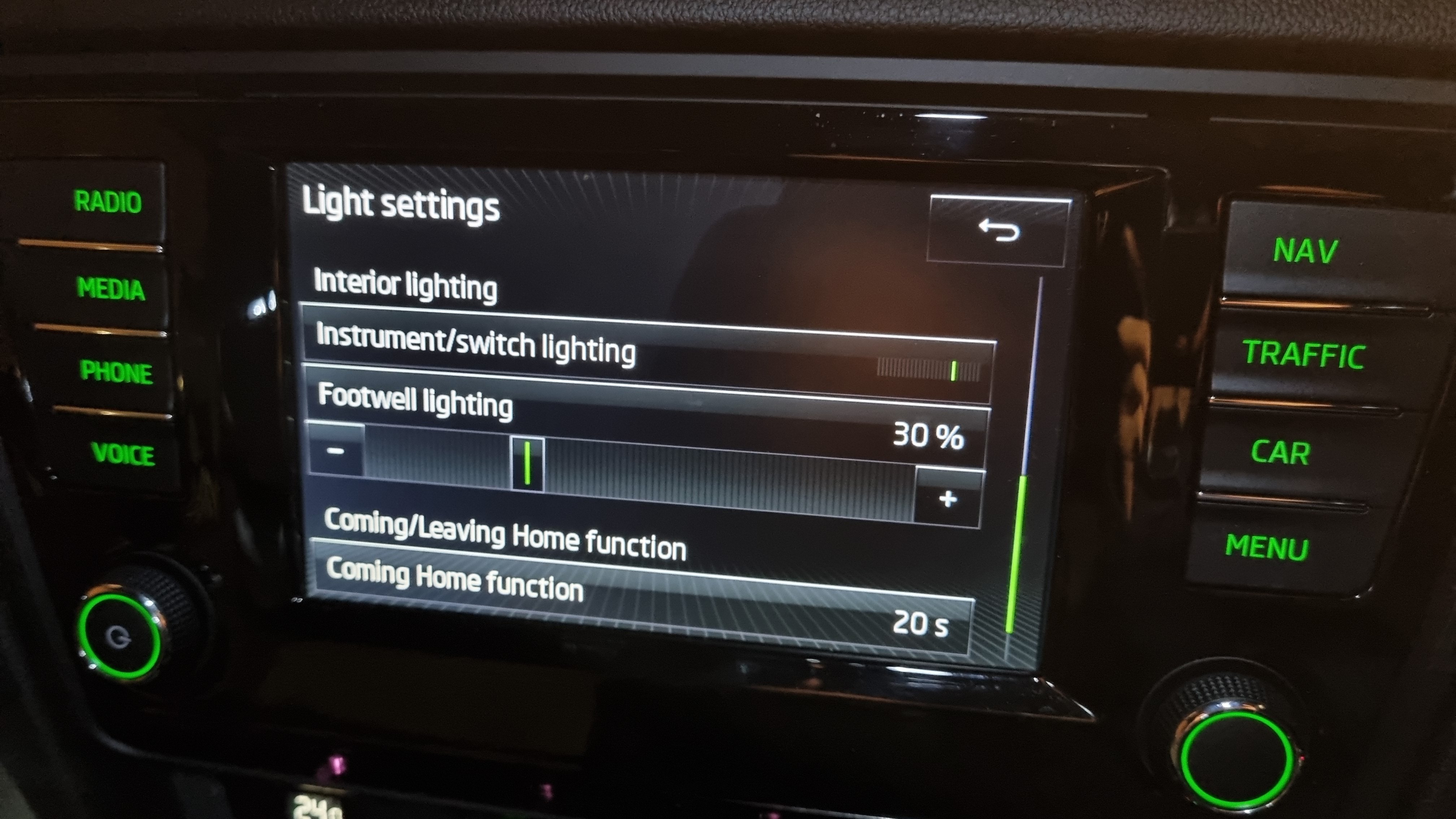

    Success!   Finally got the footwell lighting retrofit fitted, coded and working fully. They come on 100% with the interior lights when unlocking the car – the same when the doors are opened and are
  • A few pics to help installation, carrying on from the hard work done by STEVEB
  • Well done on working it out!   I'll copy across to the O3 VCDS thread BUT I can't see your screenshots for some reason???   And get your profile changed to VCDS expert LOL

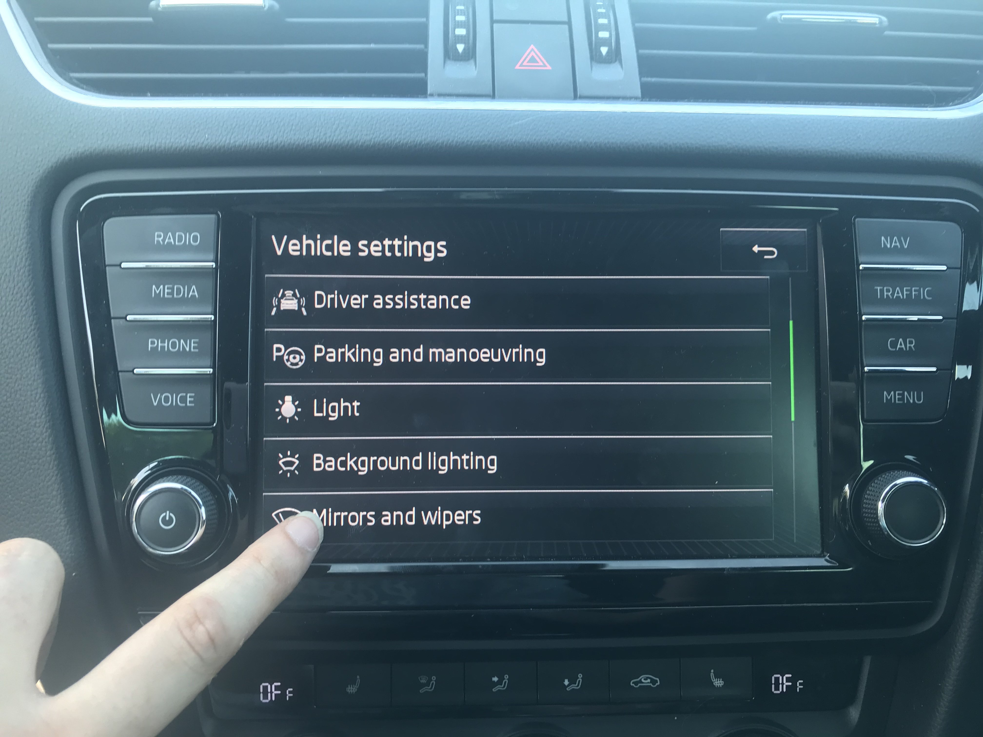

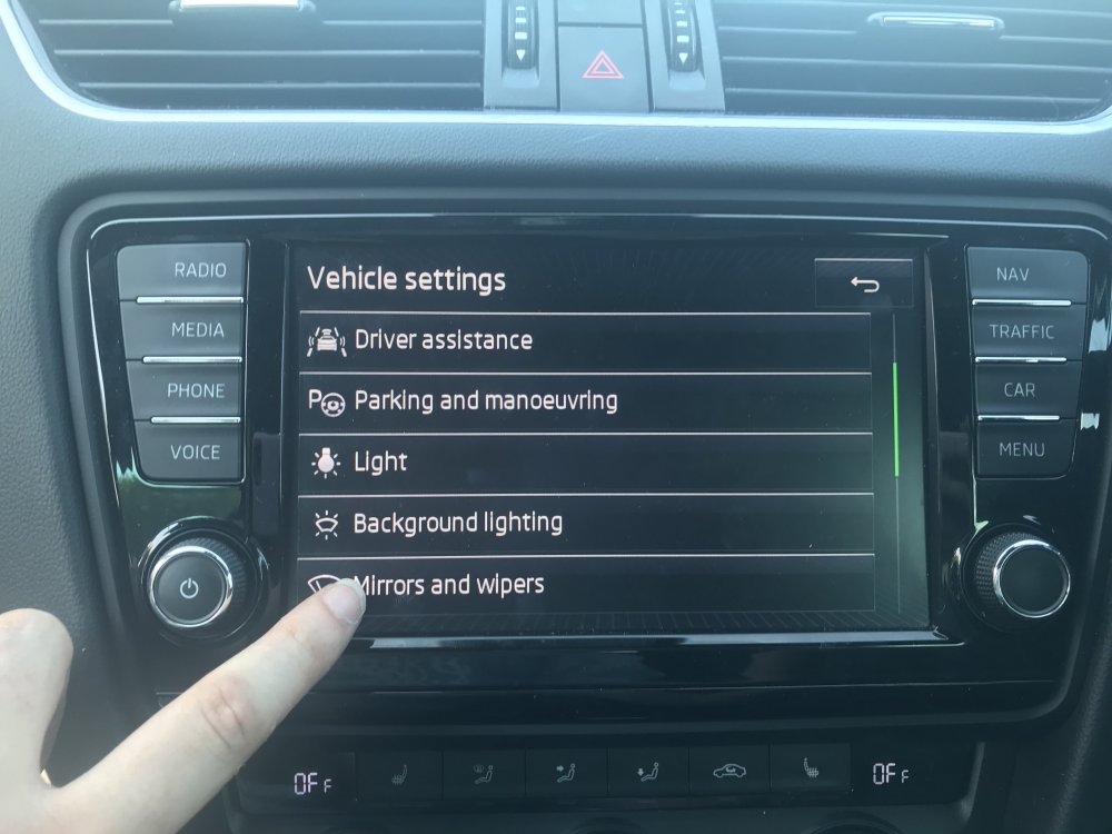

@SashaGrace do you not have anything under light -> interior lighting -> footwell lighting? That's where my slider adjuster is on MIB1. I know you have MIB2 now though...
It's the same with both mib1 and 2.
Nope, nothing comes up. The slider doesn’t get added, only that menu. It isn’t the end of the world as I’ll set the brightness value directly if I have to, but it’d be nice to have the option on the radio.

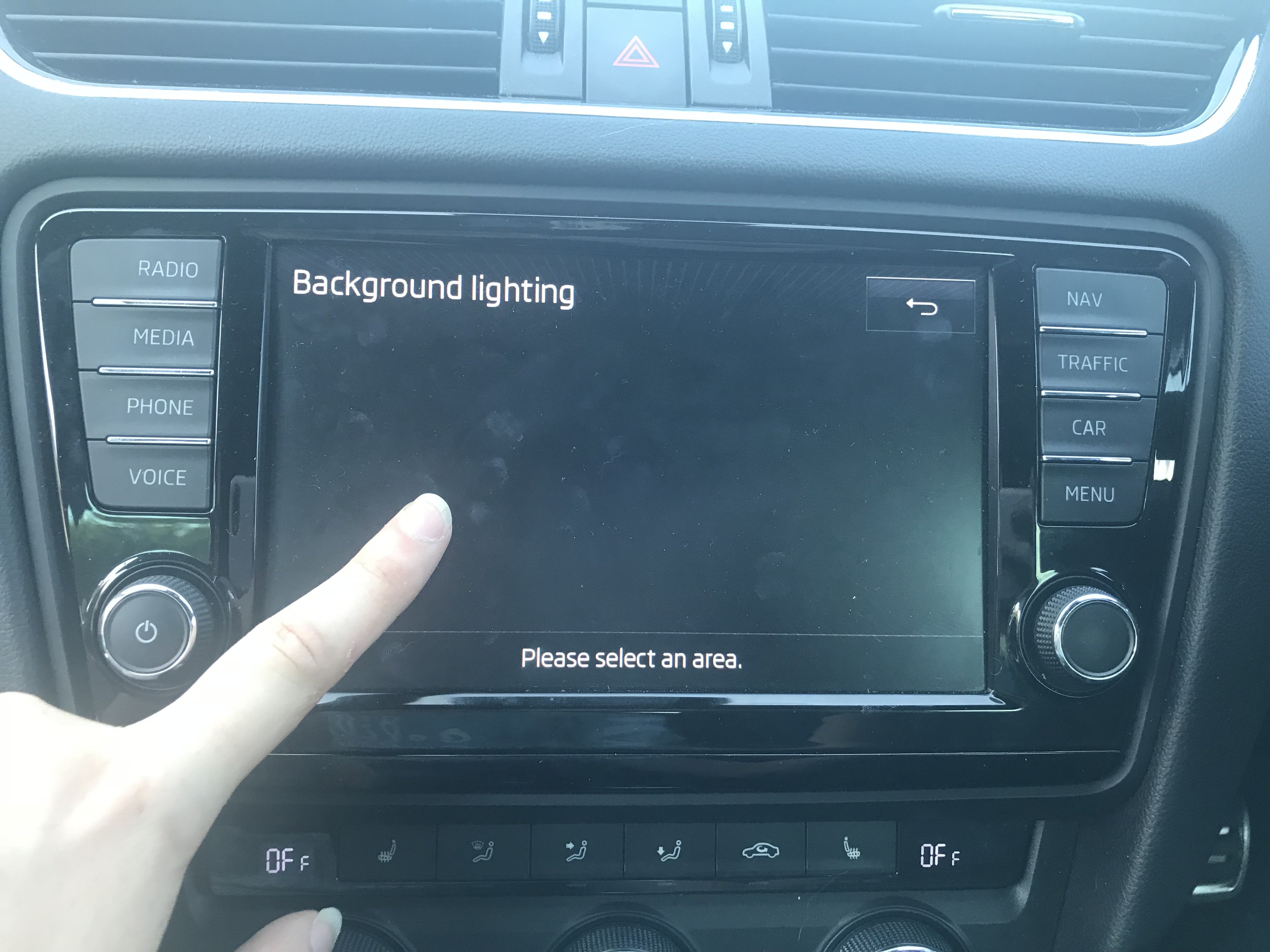

On ‎13‎/‎07‎/‎2019 at 13:28, SashaGrace said:
Kind of. New radio has a new diagram but the lights aren’t correctly adjustable. They aren’t even correctly fitted tbh. I never got around to it!
Like you I have come from MIB1 to MIB2. But my lights where fitted before I upgraded, and I had the slider on screen.
But after the upgrade, I just get the screen showing the cabin, and asking me to select an area. Problem is there are no areas I can select.
Think there may be some more coding required.
Mine has always been like that. It should be that, the footwell light should be able to be selected on that menu. I think this is the difficulty with mismatching the newer radio with old BCM firmware. I have an FL BCM on the table ready to go in one day for ambient lighting and key personalisation but I haven’t gotten around to it yet!
