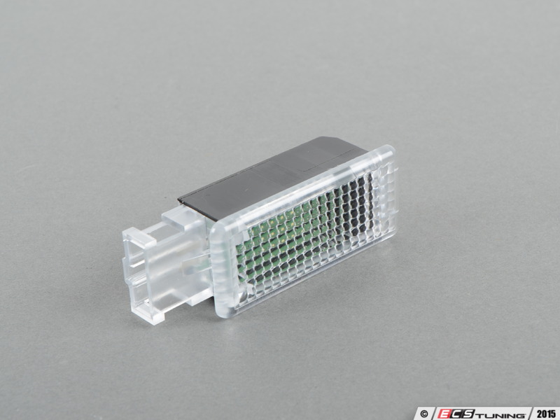

Going to go with the proper VAG units as fitted to the MK7 Golf and MK3 Superb. Part no 5G0947409. Not cheap at £48 for the 4 but I'm particular about this sort of stuff and want it to look fully OEM. These should provide a perfect white light with even distribution.

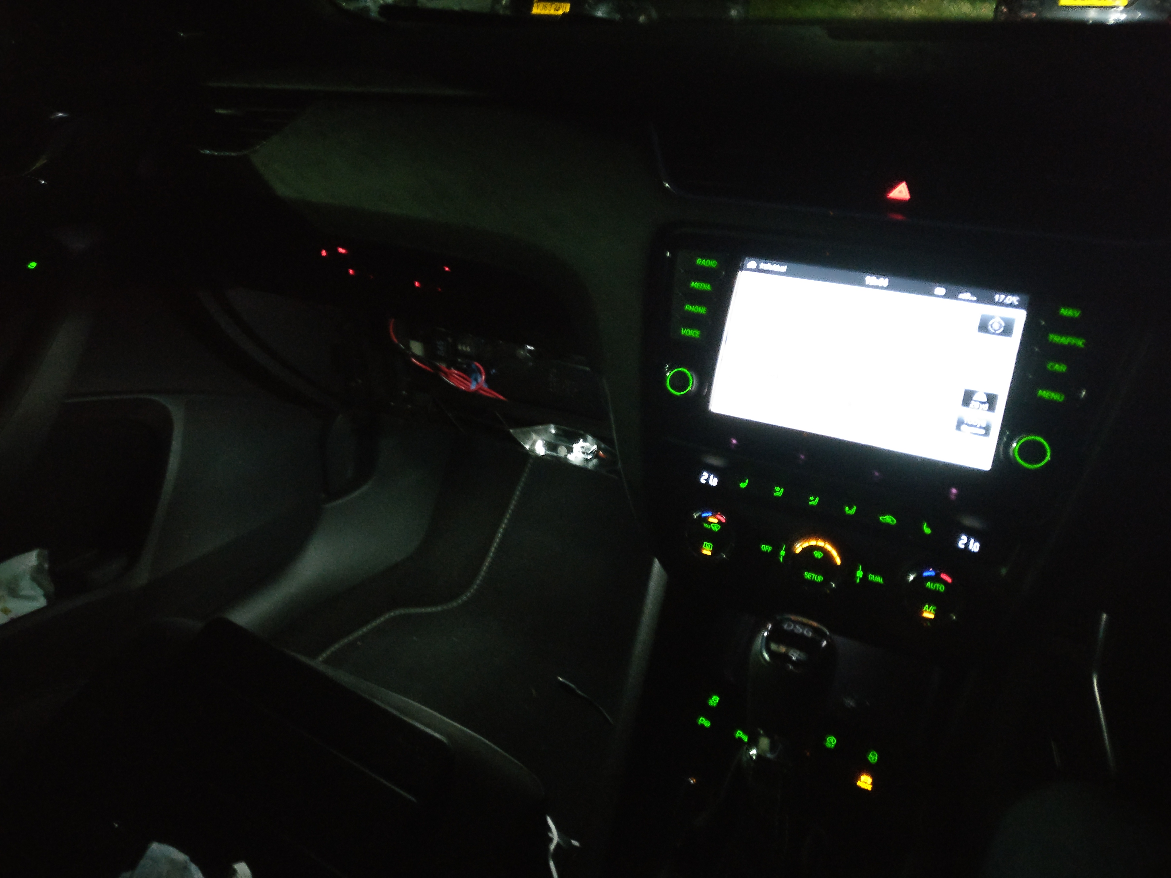

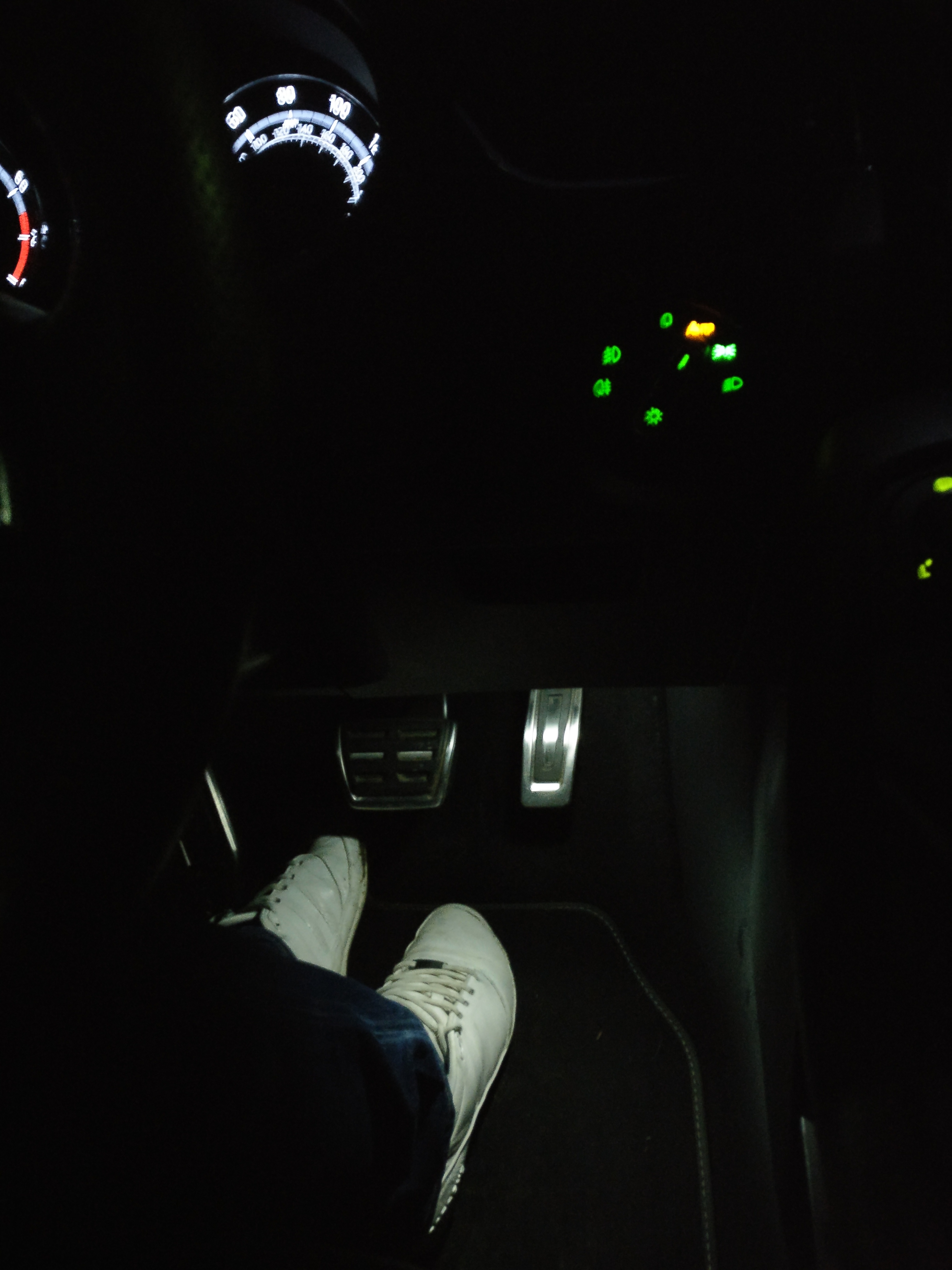

Well after a few hours of effort and cursing, I've managed to do the retrofit. Thanks to everyone who contributed in this thread, in particular posts from; @steveb1970 @panmat @arnold and @Micks_address
Looks great and works a treat dimming in the infotainment. I'm using Osram LEDs in the footwell units and they work well, the light distribution is more even than cheap Chinese stuff (though still doesn't fill the unit completely - this is a limitation in the design of the units I think, the bulb sits very much in one side of the rectangular holder). More importantly though, the Osrams don't flicker at all like some cheap Chinese LEDs do. The colour temp is also perfect - a proper cool white rather than the blue tinge often seen with cheap LEDs. Finally, they are very bright - in the images they are dimmed down to 20% and still quite noticeable!
Haven't yet clipped the glovebox back in - it's dark and pouring down now outside so will do this tomorrow.

Yeah, I'm still torn on whether to get the proper VAG units or not, but I was quoted £48 for those - 4x 5G0947409.
They will definitely have a more even light distribution as they are multiple LEDs across the width of the unit, but I'm not sure the improvement is worth the cost over the Osrams in those units.
