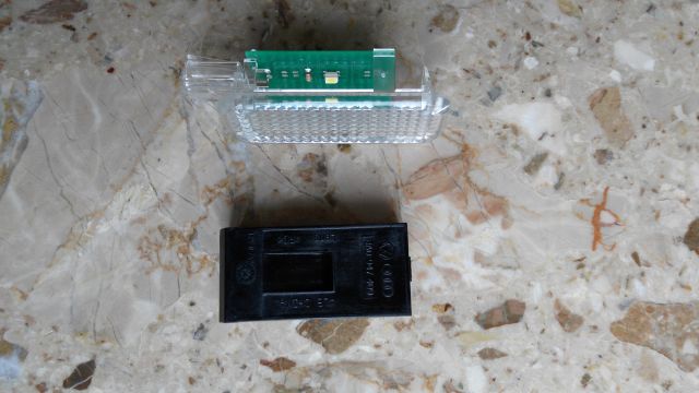

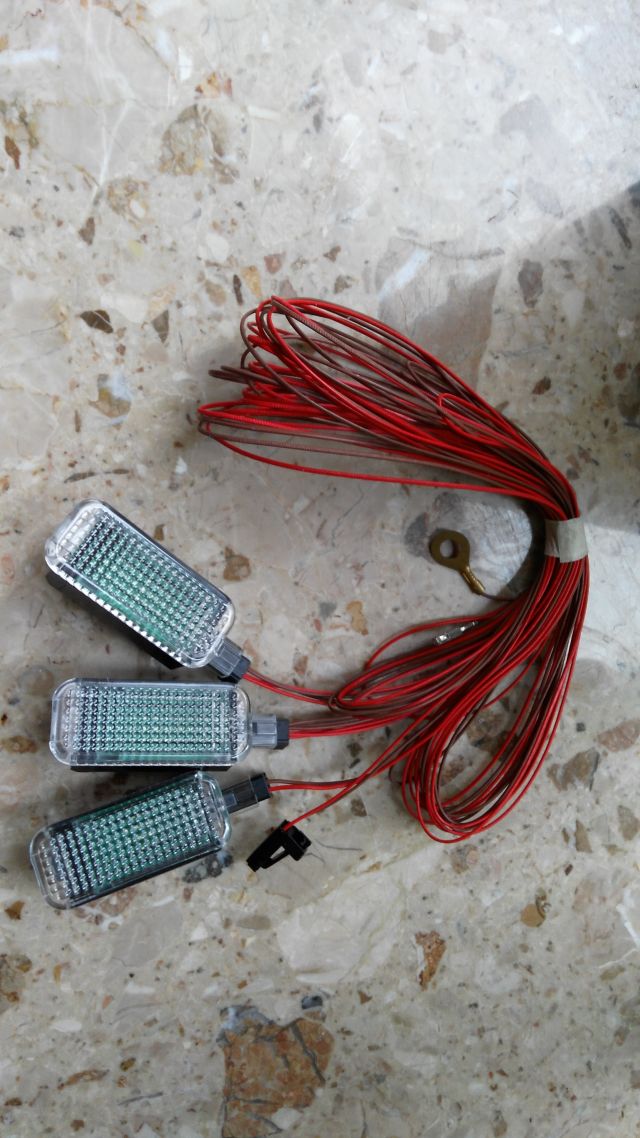

Ok. A few days ago I received my ... cheap Chinese rubbish lamps. Looks good. I will write when I install this one.
Edited by jackfrost
