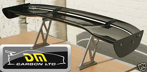

So it is aero foils then?
Cool, about time we had an amphibious Fabia. :)
Haha, it's not aero foils. ... But you are close!
Just realised I meant Hydro foils! :D
BIG difference, would love it to go on water.
But you had part of the right words before :p
