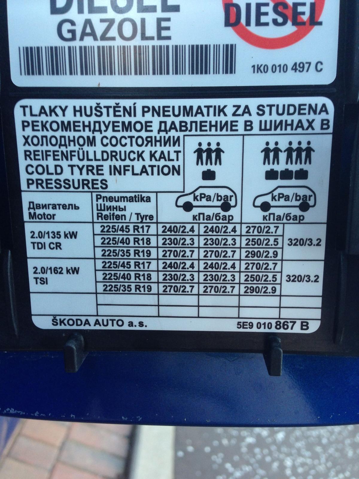

Don't know if it'll help or not as I've got the vRS Estate but I run the 225/40/r18s on mine with 2.3 bar all round, although I've increased to 2.4bar for the winter tyres as get more grip - I'm keeping an eye of the thread to see if it's under or over but apparently winter tyres car be a bit softer an need more pressure.
Below is a pic of my flap ;)
