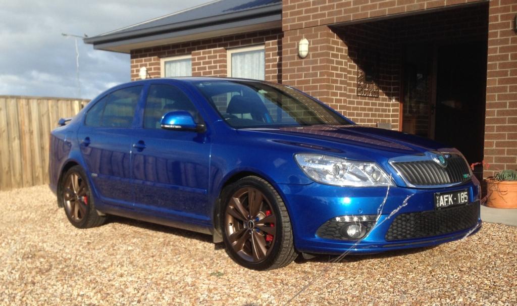

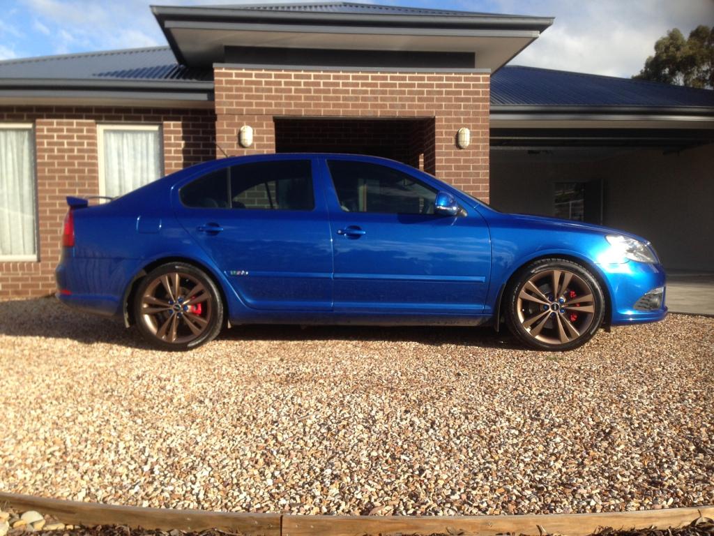

Well the Eibachs are installed and liking the way it looks and drives. I apologise for the standard of the pic.
