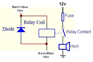

The wire to the treble horn is only 1mm. This is why cars with both a treble and bass horn have a separate wire for each horn all the way back to the CECM where they are connected together.
Most auto electricians would see the small wire and add a relay, but back emf from the relay can apparently damage some CECMs hence the diode across the relay coil. I've drawn out the circuit required for Darren and put it here http://www.s-tech.demon.co.uk/horn.jpg
I have just seen your circuit diagram, what value would the diode be?

As it says in the text "back EMF from the relay can damage some CECMs, hence the diode"
In other words, it stops the relay killing your control module as it switches. Don't ignore this.
