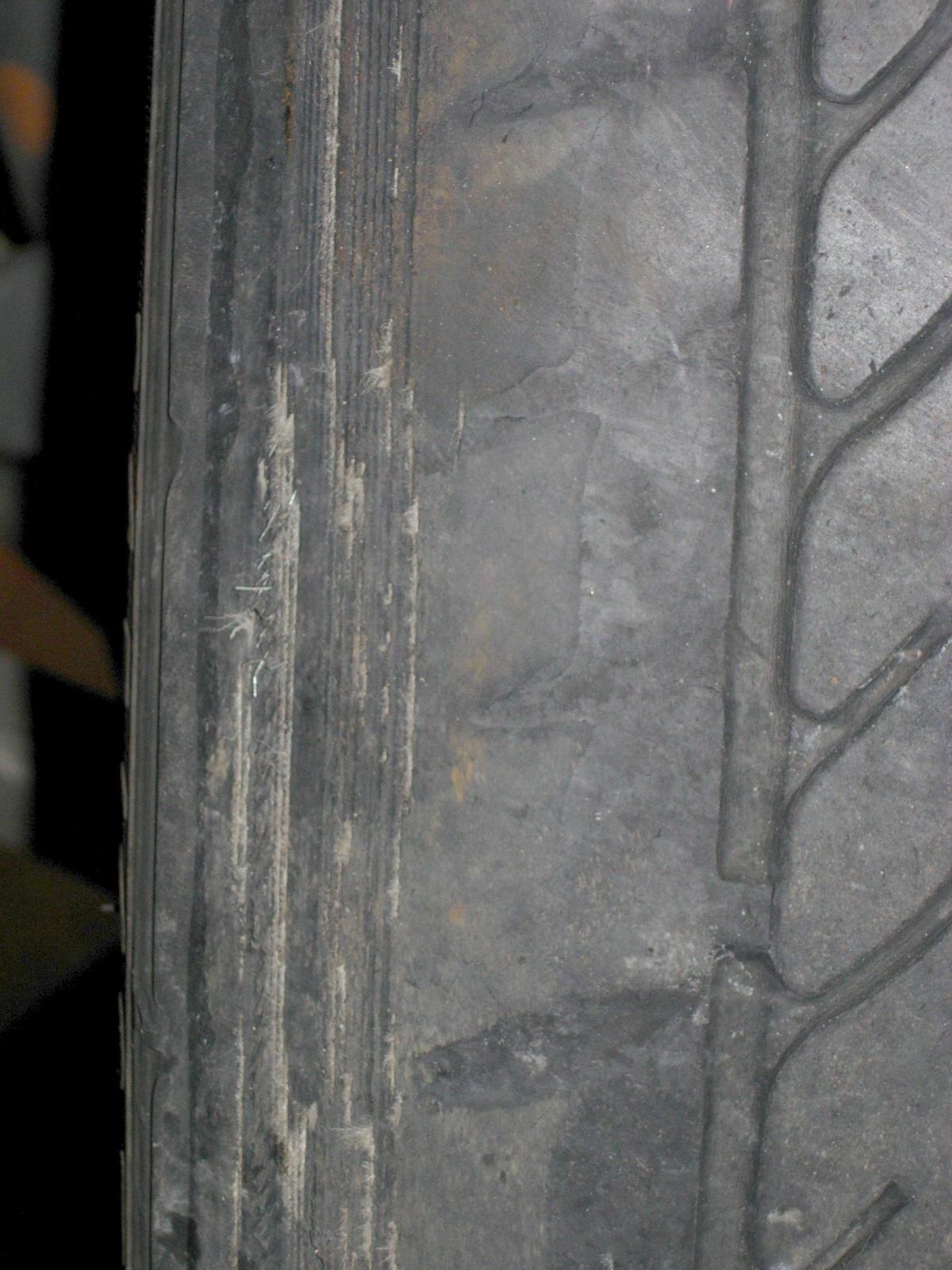

Just purchased a 2012 Octavia VRS estate, an "approved used" car from Westgate Skoda in Grimsby. Initially very impressed with the car. Its a lovely machine. Then during some rough weather the front end let go on a corner (fortunately at only 20mph) which was my clue to get the car looked at pronto. Turns out that the front tyres were dangerously worn - despite all "approved" cars supposedly having a multi-point inspection and a minimum of 4mm tread on each tyre. Take a look at the following (I'm still having sleepless nights thinking about how much worse it could have been!)
https://dl.dropboxusercontent.com/u/62912703/IMAG0260.jpg
Obviously, I should have given the car a more thorough look, but I trusted that dealer had inspected and passed the car. I bought it over the phone and collected it in the evening (no daylight), never got round to going underneath the thing and having a better look around it. I could see there was about 4mm left on the outer edges of the tyres and never thought to look more closely (kicking myself now).

Perhaps on our resident MOT testers can comment on the roadworthiness of a car with that tyre wear.  Would it pass an MOT test?
I doubt it, since you can clearly see the thread through the right hand one.

If the tyres weren't worn through to the cords then they'd be acceptable for a MOT as it appears from the photo that the primary grooves which contain the tread wear indicators are well above the legal limit of 1.6mm,  the other grooves within the centre 75% if not cut as deep as the main grooves are deemed not to provide a meaningful tread depth measurement for the MOT test.  I would still advise that they are worn on the edge, as in my experience they'd soon be down to the cords.
Your tyre on the right is worn through, exposing the cords, on a MOT test I would give it a 'Dangerous' marker along with a fail, the tyre on the left is not as bad, but I can see exposed cord, that'll get the same failure from me.
Unfortunately it's not something that I haven't seen before:
These were front tyres, and indeed the wheel alignment was well out. Both front wheels' camber was 6 degrees or so out. Back wheels also needed adjustment - all of which I had sorted when the new tyres went on (Goodyear Eagle F1 Asymmetric 2's, in case anyone is curious and it's driving beautifully on them). Never mind passing an MOT, if plod had seen them it would have been an instant 6 points (and a severe telling-off no doubt).

That wear can easily occur with incorrect pressures or straddling those square speed humps on a regular basis.

If the tracking is way off it would be easy to scrub that amount off in 1500 miles.
my 1.8 TSi went through a pair of front tyres every 10-11,000 miles and the tracking was spot on.

It was approx. 5 weeks / 1500 miles before the tyres let go and I had them replaced. Vast majority of that was sat crawling along rush-hour A14 and M1 (40-60mph on avg - lots of roadworks on my commute right now), mostly dry weather. No indication there was a problem until I was driving in Derbyshire during a hailstorm(!) The tyre pressures were correct throughout - I usually check them weekly and the car is fitted with pressure sensors which I've tested and they're working fine.
Westgate have told me the front tyres were defective when they performed the inspection, its looking like they weren't replaced for some reason. Mistakes happen, I'm sure it'll be resolved. And yes, I should have checked them myself more thoroughly. Lesson definitely learned there, but that doesn't mean its my fault that the car was sold in a non-roadworthy condition, in breach of "Sale & Supply", Road Traffic Act and the sales contract.

So, a resolution of sorts. The MD of Westgate Skoda contacted me today, told me he didn't believe my "story" and that they had a "paper trail" proving that two brand new Bridgestones went onto the car prior to sale. Its worth noting at this point they asked me to supply photos last week clearly showing the branding etc. on the tyres which came off the car, which I did. Silly me. Draw your own conclusions on that one.
The car definitely did not have brand new front tyres when I collected it - the fronts had about 4mm of tread left where I could see on the outer edges.

Where do they source their tyres from, a specialist outside tyre company or do they supply and fit them in their own workshop?  If the latter, all it proves is that two tyres got booked to that job number and may have ended up anywhere.  It'll be much harder for the tyres to end up somewhere else if the car is taken to an outside company for tyres.
We had 2 brand new tyres fitted one month ago on a 54 plated traffic van and 1300miles later bare canvas on inner third, this was all city work with approx 300miles on a dual carriageway.
Took back to garage and they said tracking was way out the driver did not notice any steering issues just noticed the wear on a weekly check (which he had obviously not done before).
So yes you can easily scrub out a brand new set in the mileage you claim if the tracking is incorrect.
The dealer probably slapped 2 new tyres on but did not bother to check/adjust the tracking as it was simply picked up to have defective tyres by an uneducated person that could not see it was abnormal wear due to an alignment issue.

It might be worth checking the date code on the tyres.
At least that will tell you how old they are.

I'm no MOT tester but I can say for certain that neither tyre would pass the tread inspection, and if they did, they shouldn't do!
The offside tyre is near enough down to the wire on the inner rim, ridiculous!
Quite surprised at how bad they are considering it is only a two year old car.
Tracking could of been wayyyy out of alignment perhaps?
