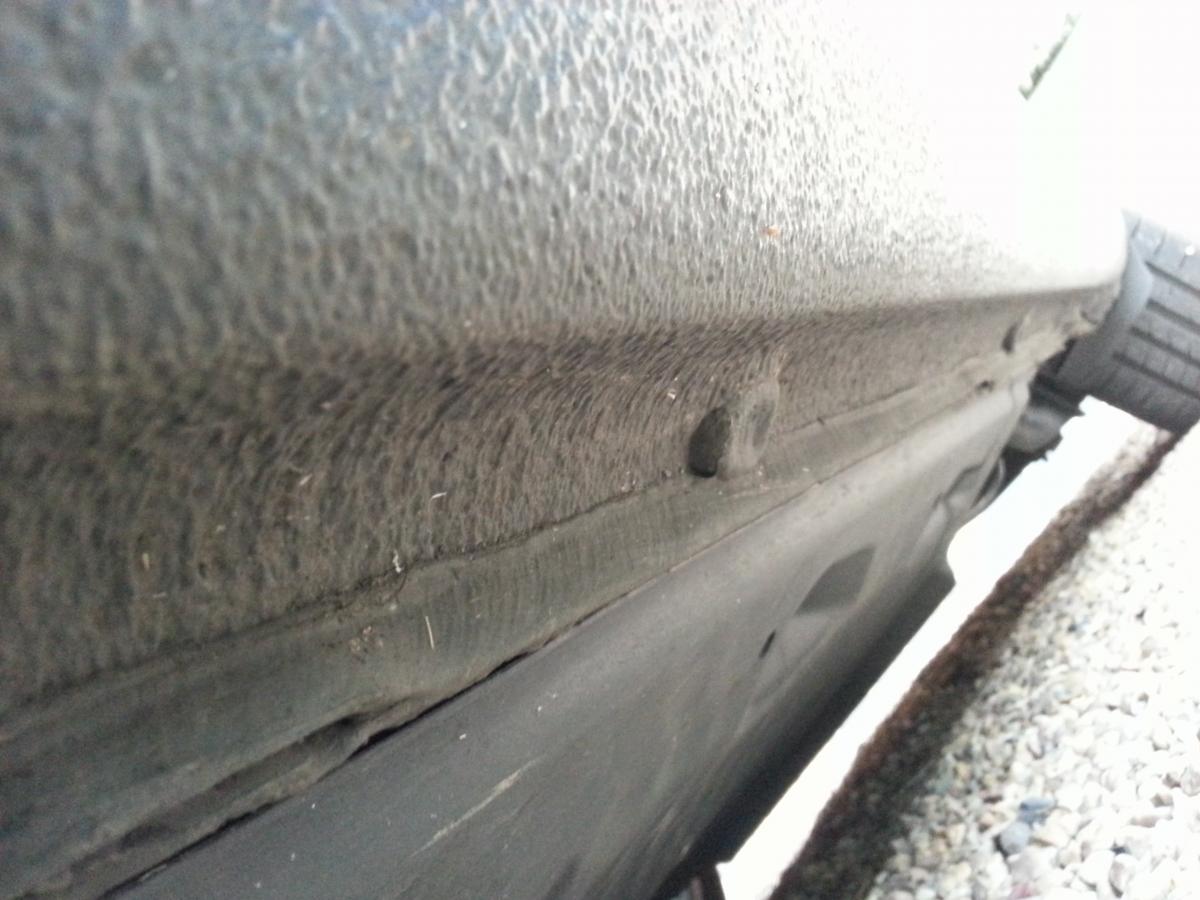

Thanks Steve. Looks like yours are covered but protective treatment is starting to come away.
Can you confirm please?
Seems to have a good covering all over. A piece has come away over the bung, but there seems to be a thinner covering beneath. No corrosion that I can see, but in saying that it is currently raining and laying on the drive looking at the sills is attracting odd looks from the neighbours!
