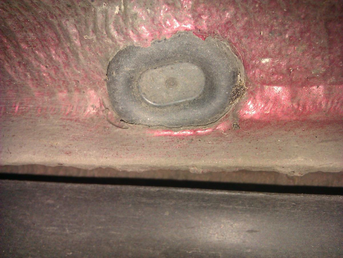

  • I think this settles it.   Here is one of my rubber bungs (through the muck):       As you can see they are completely covered. They all are on both sides.   I think they are meant to be c
  • The bungs are fitted then the underseal is sprayed over them, skip to 6:30 on this video

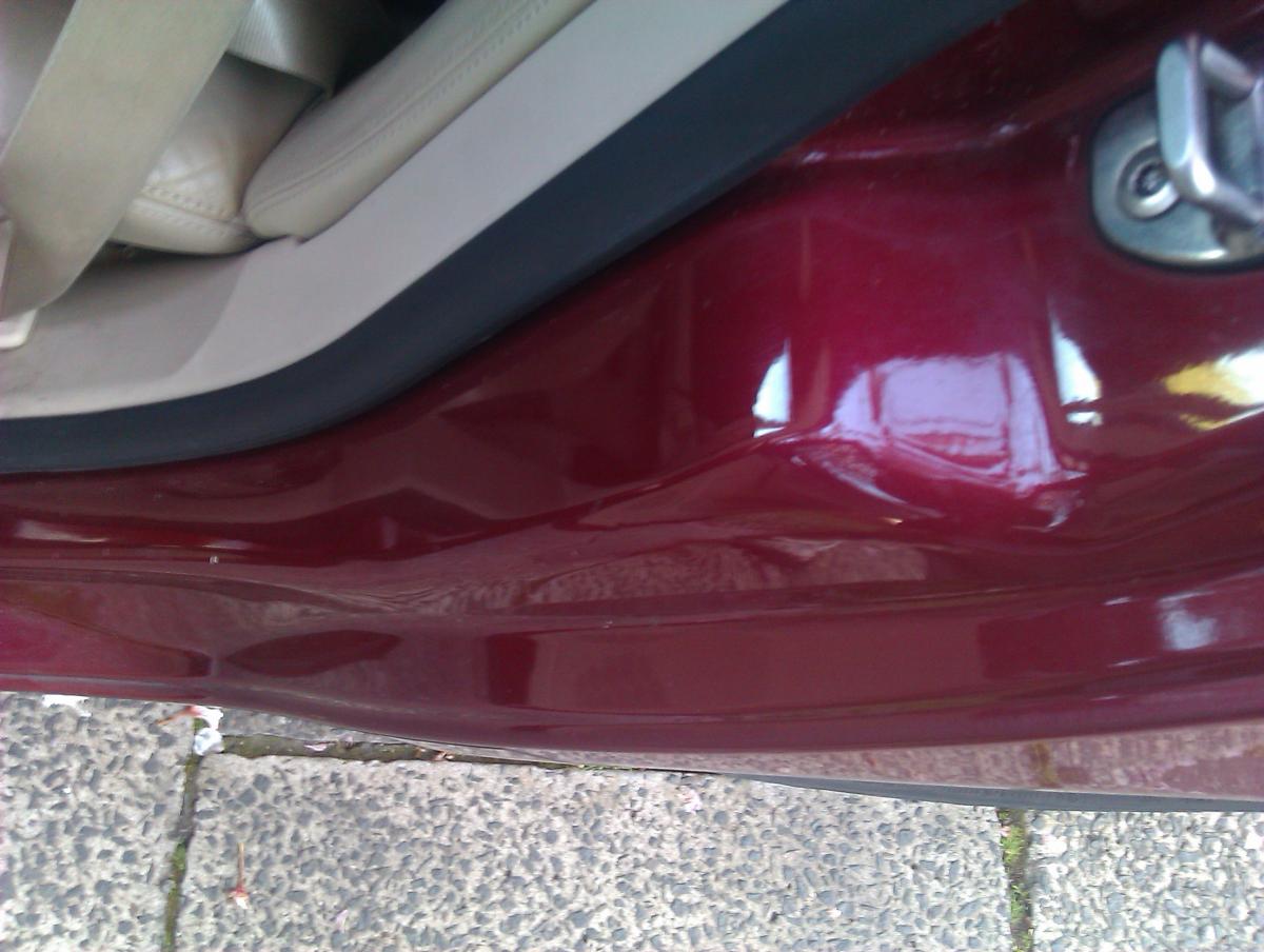

here are some pics of mine I took this evening
That clearly shows squished bungs!

Anyone else got issues with door seals causing lines?
What year vehicle have you got if you have?
Yes my 05 Octy has lines there, very annoying.
