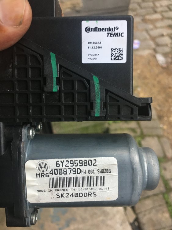

From what I have already read on this forum, I think the problem is probably the window motor/ controller ECU located in the drivers door behind the door card.  It's part munber is 6Y2959802  It possibly has the suffix SK1 after it, but I'm not sure about that.

I've had to luck looking on e bay for a replacement motor either, but thankfully I have a mate who drives a van for a local auto parts supplier. I'll ask him to get me a price for a new one.  I'm not sure if the 6Y2959802 should have the suffix SK1 at the end or not?  Apparently it has something to do with the controller software, not sure if that would be can bus related, that stuff is over my head LOL!! but I think there is a difference between SK1 and SK2.  The motor I have also has SK240DDRS written on the label, but I'm not sure if that means it's SK2.  Probably not!!

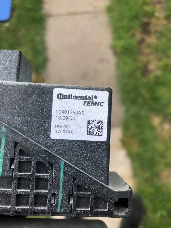

Is this the same motor that everyone needs? (This is my own from my car)

Polluxtroy69 that's the same as mine. Renault must have similar motors as I see you can buy repairs for the Temic circuit.
