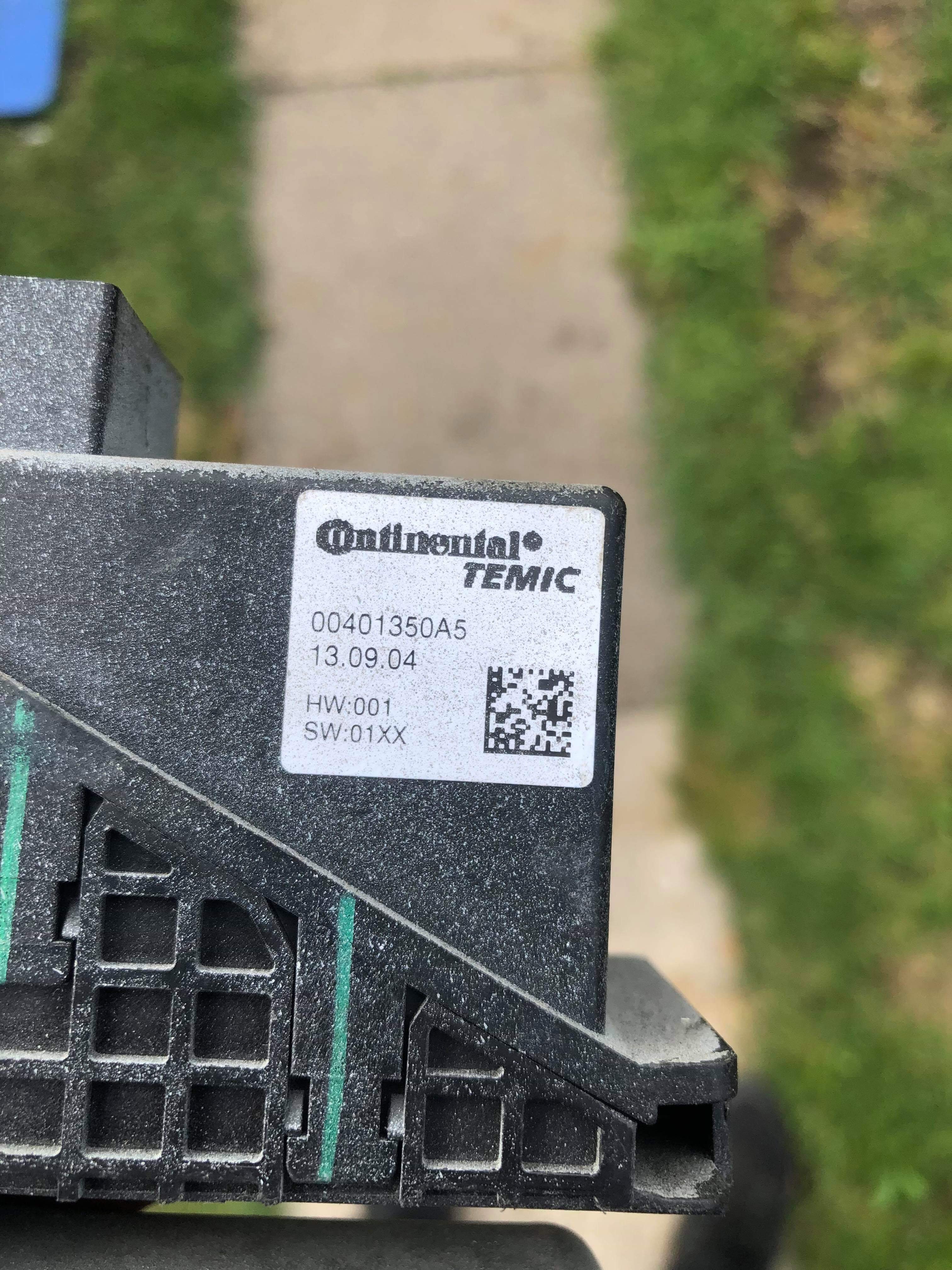

Iv got got same issue issue with my VRS fabia, Windows not working. Had an electrician check over it and he’s stated that the drivers side window motor/module isn’t working.
However been told to replace it with the exact part number which is on the module
mine is 401350A6, I have found a replacement but that’s 00401350A5 again from a fabia vrs - will this work?
First module is mine
second is the replacement used part I can buy
any advice will be appreciated
