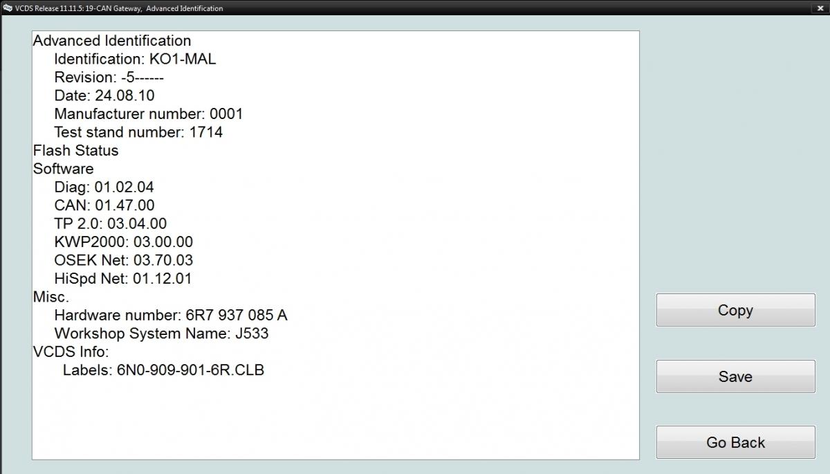

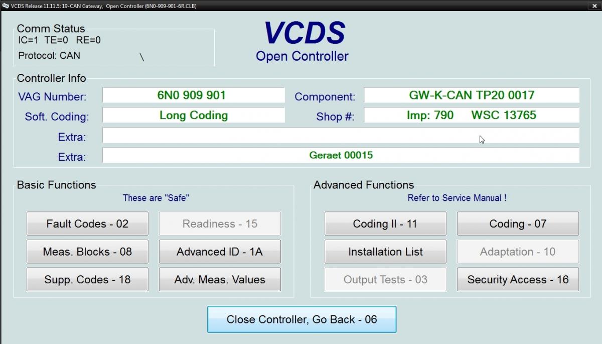

How to get the CAN bus version of my CAN gateway? Is there a way to do it over VCDS? The car is 2010 Fabia Mk2 Facelift. The point is, i want to mount a RCD510 Bolero from Superb, but i'm not sure about the battery drain problem. As far as I've read, there should be no problem with the Mk2 Facelift Fabias but need to be sure.
Screenshots following, if this helps.
Any help or advice would be highly appreciated. Thanks in advance

Hi, RainbowFire, and thanks for the reply. Meanwhile I managed to get the information needed.

fabia uses a built in gateway in address 09 BCM
