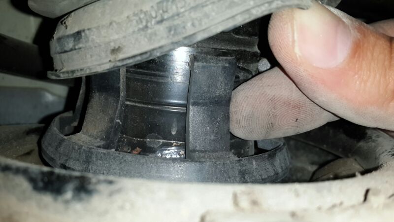

So guys
Us this black part my finger touching is normal part of suspention?
It rotates easily by fingers.
So guys
Is this black part my finger touching is normal part of suspention?
So guys
Yes this is regular part of suspension. Transportation blocks are around pistons, but you can't see them until you lift the car, so the wheels are hanging down.

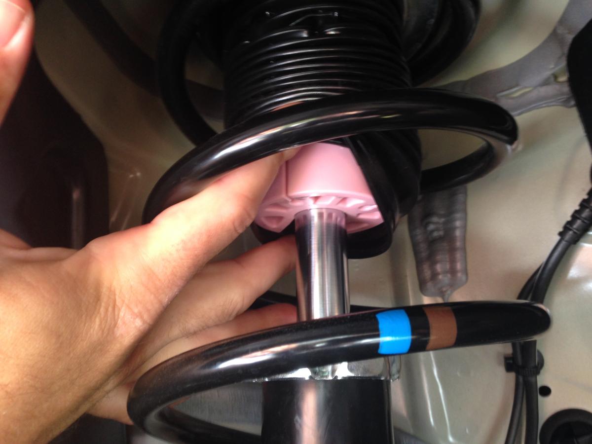

R U sure?  The old transport blocks used to fit on the springs.  The new ones appear to be on the damper shaft - they look like a bumpstop.
..and judging by the pictures on here are nice bright colours so they can be easily spotted at PDI :ph34r:
