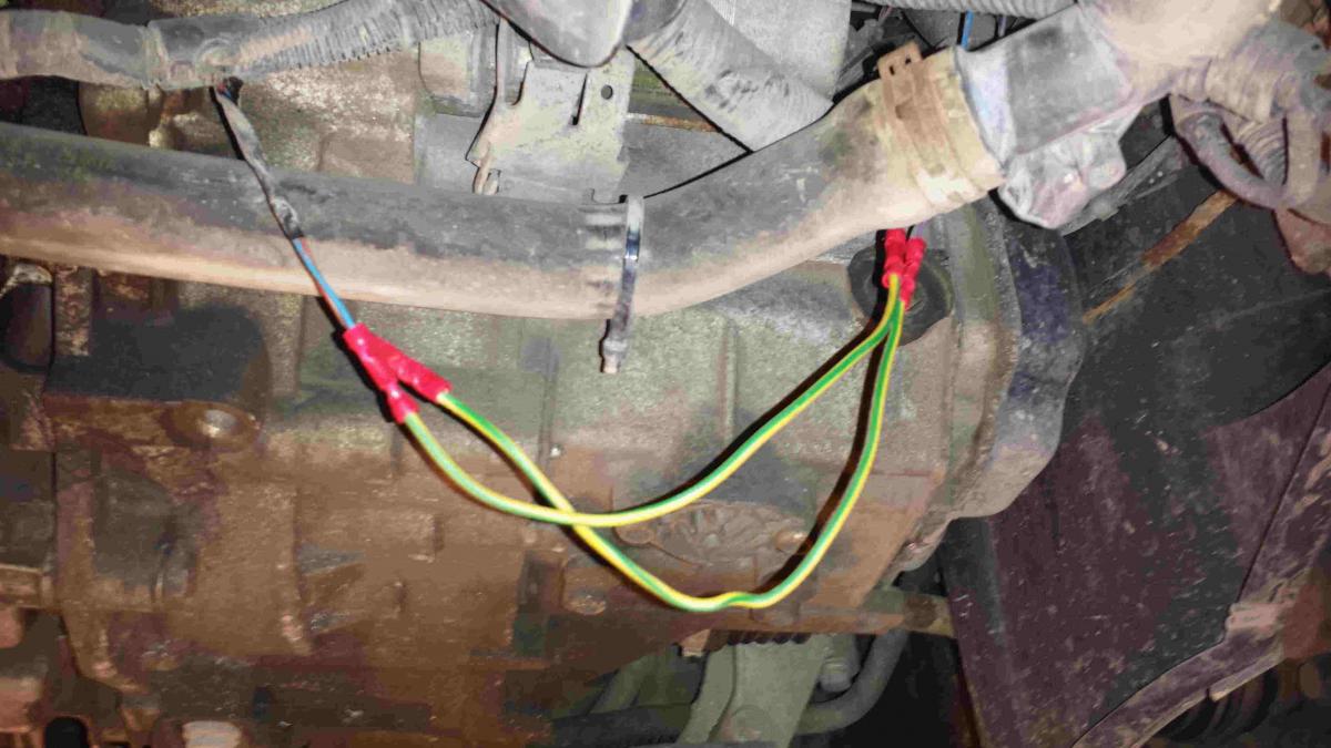

Cable of choice aprox 10-15cm long. (2 leaders)
Something to connect the cabled with (see picture. I don't know the english word)
Some isolating tape.

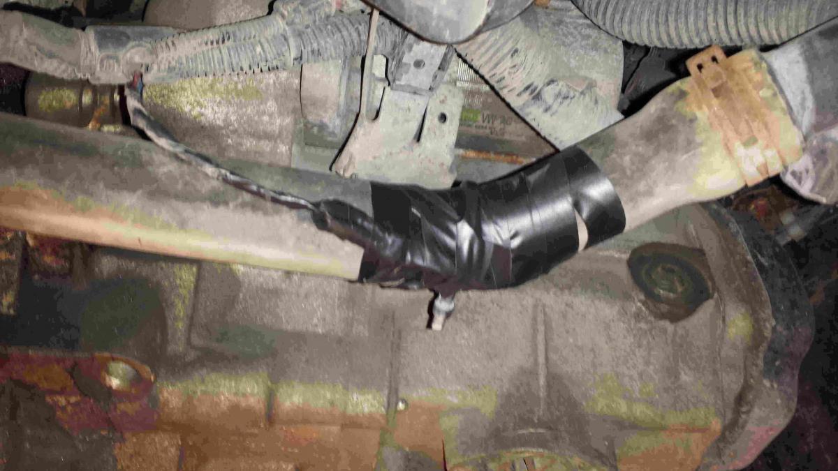

Locate the broken cable. It is located behind the lower part of the radiator. See pic 1.

Remove the connector if the cable ends sticking out are too short to get the new extending cable attached. I had to cut the connector of.

Get your extension cables and connect the cables according to colour. Then make sure the cables are isolated with tape.
