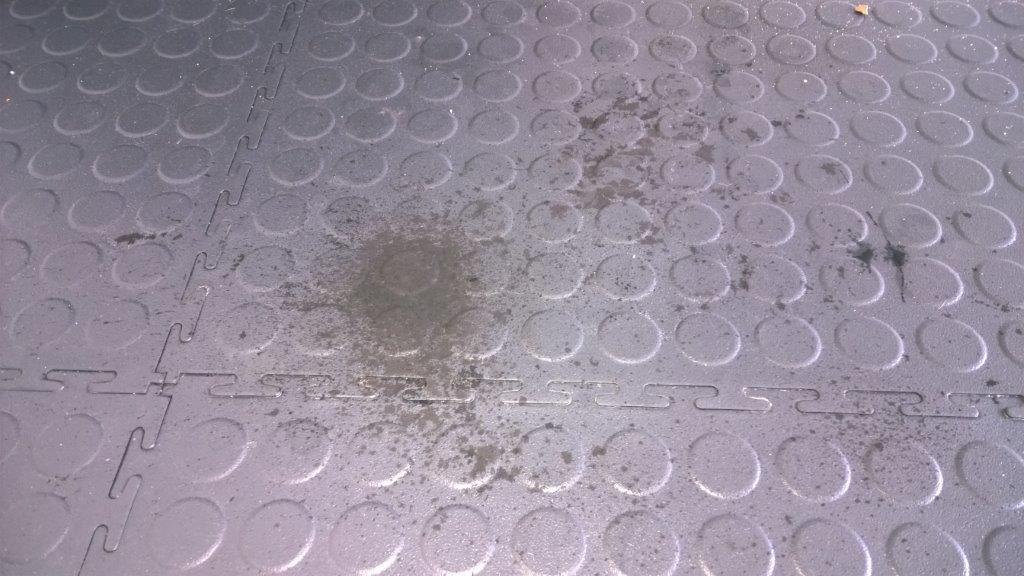

Here it is.. maybe not the best photo.
That's more like condensation that's blown out of the exhaust rather than soot.

I agree.
Either way, none of the other cars I've had over the last few years (since this floor has been down) has left any deposit on the floor  :|

Did any of your other cars have the exhaust end pointing to the ground?

Good point... doesn't look like it when looking at old photos..
Often notice cars driving along in heavy traffic with watery deposits blowing out the exhaust.
You will find that a lot of the time it is worse if you do very short journeys, the exhaust does not warm up enough to clear the condensation that builds up.
Then you will get water sitting in the pipe and next time you start the car the pressure of the exhaust gases pushes out the excess water, along with sooty deposits.
I doubt for one minute that it's running so rich to cause soot. The ECU wouldn't allow it.
