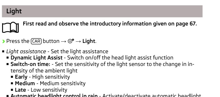

From the manual (amundsen): post-110645-0-46610700-1407445397_thumb.jpg
From the manual (amundsen): image.jpg
Sure this just changes the sensitivity of the light assist and not the high beam assist function. This can just be turned on or off. May be mistaken though.
Looks like it to me, too.
Although I'm sure there have been posts about enabling the headlight assist using VCDS, and also altering the sensitivity...

Sorry I misunderstood the manual.
