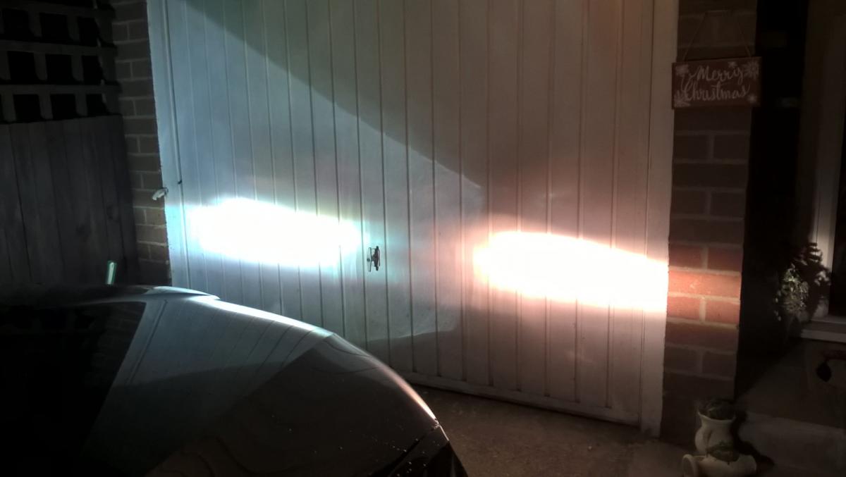

What about the beam pattern? Did you test it on a wall, etc?
Please post some (comparison) pictures if you have, thanks.

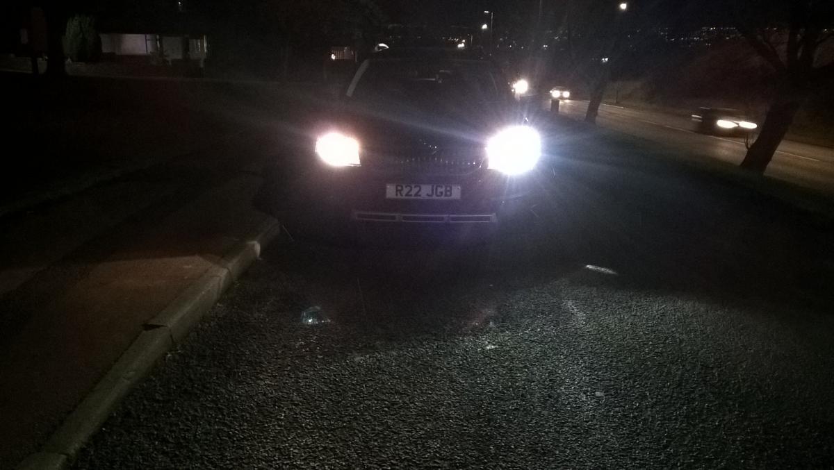

Aki78 here are a couple of pics showing beam pattern, the right hand light still has the Phillips X-treme vision +130 halogen bulb, the left hand light has the HID unit.
So you can see there is no glare head on and the pattern on the garage door shows the beam pattern and the cut off.
I now have fitted both HIDs

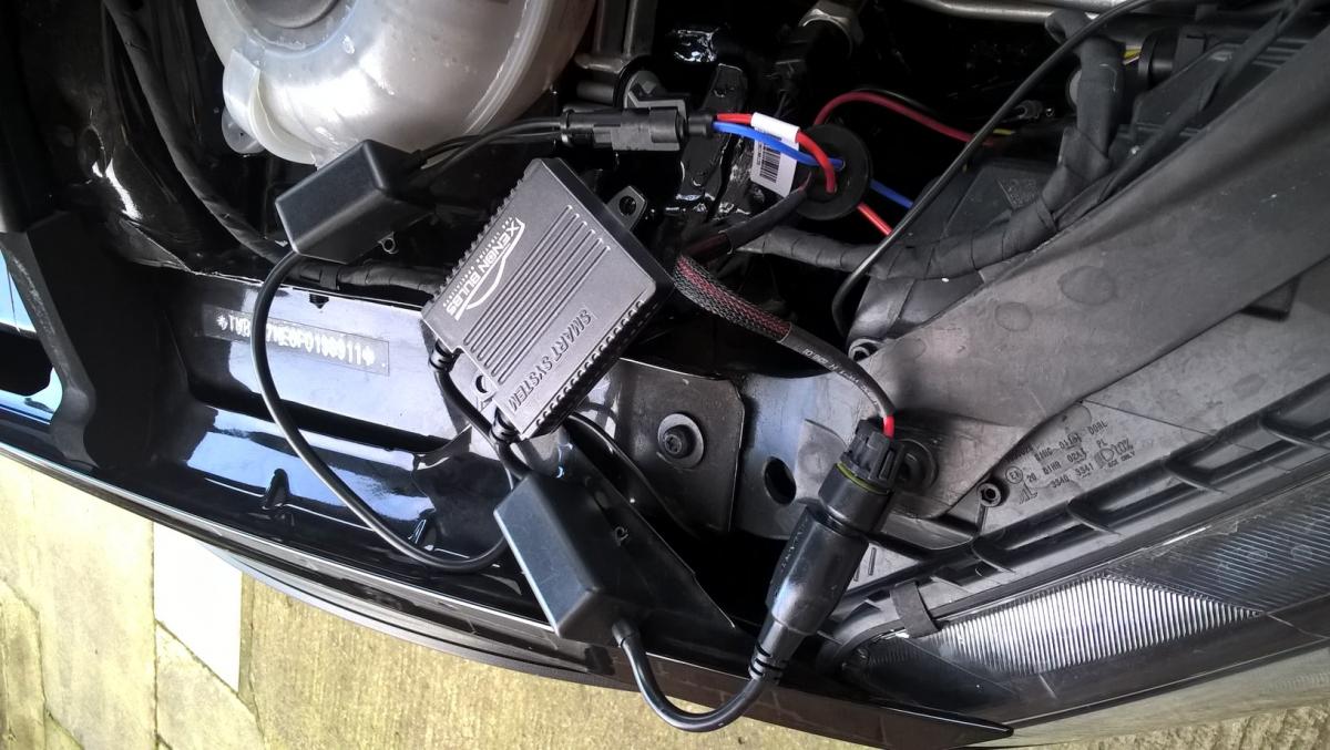

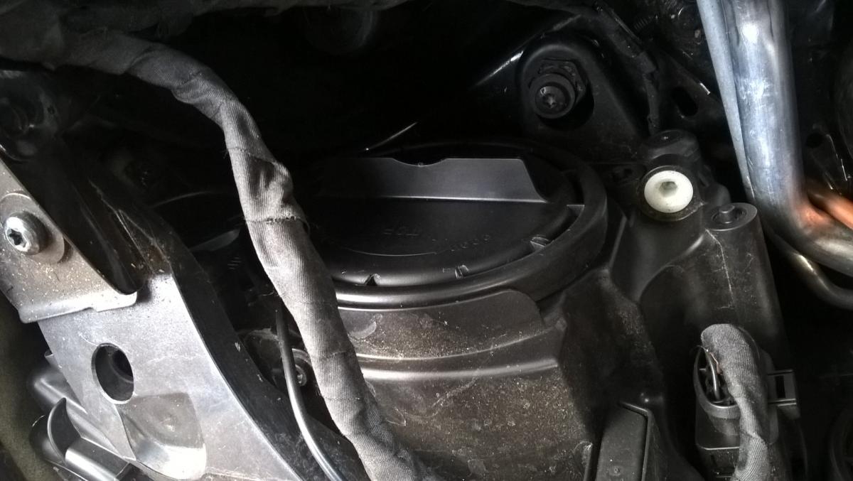

Here are a couple showing the kit and all safely tucked away into the headlamp unit
Thanks. :)

The HID kit I fitted is the same as 1600cr, the beam pattern does not appear distorted and I have yet to have someone flash me.
Close up to the car there is a bit of scatter, see the cut off on my previous picture, stand away from the car and there is no glare.
